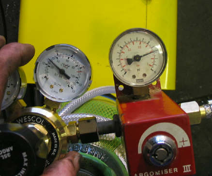

An 'argosaver' basically cuts out the initial surge in gas when you first press the torch trigger, smoothing it out & reducing gas consumption.

Hi folks,
I guess this is where Weldequip tells me off for bolting such a piece of antique rubbish to the nice shiny gear which he sent me a few weeks ago, but when Ratty mentioned that there was an Argomiser on fleabay, I made the mistake of bidding on it.
Since I do a fair bit of tack welding, I was hoping that this gizmo might save some gas, but the problem is that I cannot find any info on how it should be installed so have guessed that it goes in series with the normal regulator.
The fact that the company from which I've rented a bottle on an annual basis for over 10 years admitted recently that their 5 year rental option would have been cheaper has given me an extra incentive, mind you.
Of course it blooming would, if they'd offered it 10 years ago...
There's also the small problem of not having a key for the thing, but maybe Ratty could help out with a description.
Unless it's thumbs down from t'he man who knows', when it will go into the junk box.
Ken.
