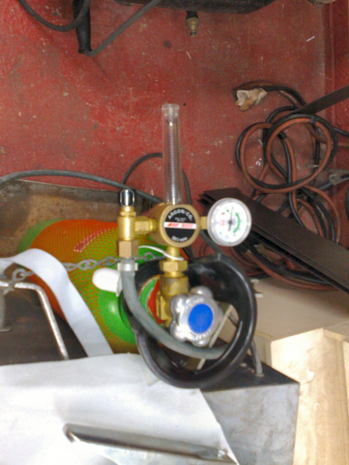

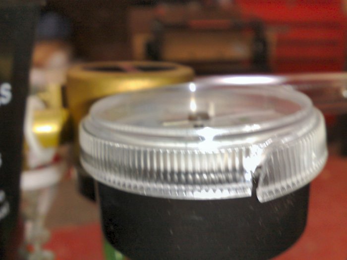

I'll see if I can sort you out with a replacement glass, we normally have a few old regulaors knocking about that have been scrapped after their BCGA inspections that I could take a glass from
It is very unlikely that replacement gauge windows for this type of cheap gauge will be available. Problem is that the gauge is so cheap that replacement of the entire gauge is what the manufacturers intend in the event of breakage or failure. The higher quality gauges with glass windows are expensive enough to warrant spares availability.

Cheap.......I seem to think the ones in the photo are around the £75.00 mark from Gas and Gear centres
What , the actual gauge ??
