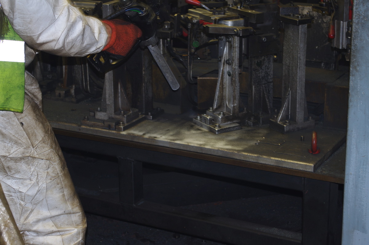

We used to have a company in that used to blast CO2 pellets at our welding fixtures to remove all the built up weld spatter, they almost looked new when finished.That's an interesting idea. Might work too. Part of the commissioning process for the JWST mirrors was to blast the fine gold coated surface with frozen CO2. One of the most precise surfaces it is possible to produce. While CO2 might not do anything to those gauge blocks, something like bicarbonate of soda (coarse crystal) might shift the rust without damaging the lapped surfaces.
