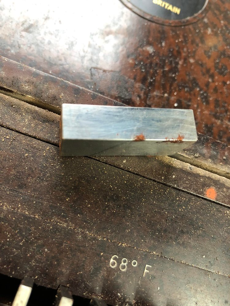

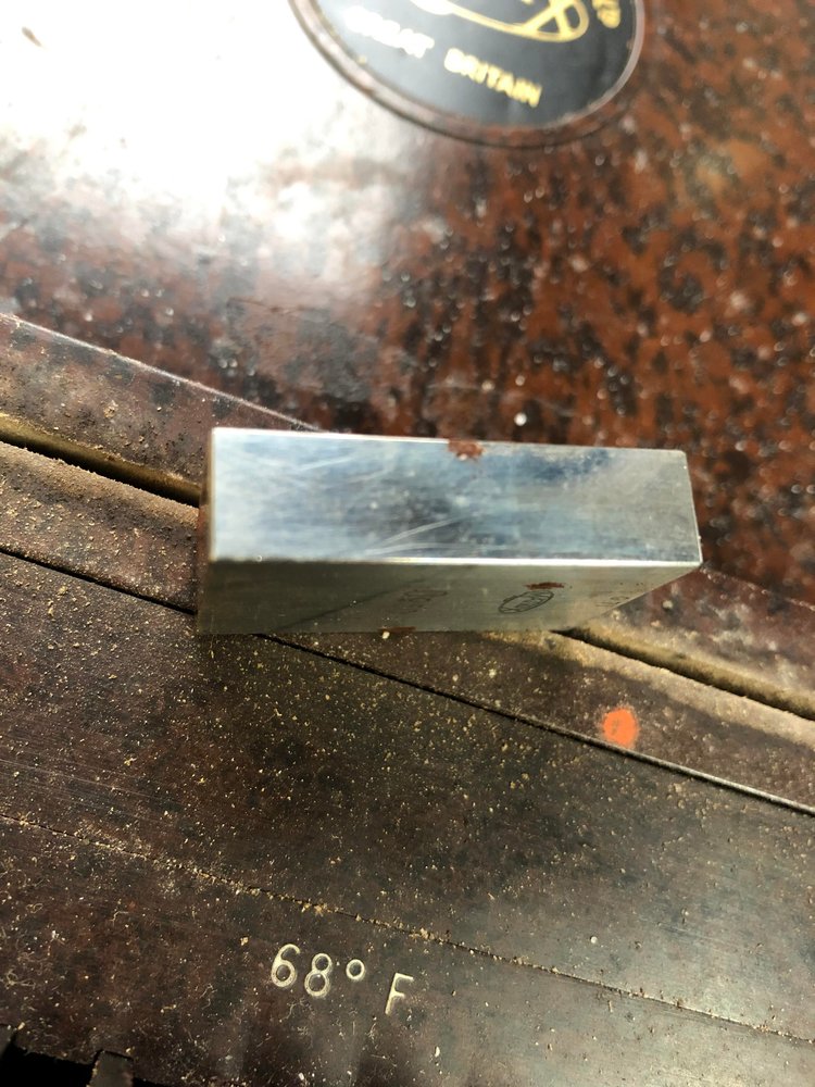

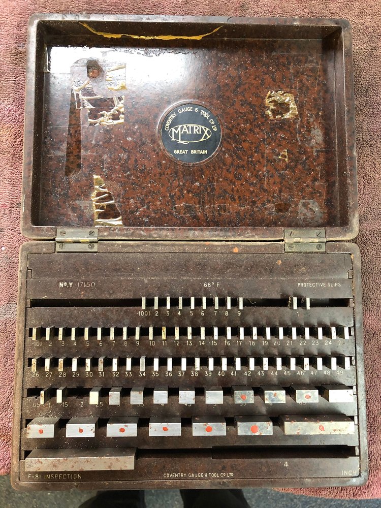

I was thinking something chemical rather than mechanical. I'll give citric acid a try.I'd try citric acid rather than an abrasive. Don't think it will ruin the surface finish but don't hold me responsible if it does.![]()
I guess what this formulation contains Ethylenediaminetetraacetic acid (EDTA).More of a question than a suggestion, but how about Evapo-Rust?
It's non corrosive and (AFAIK) only works on the iron oxide.
Don't put Citric acid anywhere near a gauge block.
A ground flat stone or gauge block stone would be best.
