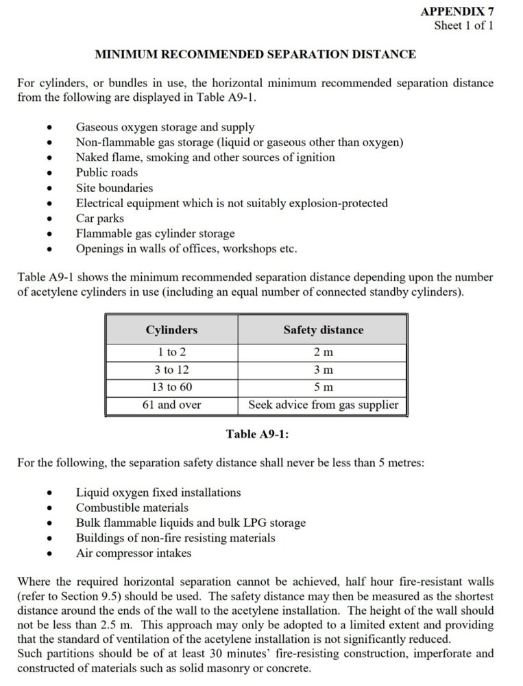

So your set-up is not too bad, seen it done in many places (mine included).I have inherited a new area. I have mig with argon being worked next to oxi propane cylinder and torch. Is this not dangerous? Thanks
