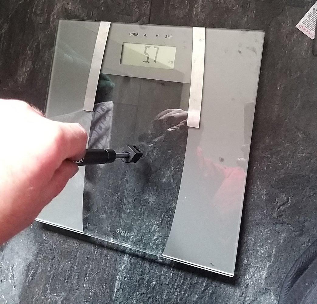

Afternoon all, question to see if my methodology is correct.
The gas stru has failed on my tool chest. Unfortunately there isn't a force rating on it. So using the other good one I pressed it against the bathroom scales and it displays 6.7 kg.
Now am I correct in thinking this would be around 66 newtons (6.7×9.81) According to an online calculator 1 kg is 9.81 Newtons.
Or is the formula more complex to factor in distance too?

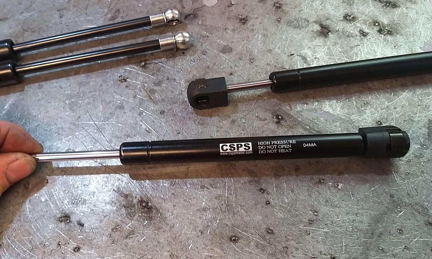

This is the strut

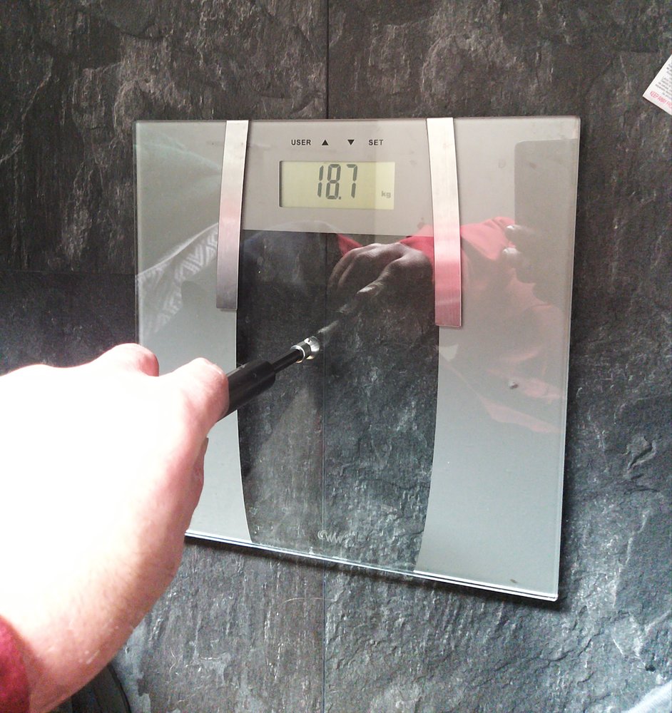

I ordered a pair off Ebay rated at 100N but they are way too strong. I put them on the scales and they displayed 18.7 KG
So is my crude measurement technique wrong by mile or are the new struts out of spec. They were only 14 quid for a pair delivered and 100N was the lowest rating available so I took a chance.
If.my calculations are correct then these new struts are actually over 180N
Old strut on scales
New strut on scales
Thoughts please...
