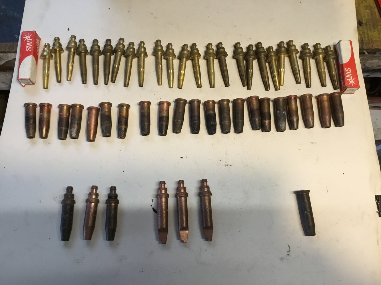

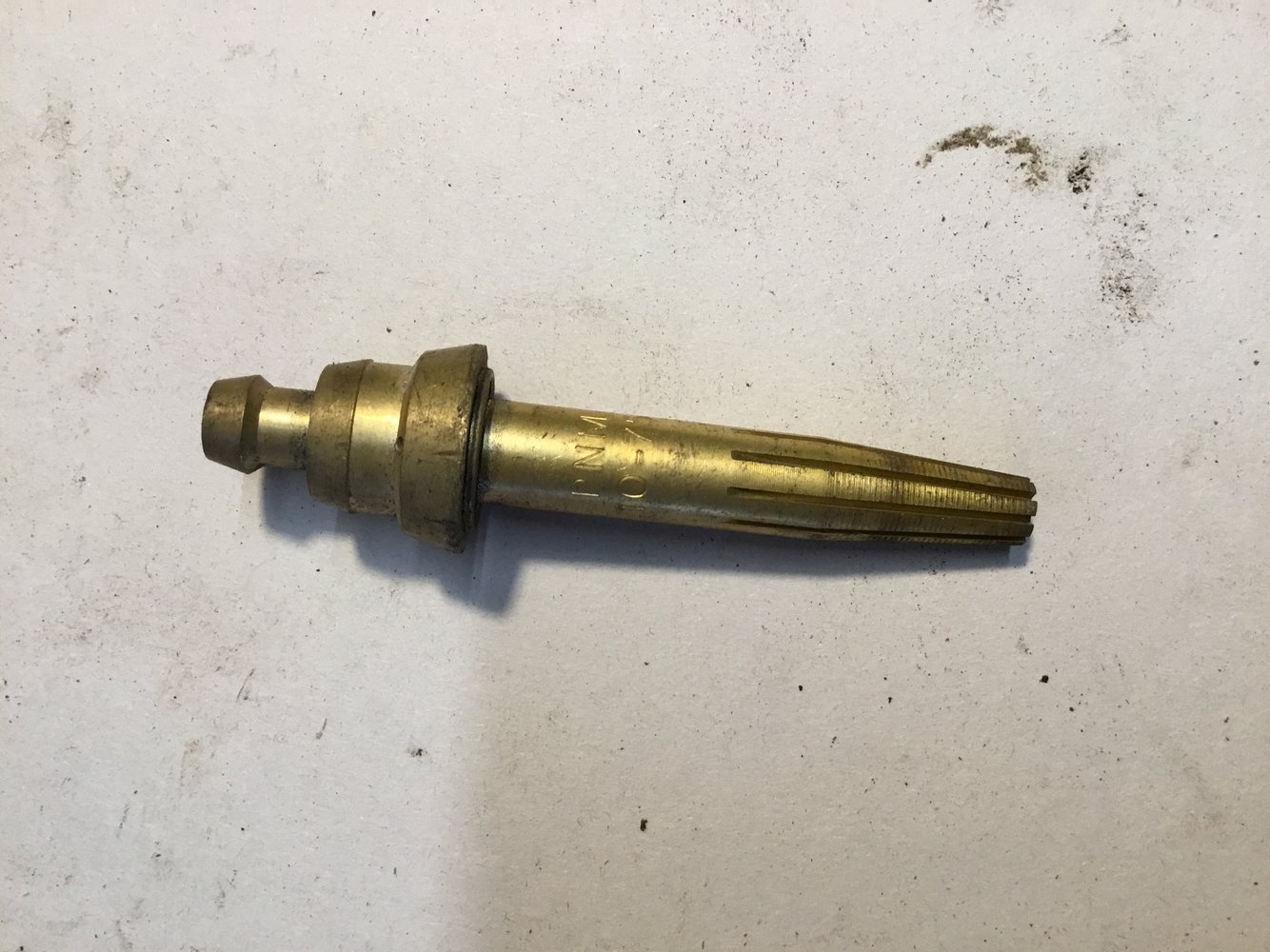

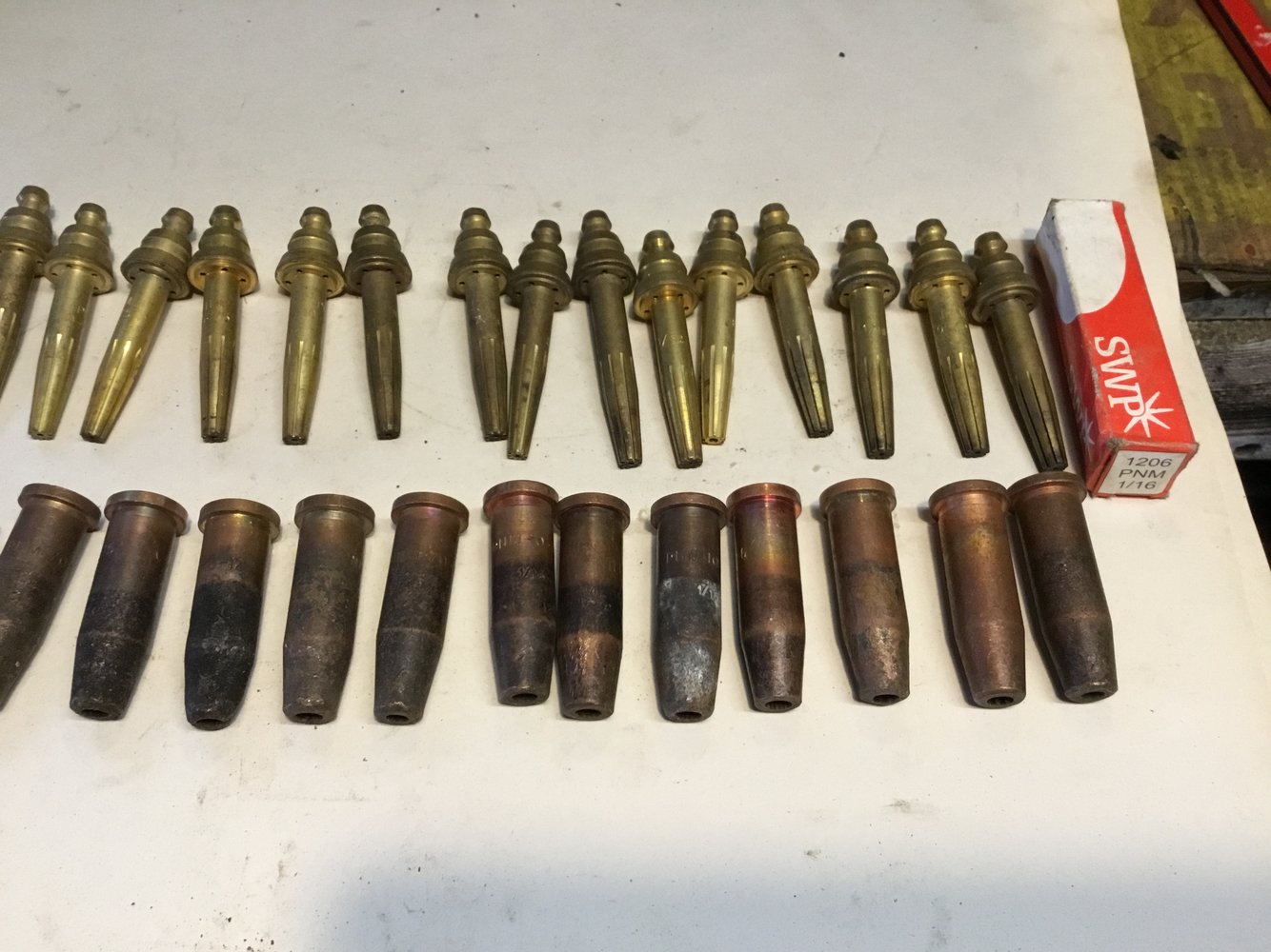

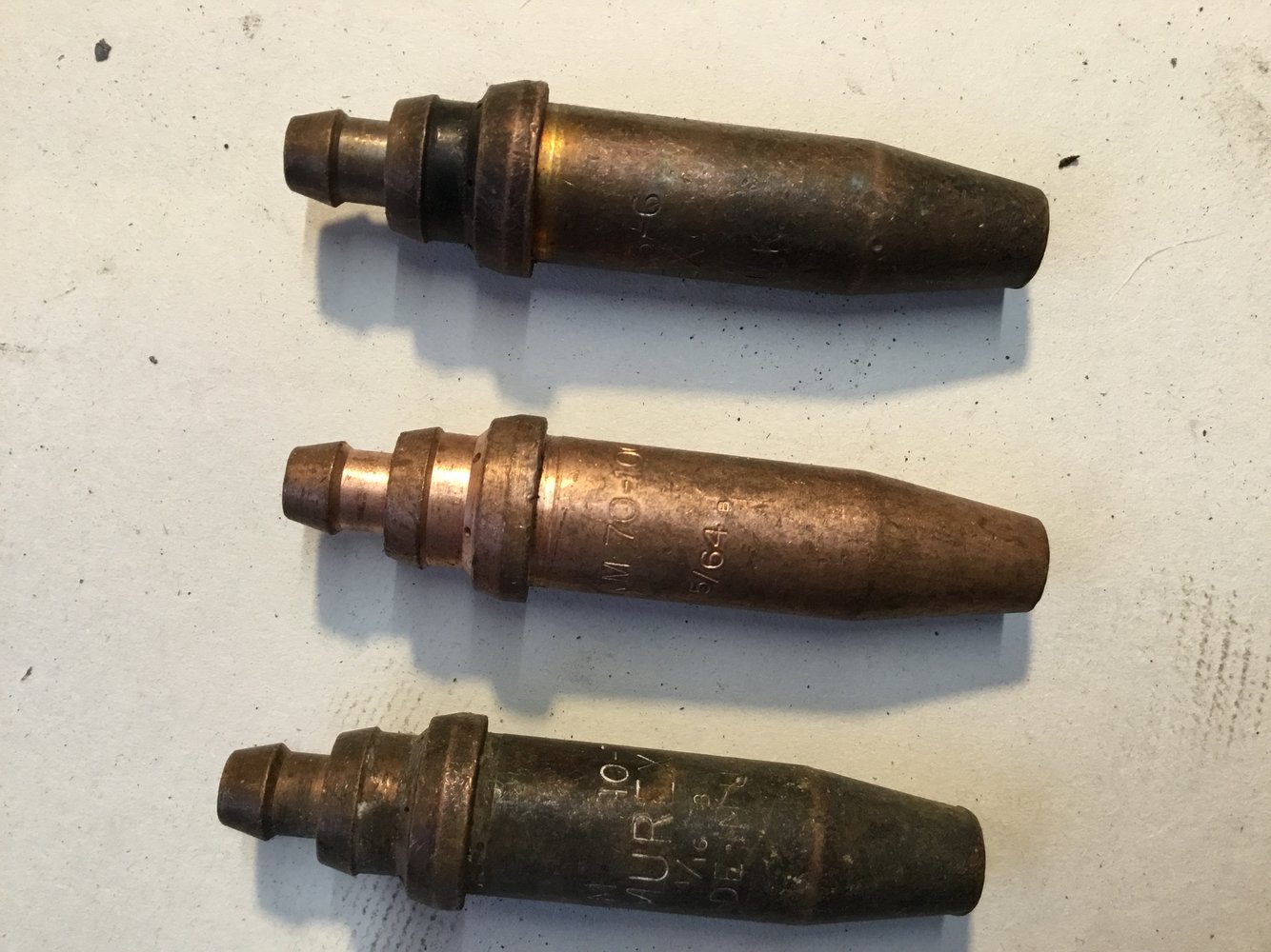

T Twogees New Member Messages 4 Location Glasgow, Uk Feb 18, 2022 #1 Hi does anyone know what these are? I suspect they are mig nozzles but look much bigger and more sophisticated than mine. They came in a package of tools I inherited recently thanks. George

James1979 Member Messages 8,438 Location Orkney Feb 18, 2022 #2 Hi George Welcome Propane cutting nozzles The bottom row are cutting (left 3) and gouging nozzles (right 3) for acetylene.

Paul. Moderator Messages 7,052 Location Northampton. UK Feb 18, 2022 #3 James1979 said: gouging nozzles (right 3) for acetylene. Click to expand... They are acetylene sheet metal nozzles, as said the 2 part nozzles are propane cutting nozzles Nozzles are often marked, PNM (propane nozzle mixing) and ANM (acetylene nozzle mixing)
