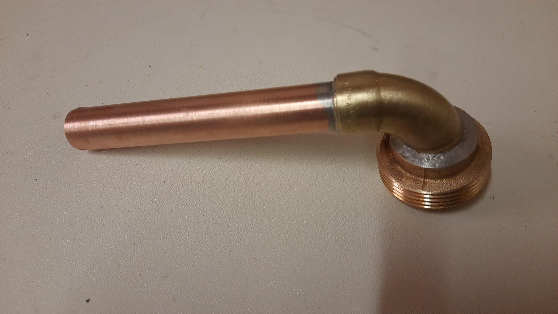

There is no meter fitted that's why i need to adapt to test, i would never fiddle a meter, im more of a politician in life so i get someone else to pay the gas bill![]()

15mm str, Yorkshire manual air vent and screw a test point inYes its new pipe work but it runs under a floor i want to finish off and not have to worry about any issues, I think the problem is sorted after raiding my mates van and looking through some of my old fittings boxes where i had random stuff from over 30 years back, i found a brass fitting with the correct thread to go into the gas out connection and the hole up the middle of it is a good fit for a brass 15mm elbow that was for brazed oxygen lines.. the result

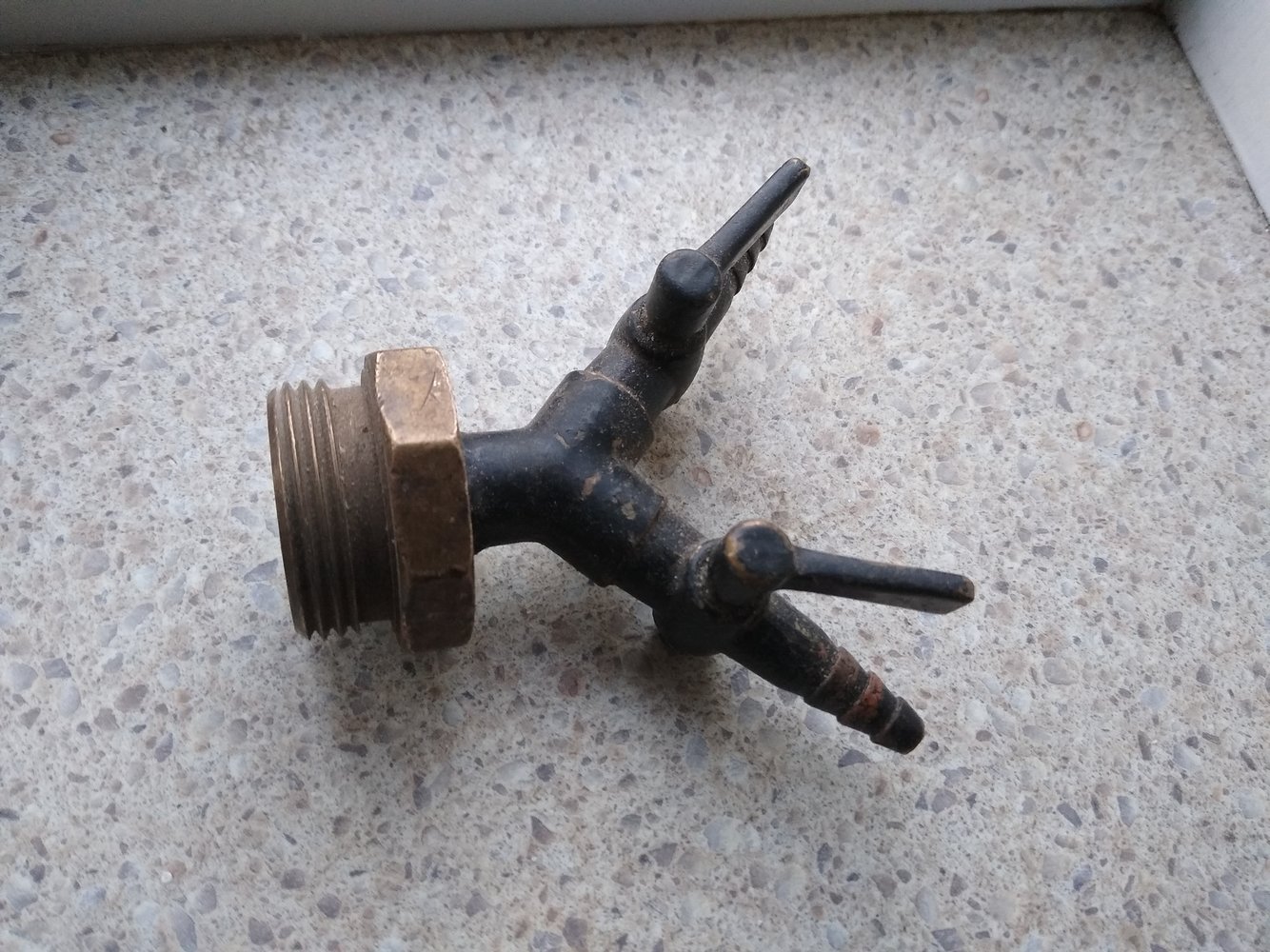

I picked up a test kit as mentioned by @gaz1 so should be good to try.
