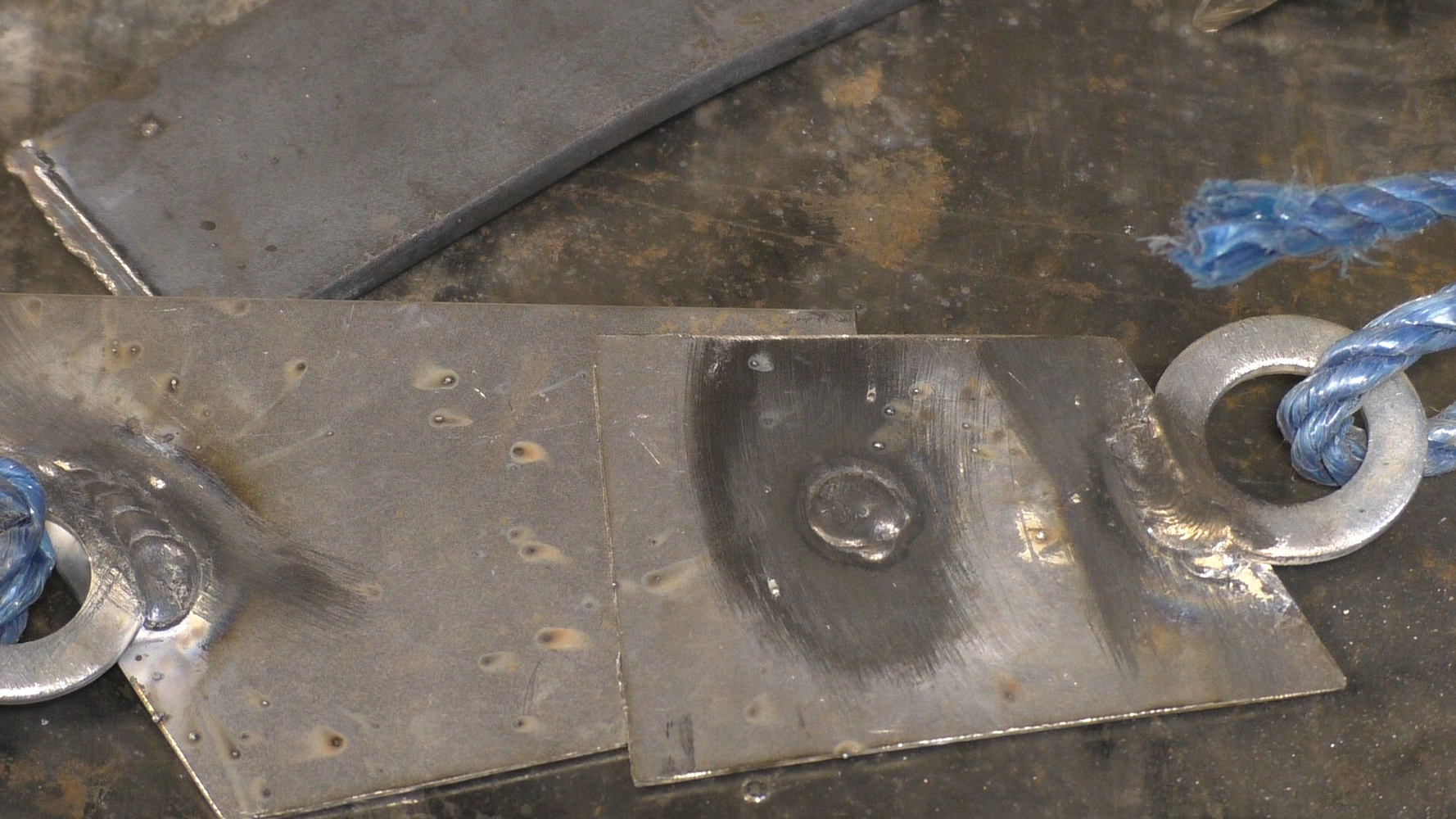

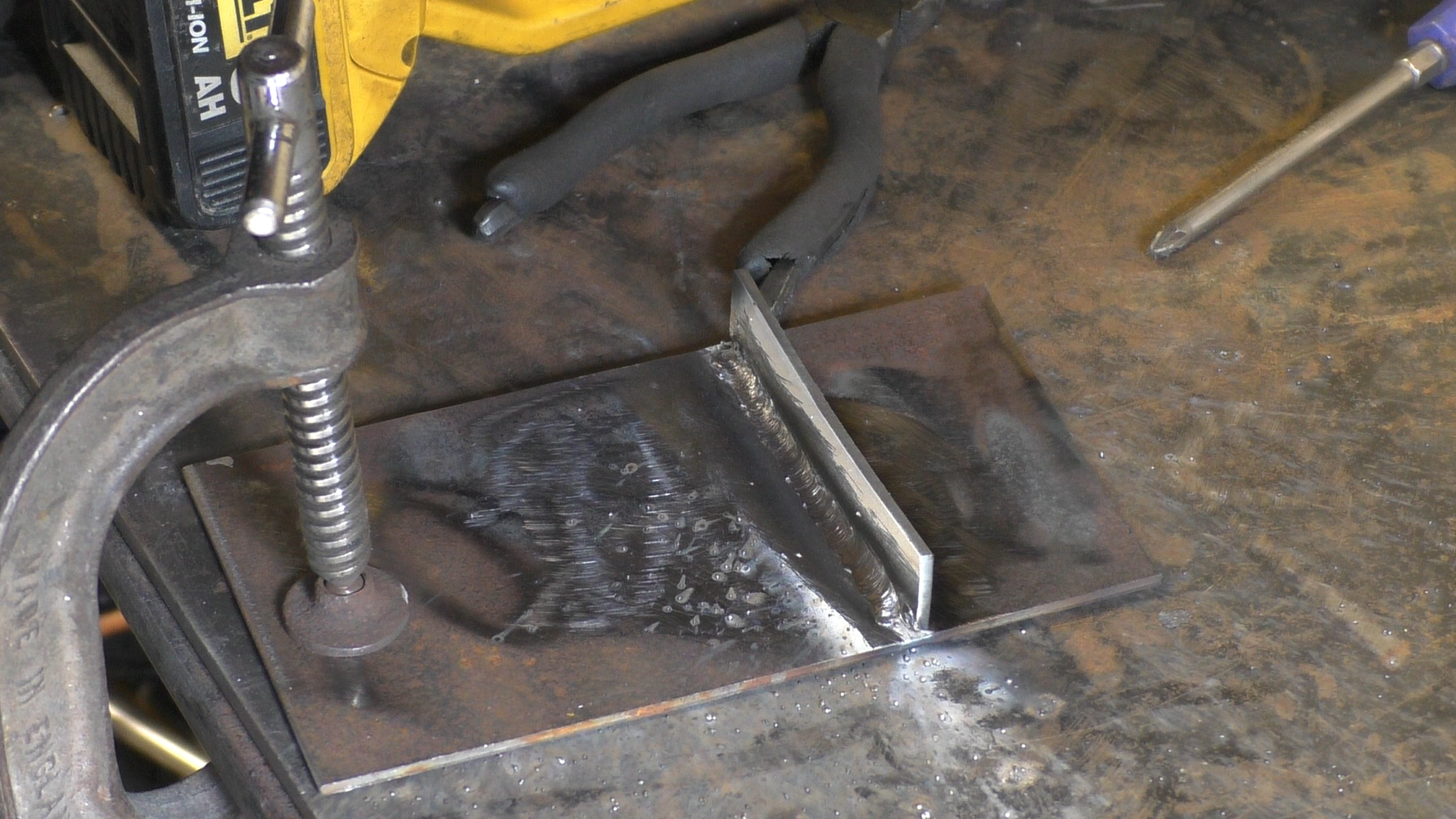

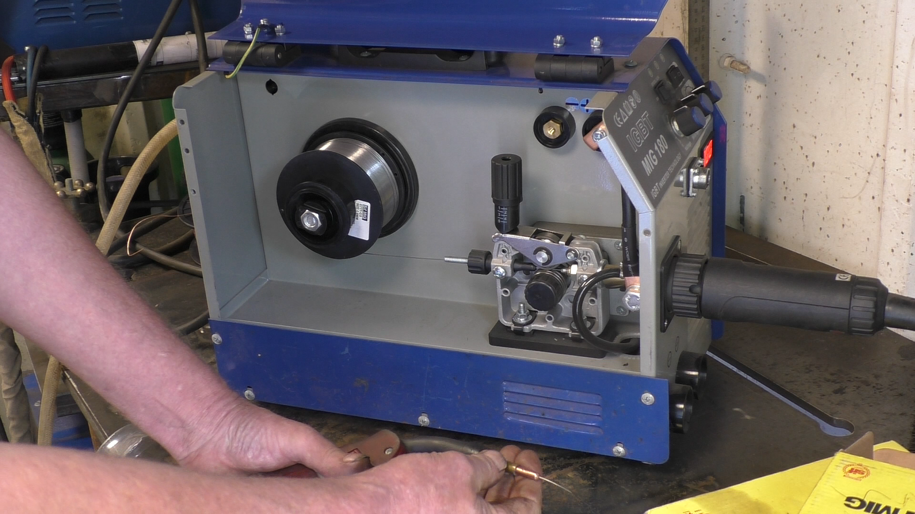

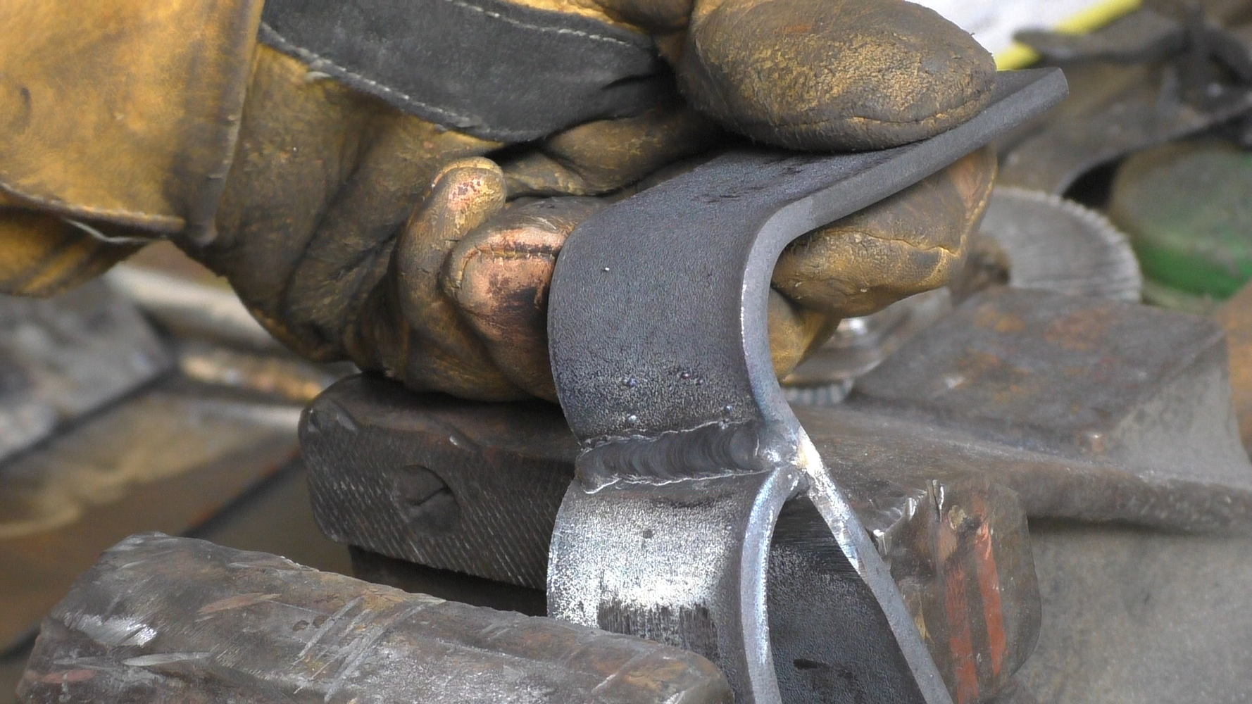

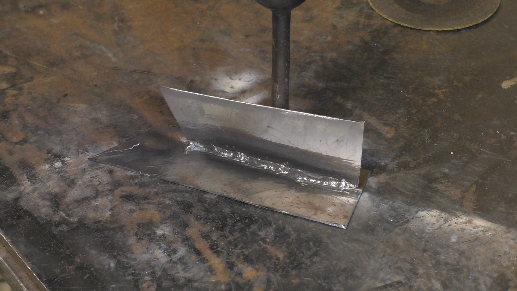

Looks alright.Been doing some video for R Tech on flux core.
I was very pleasantly surprised by the results.
All I have ever herd is bad things about small MIG sets on flux core
View attachment 313950 View attachment 313951 View attachment 313952 View attachment 313953 View attachment 313954 View attachment 313955

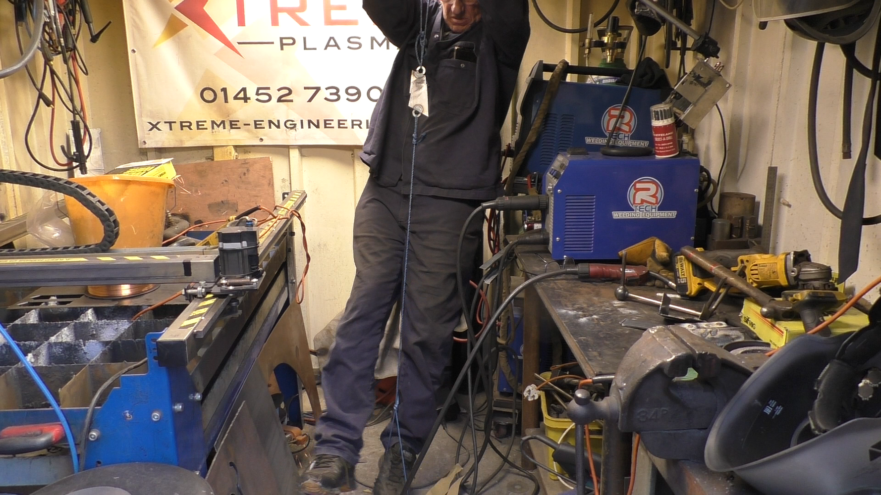

There's a French expression which goes 'a tidy workshop, is a workshop where nothing is done.'I see youv'e had a tidy up
Looks alright.
The make of wire is the key.
Super6 is cheap, but the variability will have you tearing your hair out.
Good makes, like Lincoln, etc aren't really much more expensive - especially when you consider the absence of hair-tearing.

I'm the most productive person in the world, by that metric.Looks alright.
I must get nothing done at all then I can't abide clutter.There's a French expression which goes 'a tidy workshop, is a workshop where nothing is done.'

However, when you have fluxcore running right, it's in a spray transfer, which is useless for very thin metal anyways.
Fluxcore can never replace solid wire and gas, it's just too different. Short-circuit MIG is an inherently colder process which is why it's great for thin sheet metal.
Not all fluxcore welding is in spray mode, some fluxcore wire is designed for short circuit transfer (and some for globular).
Still, as you say, most of the design goals of flux cored wires don't apply to bodywork. For that matter, on new cars, solid wires aren't used so much either.
