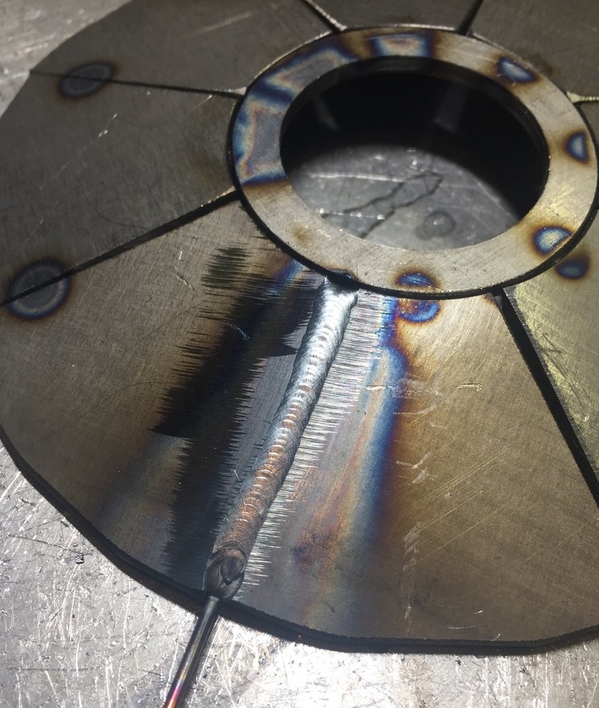

I did try that but it was too much and ran away from me.Not bad at all. You could up the amps some and travel faster - it will waste less heat and give a cleaner weld. But it's really not far off.

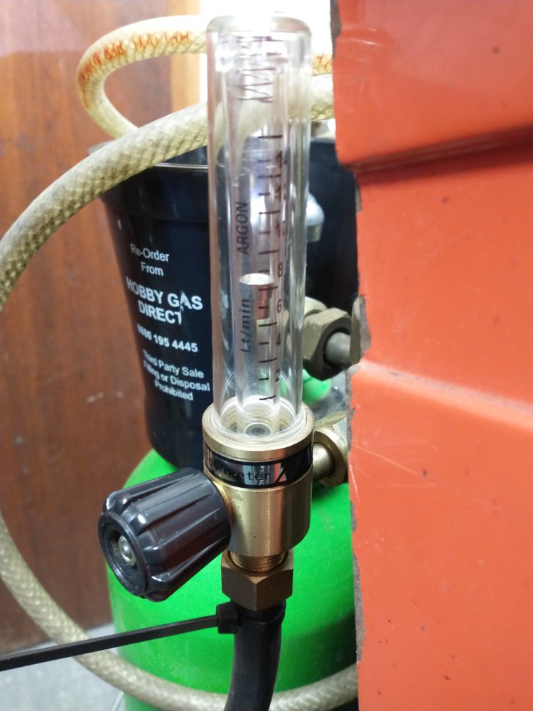

Ah good thanks I thought it was a bit dark.I think you want more gas flow - make the top of the float sit flush with the 9 position, and see if that improves shielding at all.
