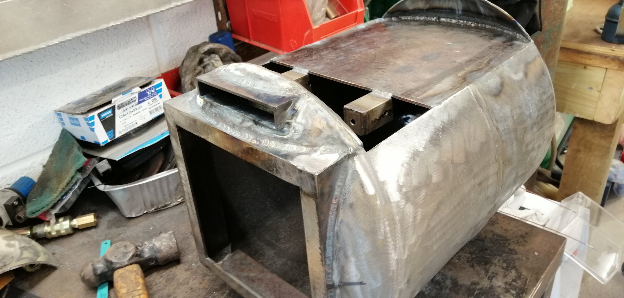

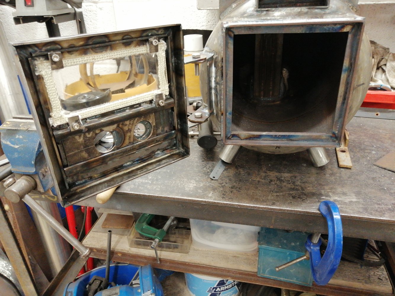

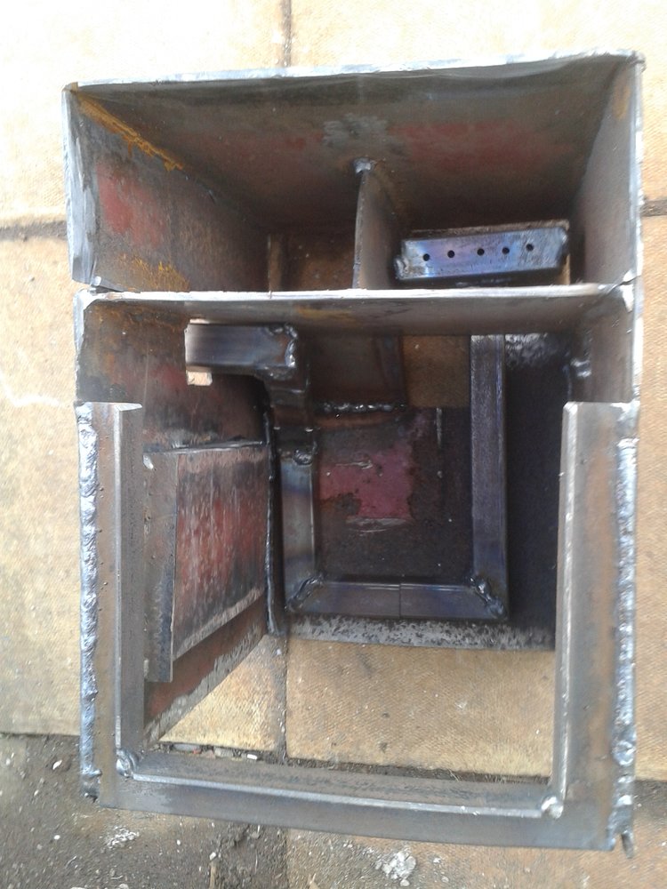

If that was a stick welder under your nice tigSorry, I missed this post. I see what you mean. Maybe I could try to run some weld from the underside? Otherwise I suppose I'd need to re do it?
well you have to cut your bottom open anyway so you can install an ash tray underneath so will give you better access to weld up thereIf that was a stick welder under your nice tig, you could run some stitches under the top plate, as that is the most likely part to distort.

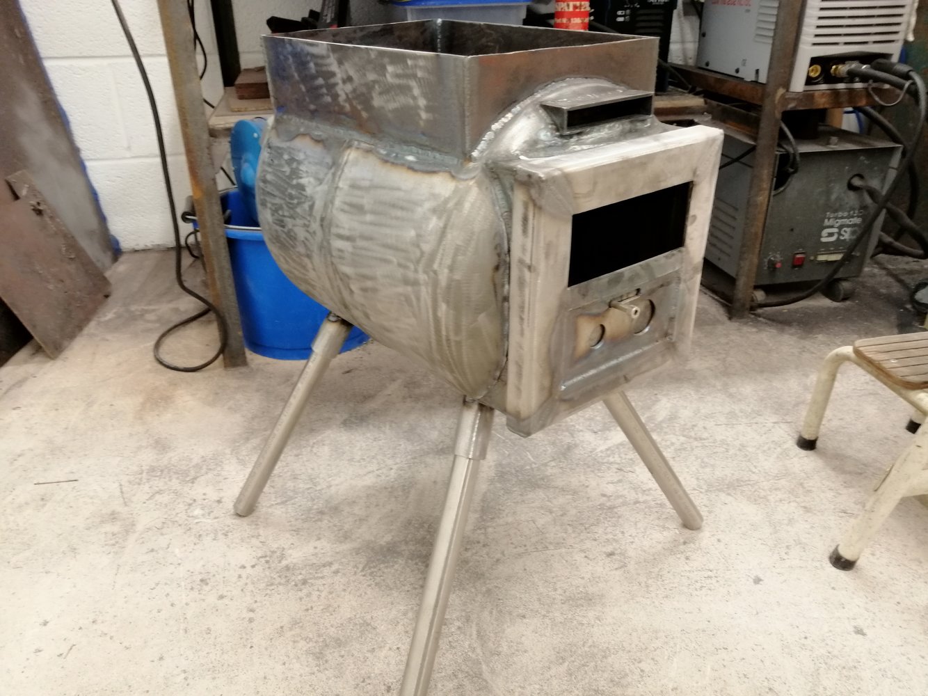

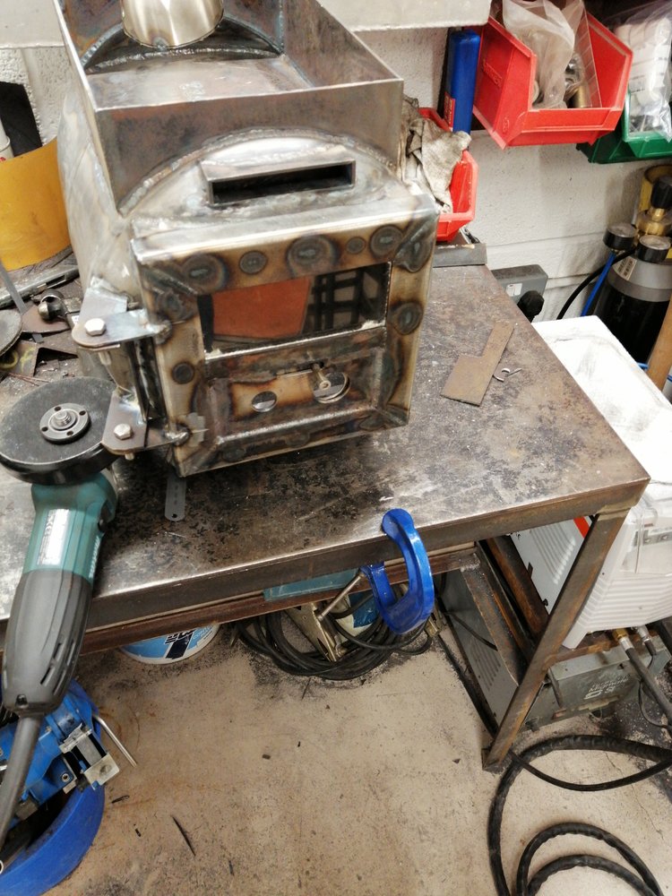

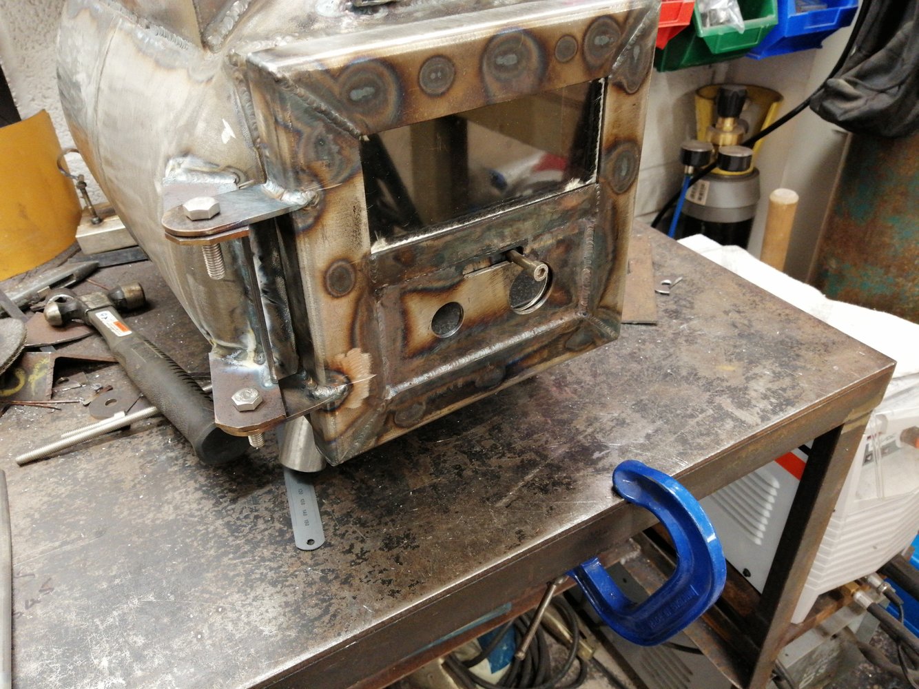

Thank you, I am looking forward to it too! I have been dragging my heels somewhat!!Well it definitely has a "look" to it. Nice work. I like the proportions.
Looks like you also installed some stove tech too. Can't wait to see it fire up.![]()
