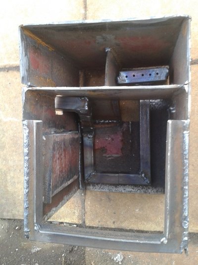

The head of a coach bolt or roofing bolt can be handy in door catches. You can use the thread to adjust the tightness and the radius of the bolt head gives a nice action if it slides across a chamfered edge onto a flat. Easy to replace if it wears out too.
