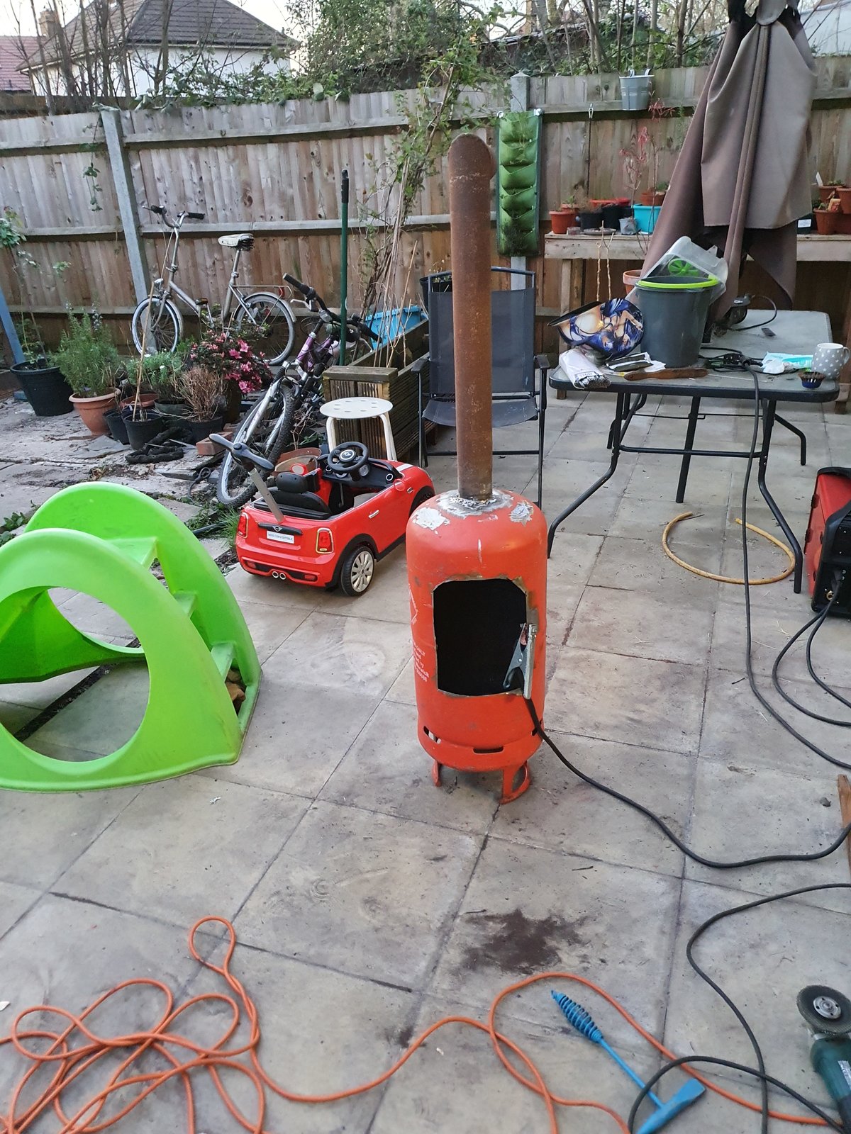

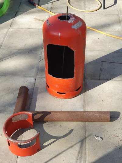

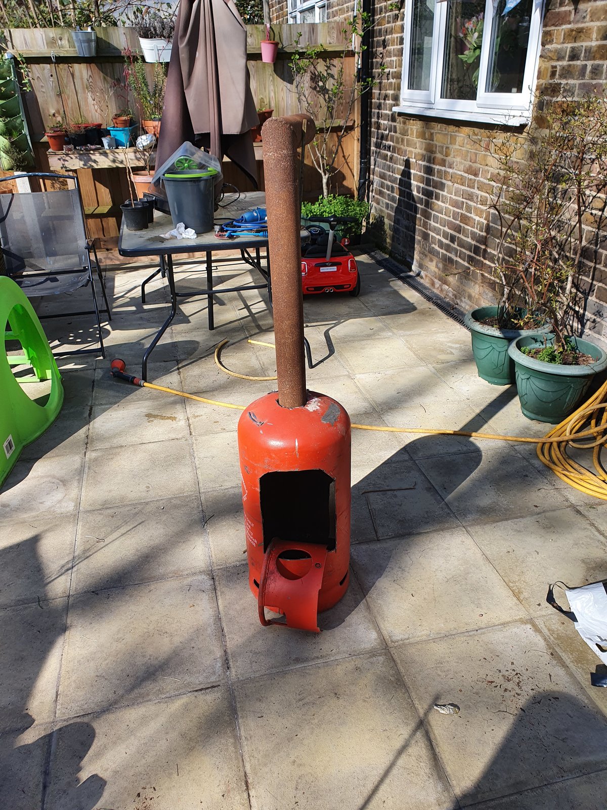

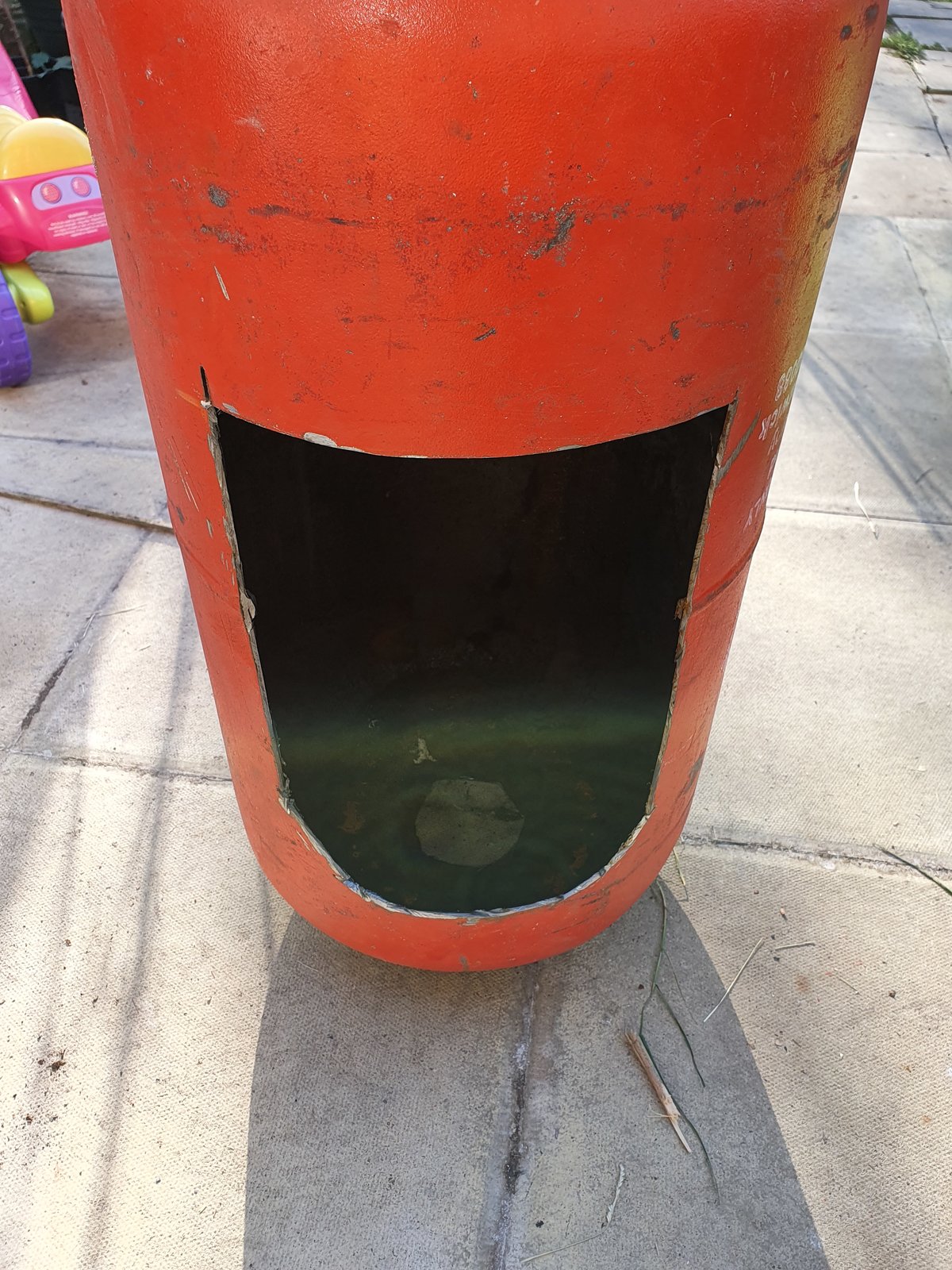

Ok so here we go standard wood burner nothing special first project yet to cut the air slots going to cut the ring off the handle and weld to back as a carry handle

So j had a nice burn up in it last night and noticed 2 things it needs a door jaysus does it spit at you and the chimney is either to short and to slim or its because of the curve but the smoke doesn't vent properly mostly comes out the door aswell as the flames lol
