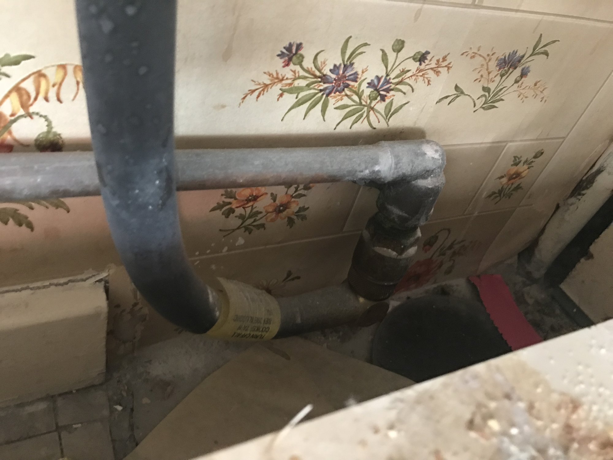

Welderpaul Member Staff member Messages 14,824 Location UK Oct 19, 2018 #1 Gas hob connection which I need to disconnect tomorrow- Is this a bayonet connection and will it just come apart and self seal?
Kayos Gone...... Messages 9,949 Location North Lincolnshire Oct 19, 2018 #2 Yes, it’s a micropoint bayonet, twist and pull
Welderpaul Member Staff member Messages 14,824 Location UK Oct 19, 2018 #3 Great, thanks - new cooker will be electric so this will not be needed - is it safe to just leave it live with nothing connected to it or does it need capping?
Kayos Gone...... Messages 9,949 Location North Lincolnshire Oct 19, 2018 #4 Should really be capped as it’s a self seal, so in theory susceptible to heat from the new cooker
