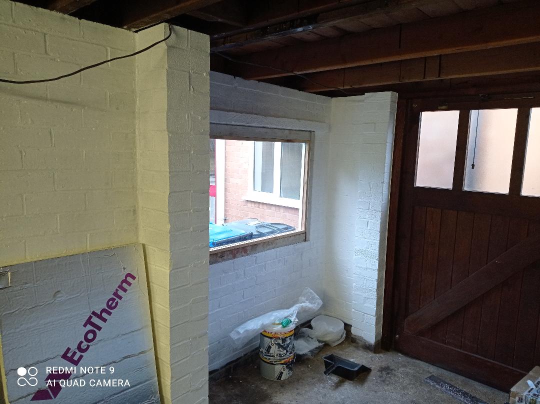

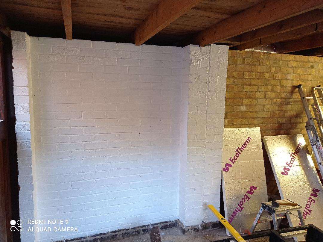

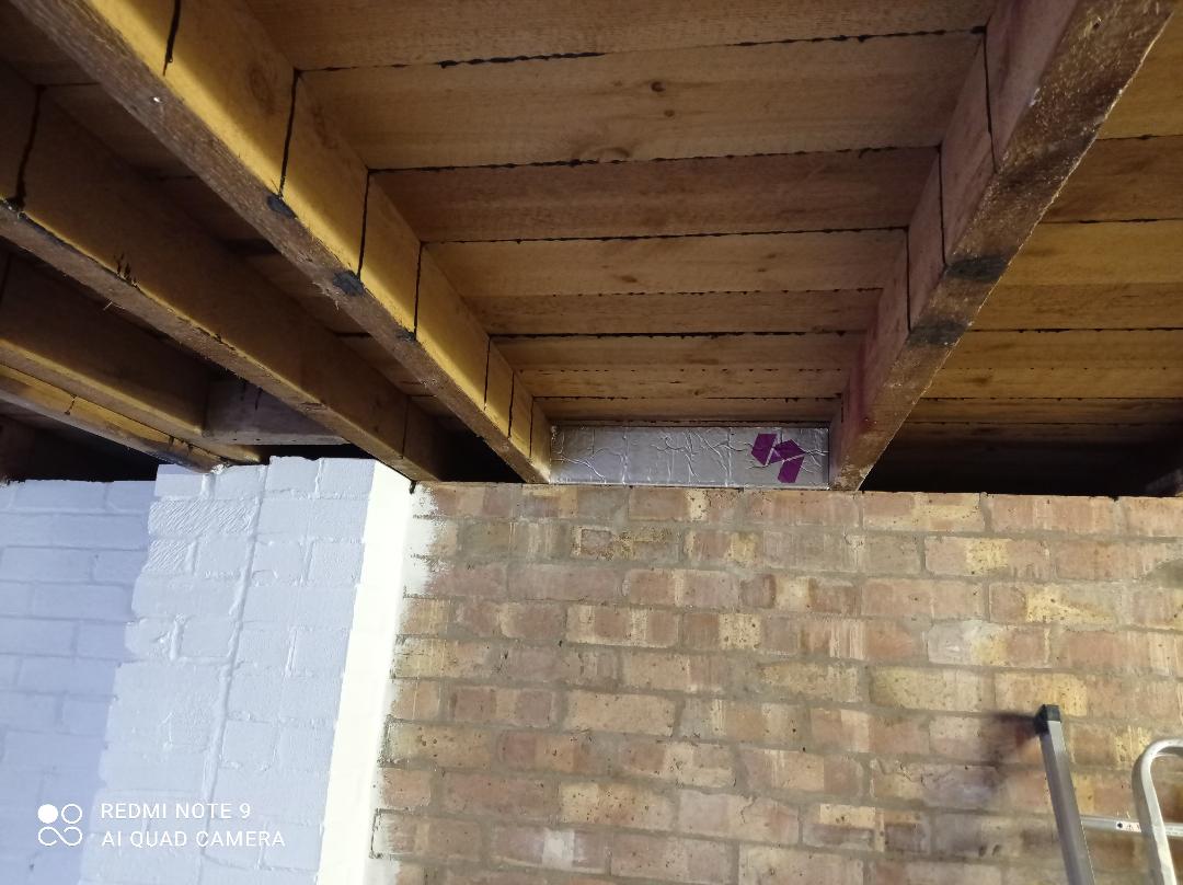

Well I got some more coats on. Its one mist coat, one good coat with a brush to get in the mortar lines and one good coat with a 4"roller. Seems ok, might want one more but I will wait until everything is in and fitted up as I'm bound to make some marks here and there.

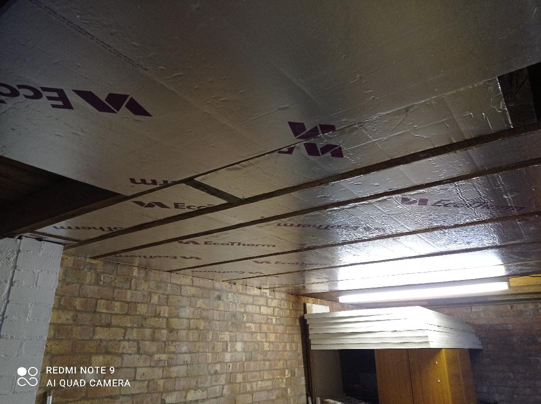

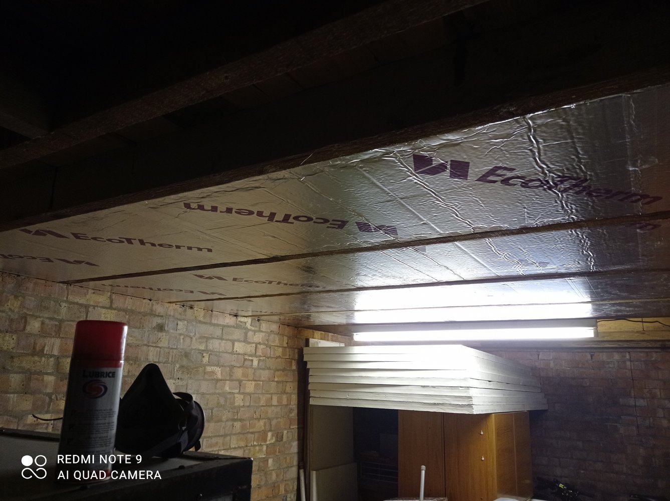

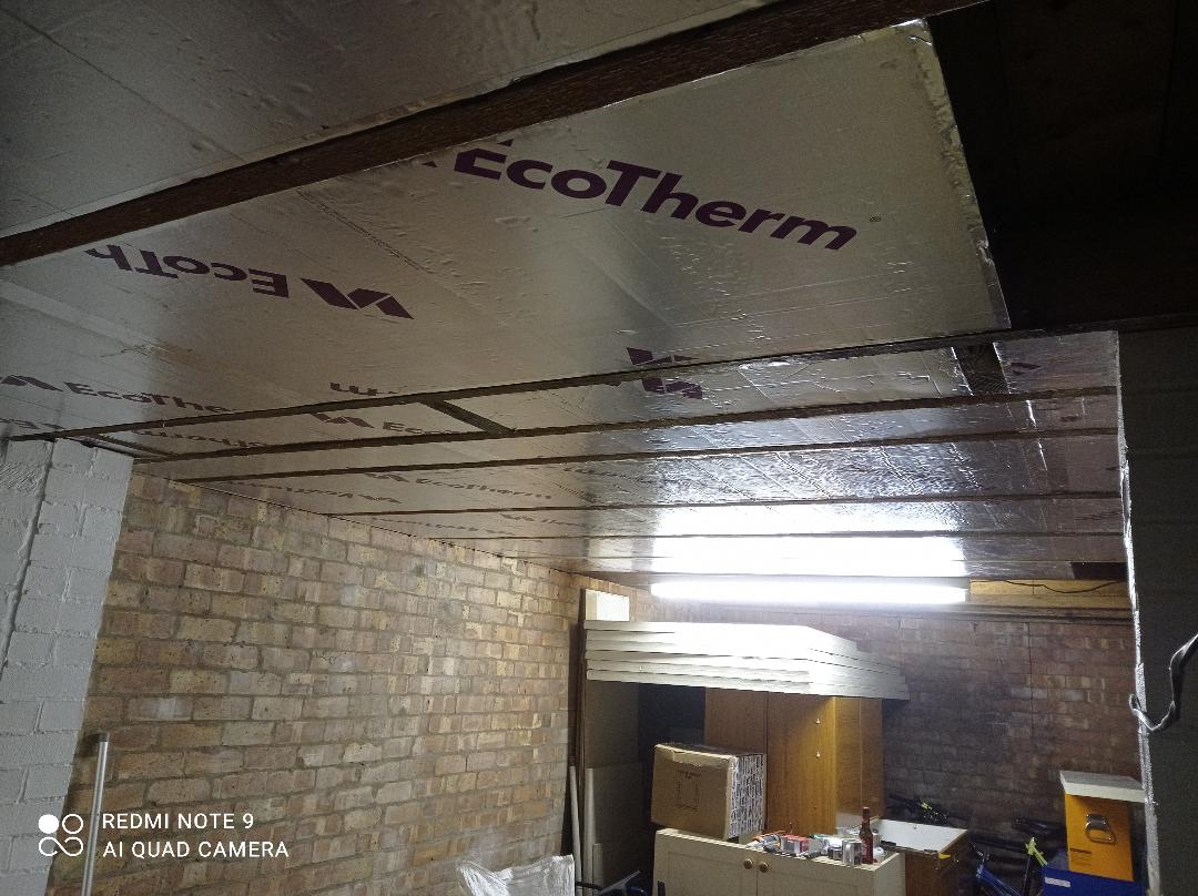

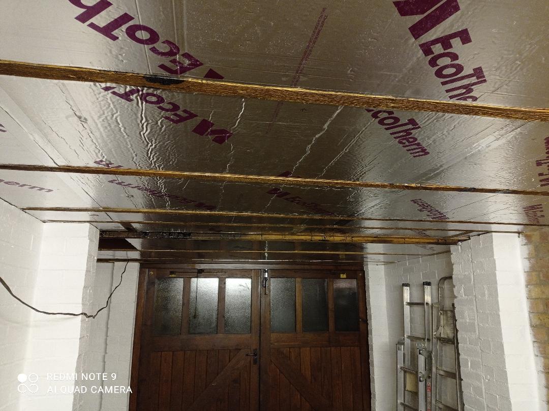

Started on the insulation whilst waiting for bits to dry. Seems to go ok. Trying to cut the boards the rights size is a challenge. The joists are a little out and I'm trying to cut the boards to a square size not taper them off. Decided to cut across the 1200 width, means an extra joint but I'm getting minimal waster. It gives me 6 inches at the bottom of a sheet that I am using to block off the void to next doors garage. Lots to do still but I'm getting there, it's finding the time in between the wife's orders and a 6 year old that wants her dad all the time.
