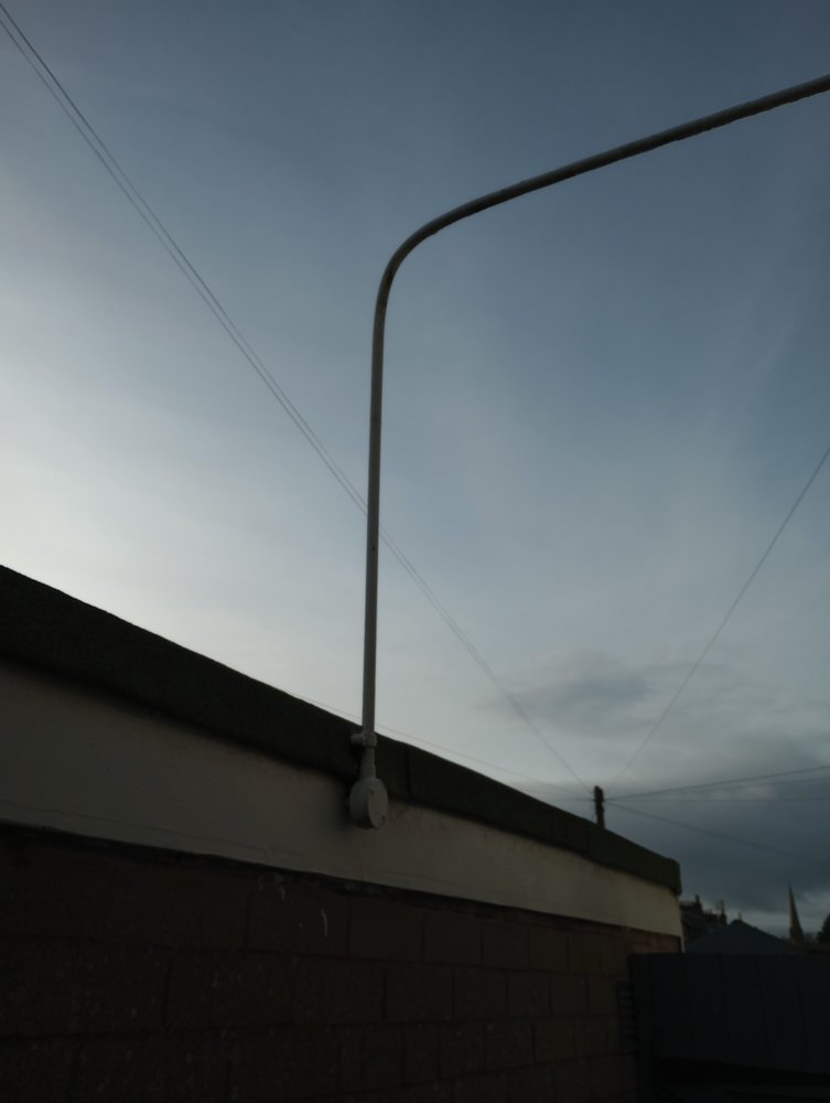

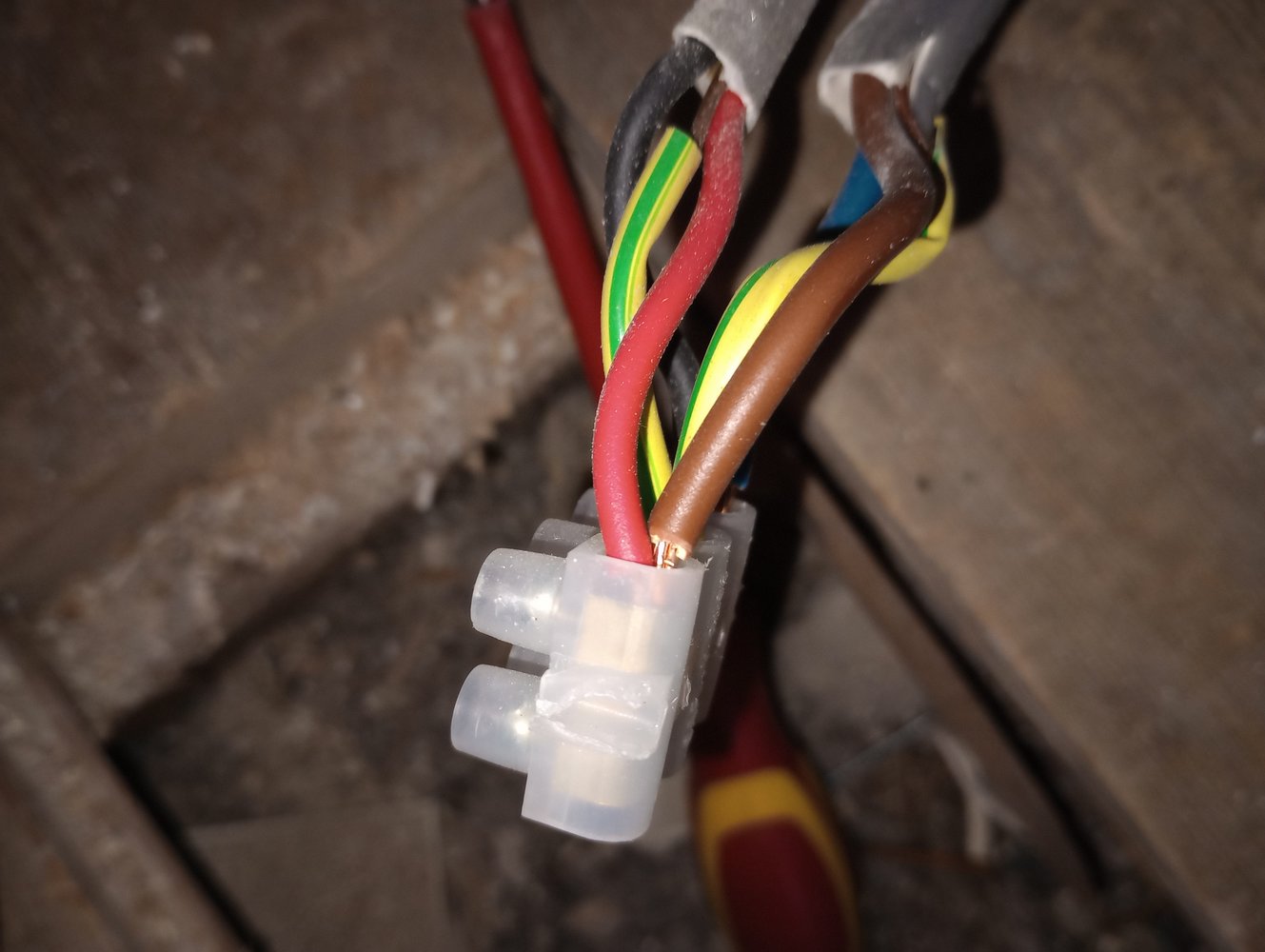

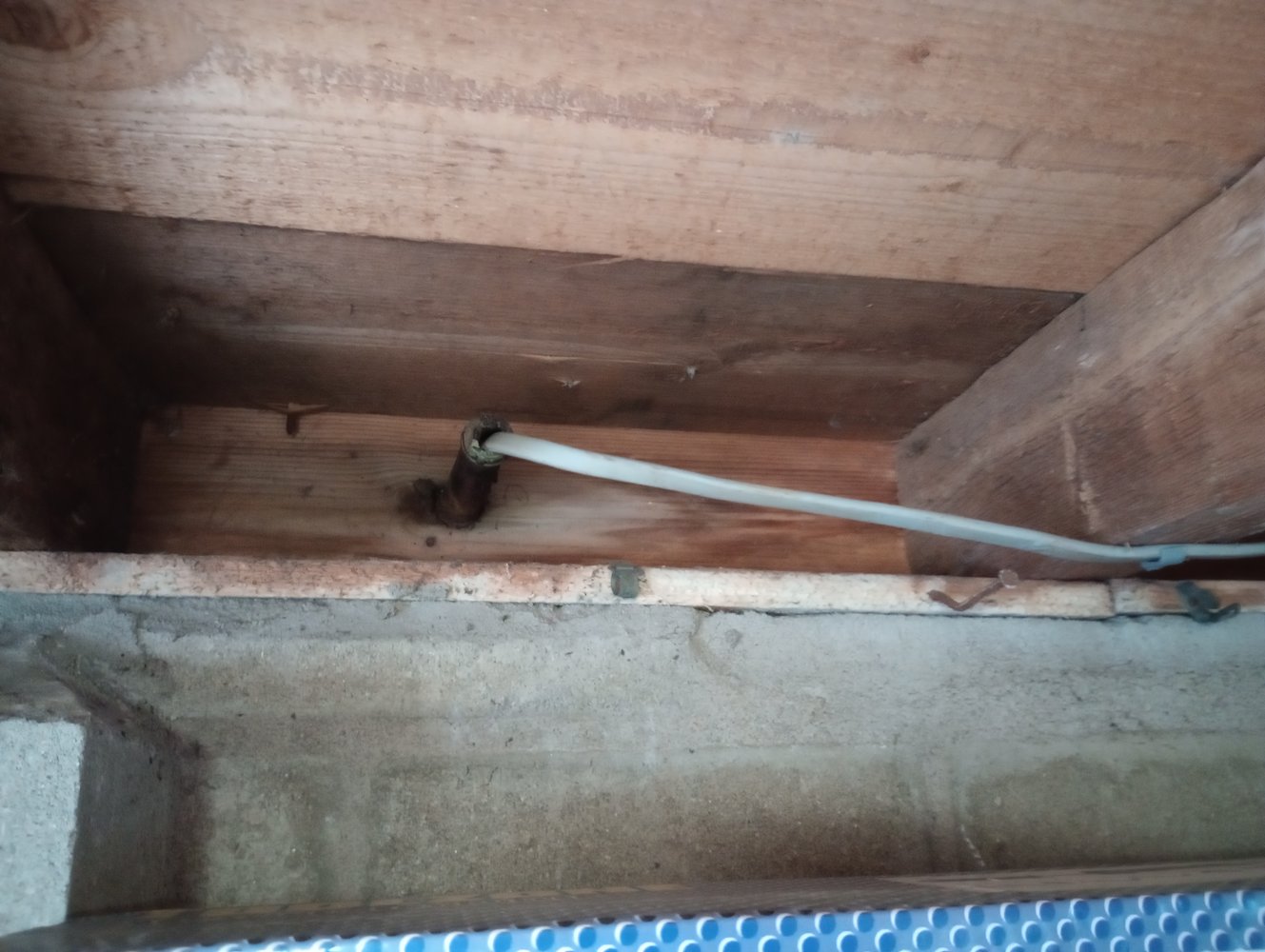

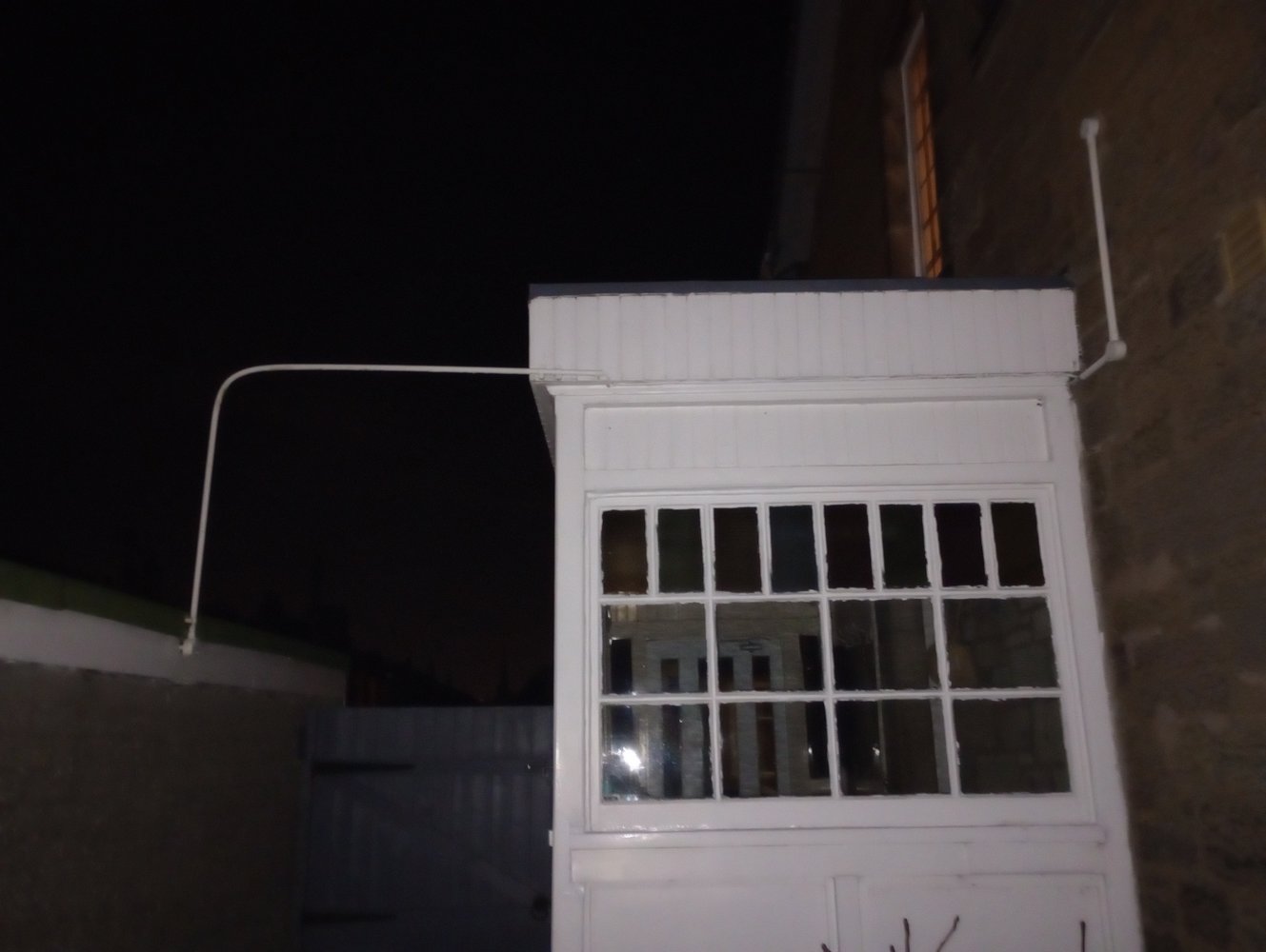

Here is a job that needs looking into.

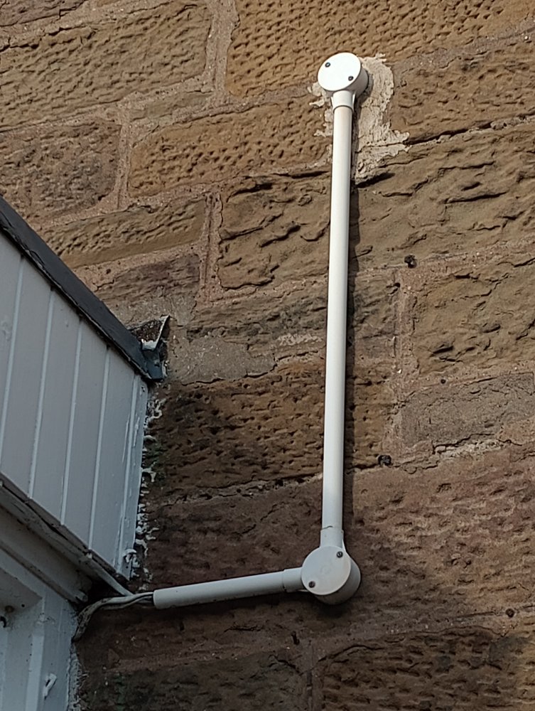

Garage wiring is on a radial circuit with a 32A breaker in the main CU with what looks like a 4mm conductor.
It comes out of the side of the house here, but no longer looks like 4mm, more like 2.5mm.

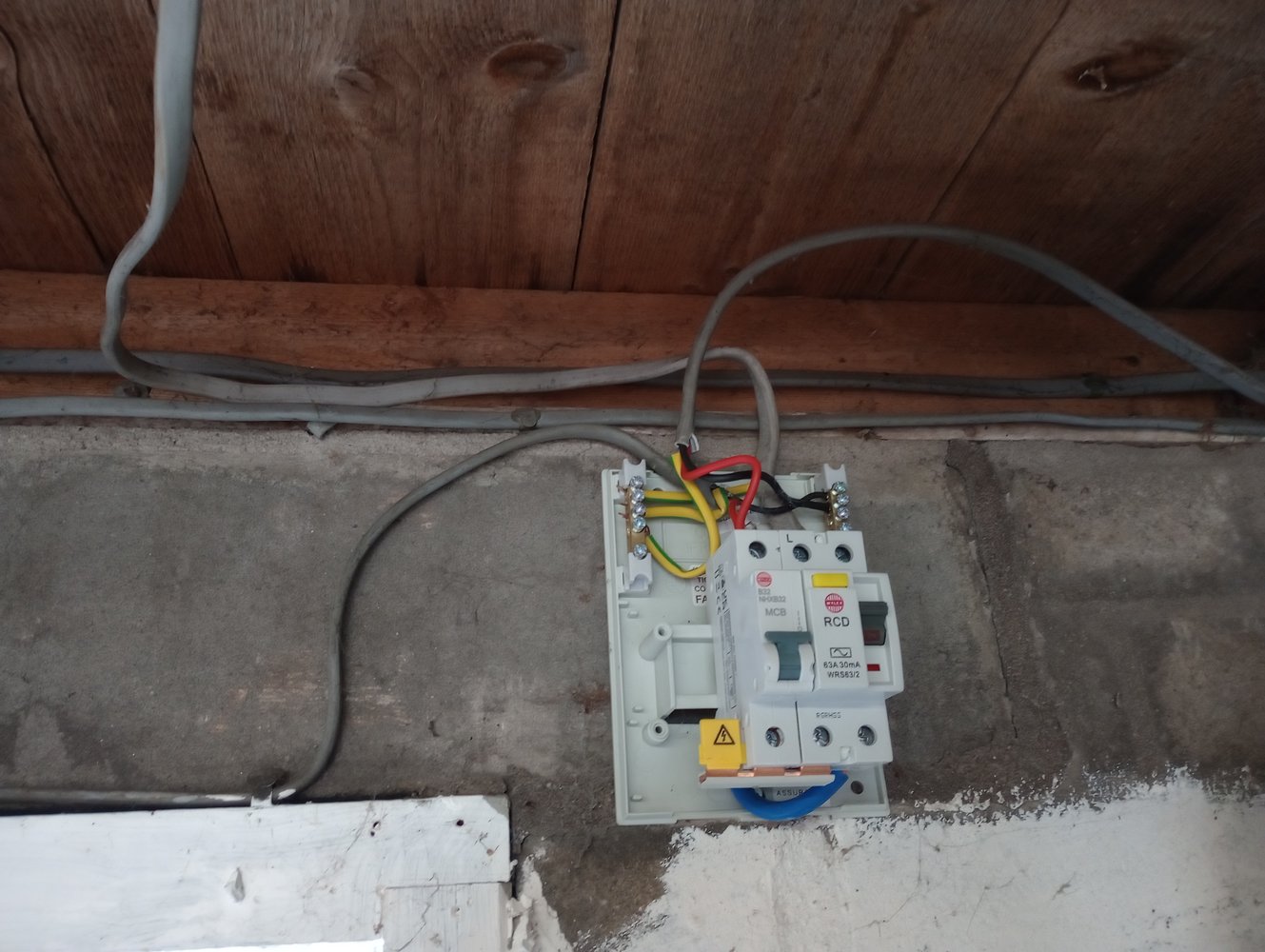

Comes into the garage here, definitely 2.5mm.
And then here is the CU in the garage.

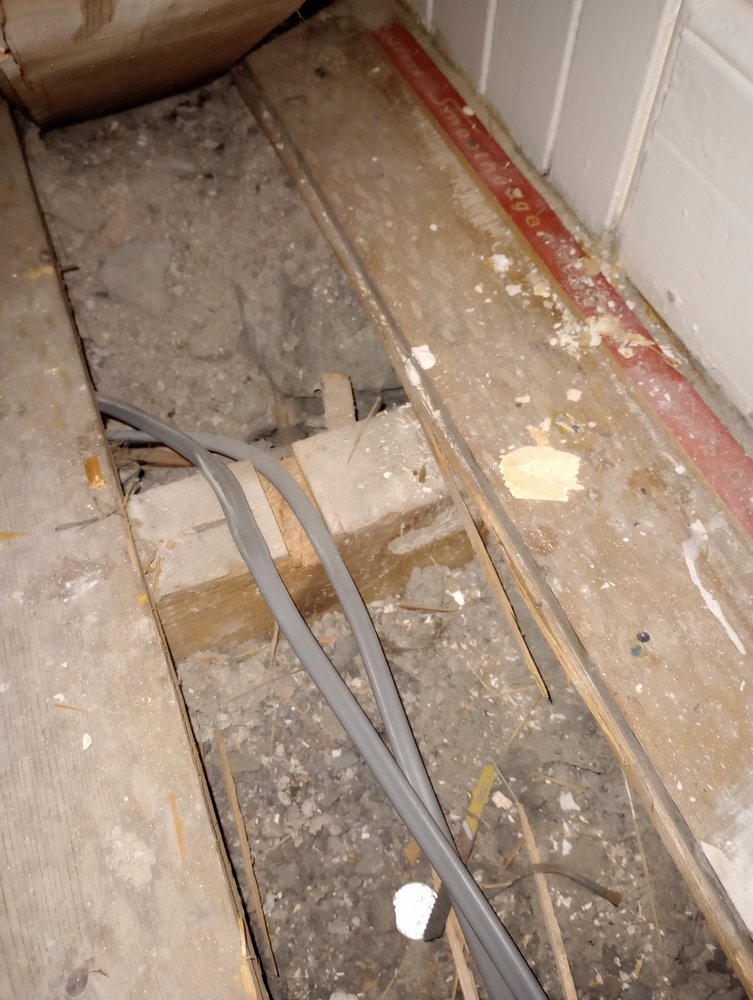

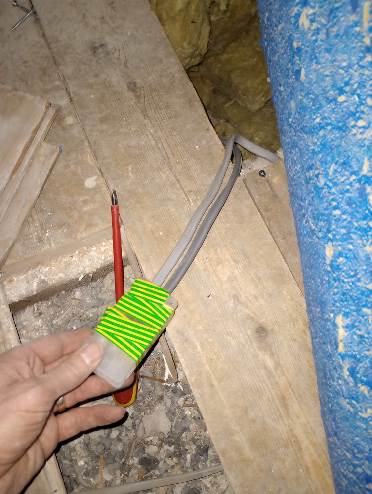

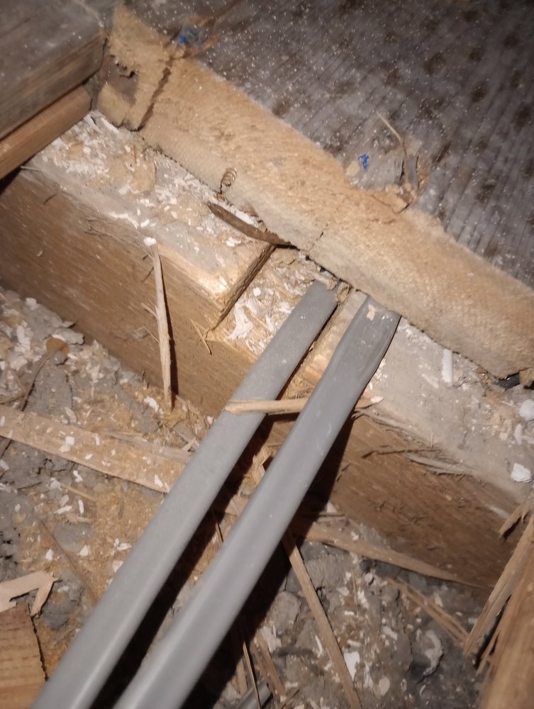

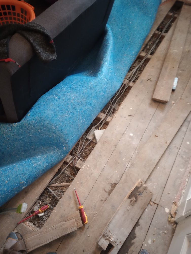

Not too clever. I suspect the join will be under the bedroom floor just inside the wall.
Will need to lift the carpet and boards to have a look then extend the 4mm out to the garage.
