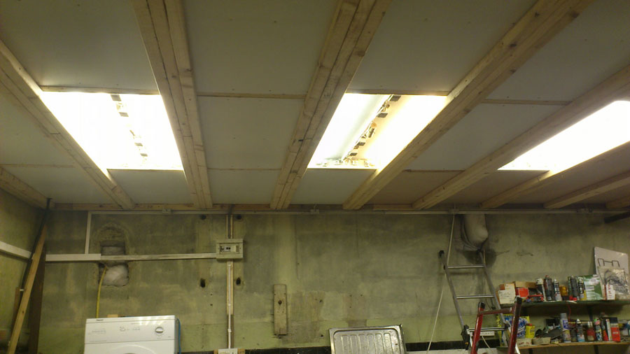

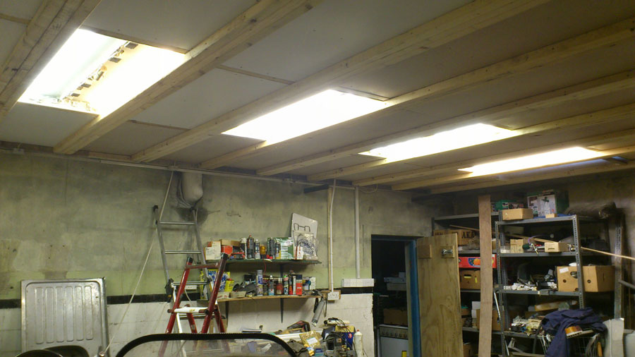

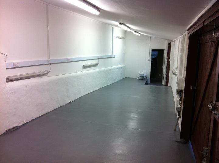

Lighting, is my main question, its just a standard single garage, block walls/white painted p/b ceiling...so im thinking of putting 2no 4' single LED striplights, 3-4' apart... Or should I just get a 6' Double and whack it in the middle...? I can always add a dedicated task light to the lathe for instance, but would be nice to have decent light over the bench etc.
