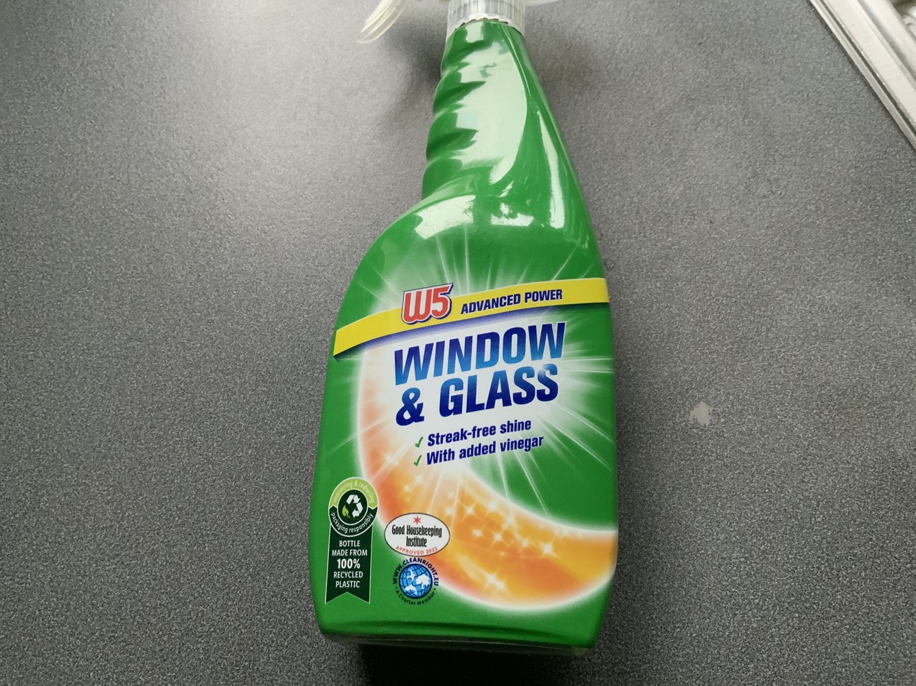

Oh dear. Guess what regulator I have? Just to be clear is yours leaking at the connection to the bottle? I'll need to check mine tomorrow, would leak detecting spray like you used to check LPG work?
I had similar with our propane a while ago. Twice a cylinder was leaking at the hose and it was definitely the hose. You could see a gap in the bright ring round the cone showing it didnt seat all the way round. The gas man recommended that leak spray every time we change a cylinder.
If you mean our propane issues, I got both hoses replaced. It was only after we'd had a second cylinder leaking and I did a bit of swapping around that I narrowed it down to hose rather than cylinder. Just made me a bit paranoid, and the leak detector spray seems a better than my previous method of listening and sniffing.If it were that bad, I'd bin it. If fact, if it were just a bit bad, I'd bin it.

OK I'm officially blind. Mine is leaking in the same way, at the fitting to the gas bottle. Just emailed them and I'll see what he says.The good news is I'm not detecting a leak between my Argon mix cylinder and the regulator.
