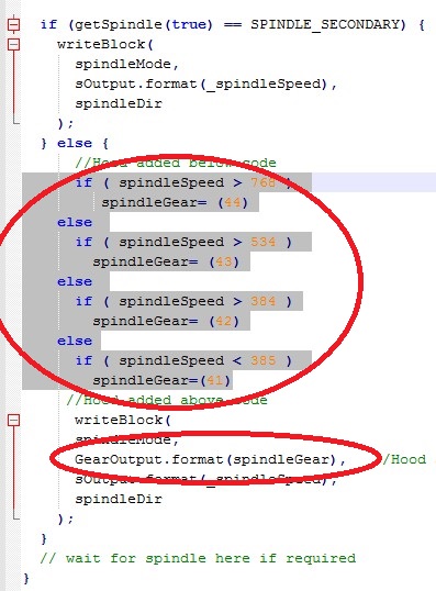

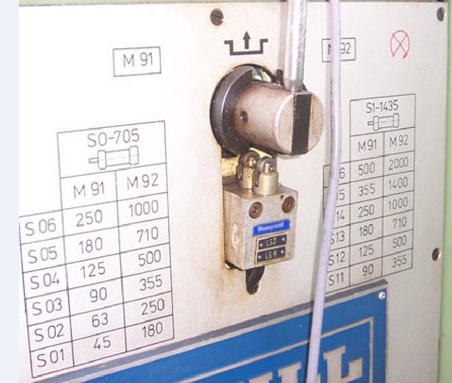

I posted a question on the Autdesk forum yesterday evening but so far I haven't had a reply.

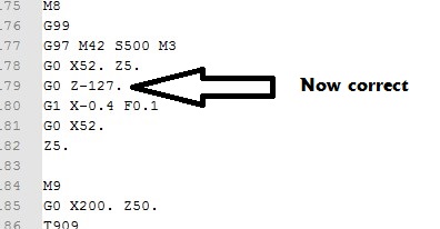

My stubbornness however has paid off and after lots of trial and error I seem to have found the correct Tampax (think thats the term )
All seems to be working as I want, codes M41, M42, M43 and M44 are being posted in the correct place with the correct spindle speed range

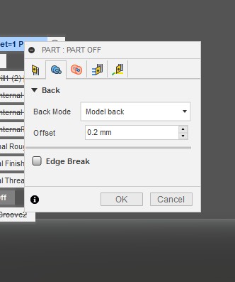

Here is what I added to get it working.
