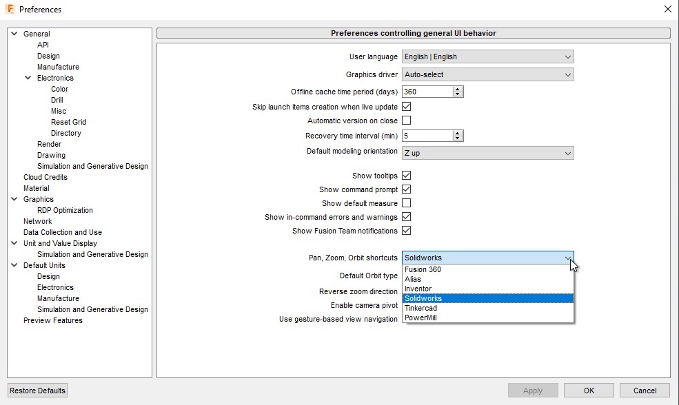

Change the settings, I have it to Solidworks so I can use the mouse as I did in that which was what I was used to.
Also use the viewcube (top right) for specific views, clicking the edge of that will also give two edge views.
