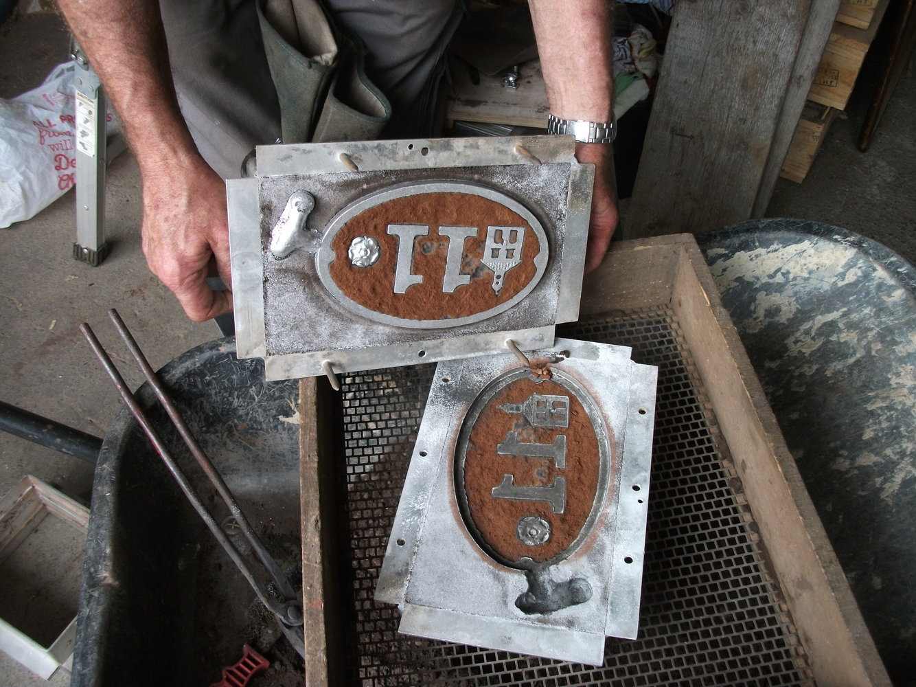

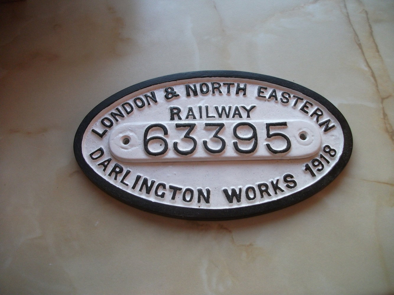

trying to make a pattern for a brass nameplate pattern (similar to the old railway signs)

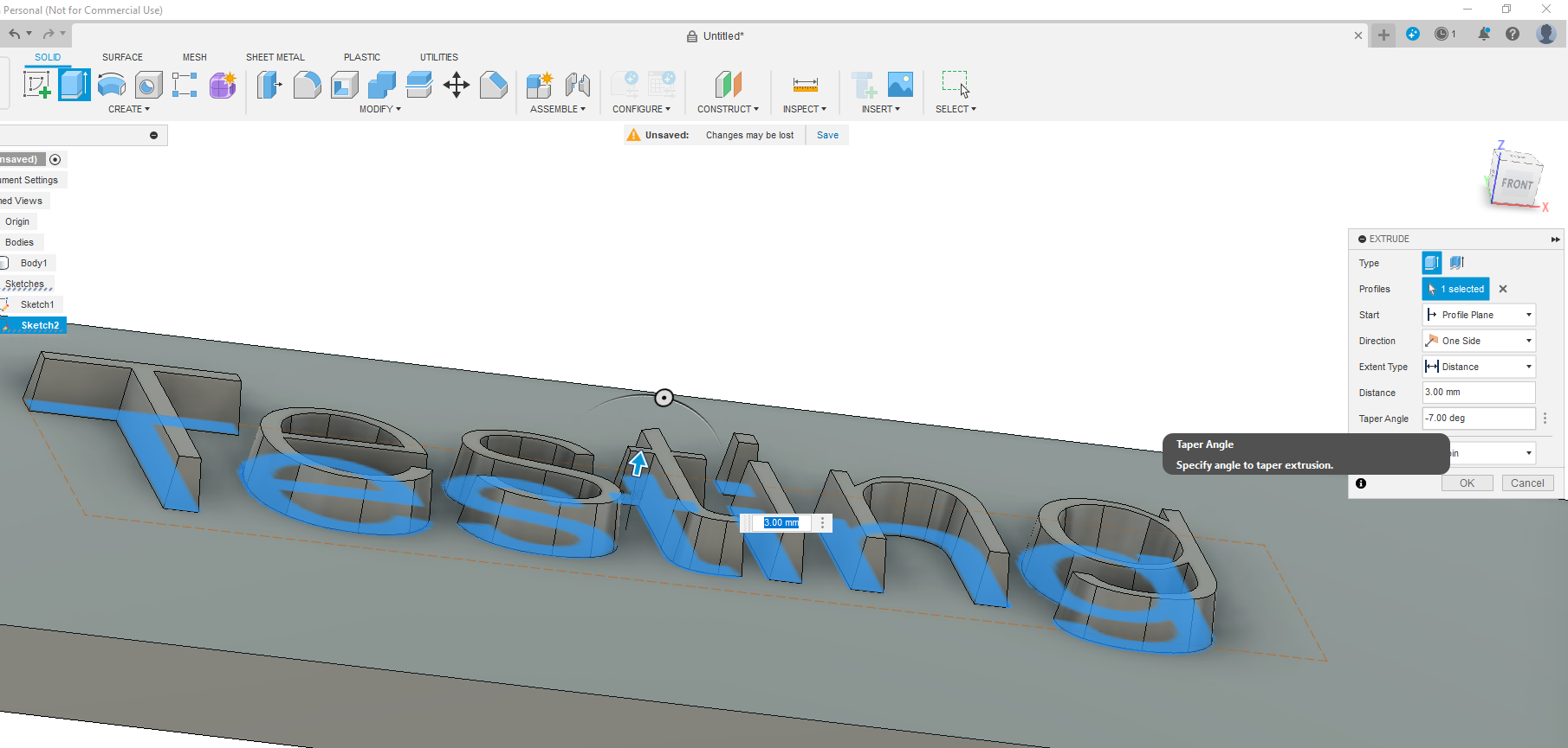

trying to put a taper onto the extruded letters so they pull out of the sand nicely

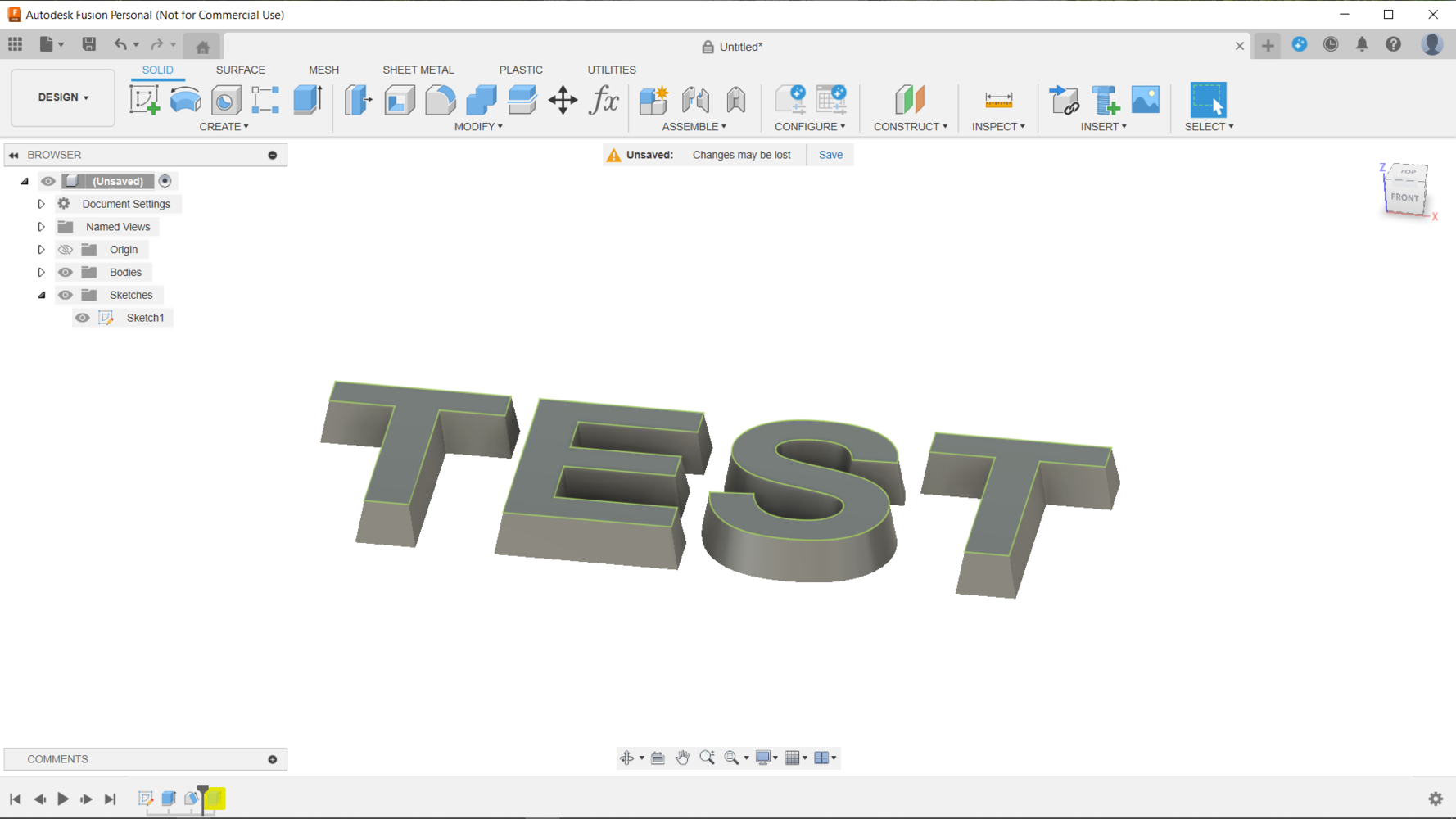

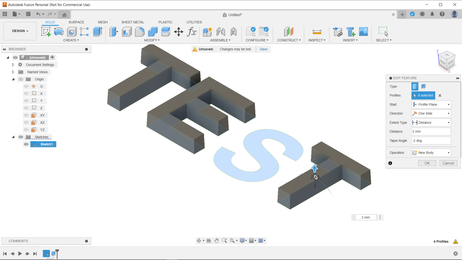

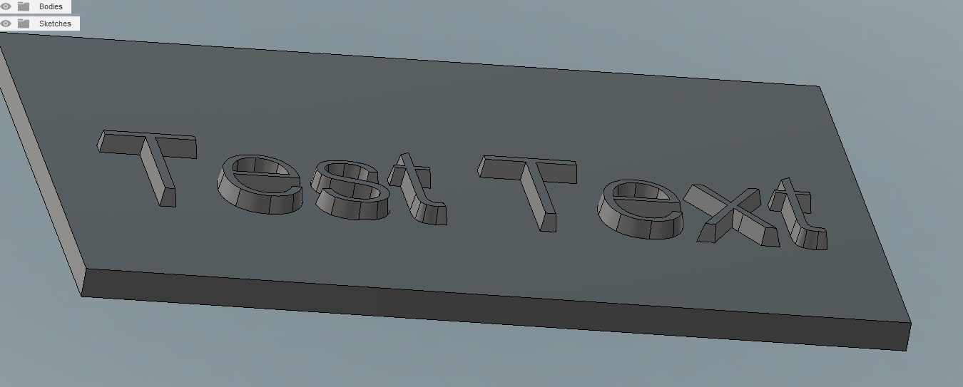

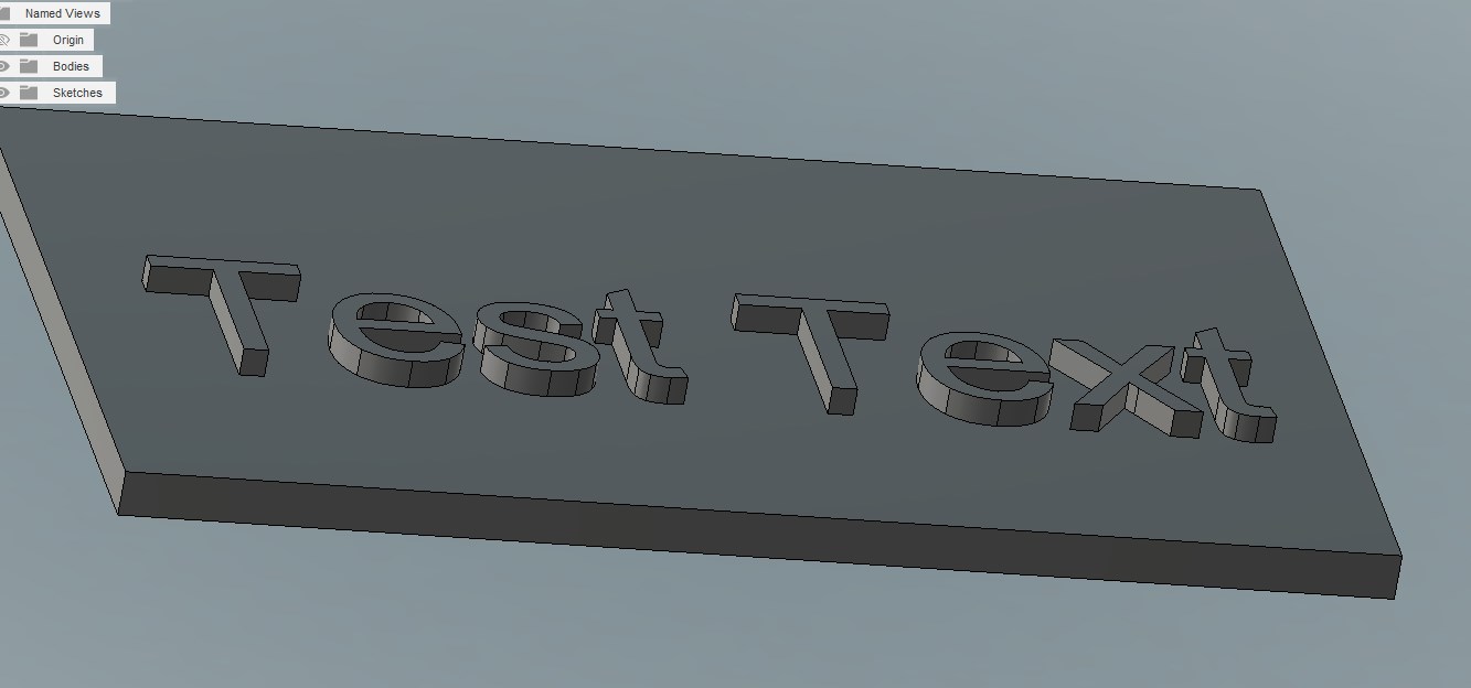

fusion wont do it
some letters disappear
guess its when the touch each other, but only extruding 12mm letters -3mm, and even tapers of 0.01 degree wont work
