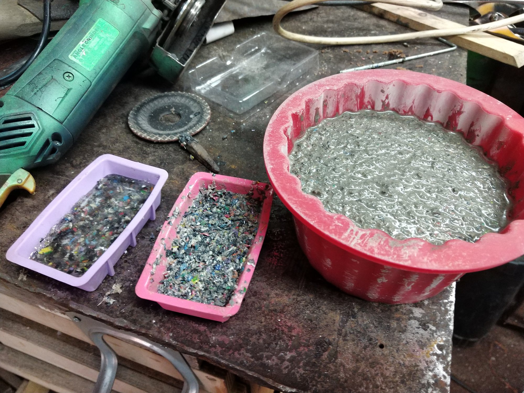

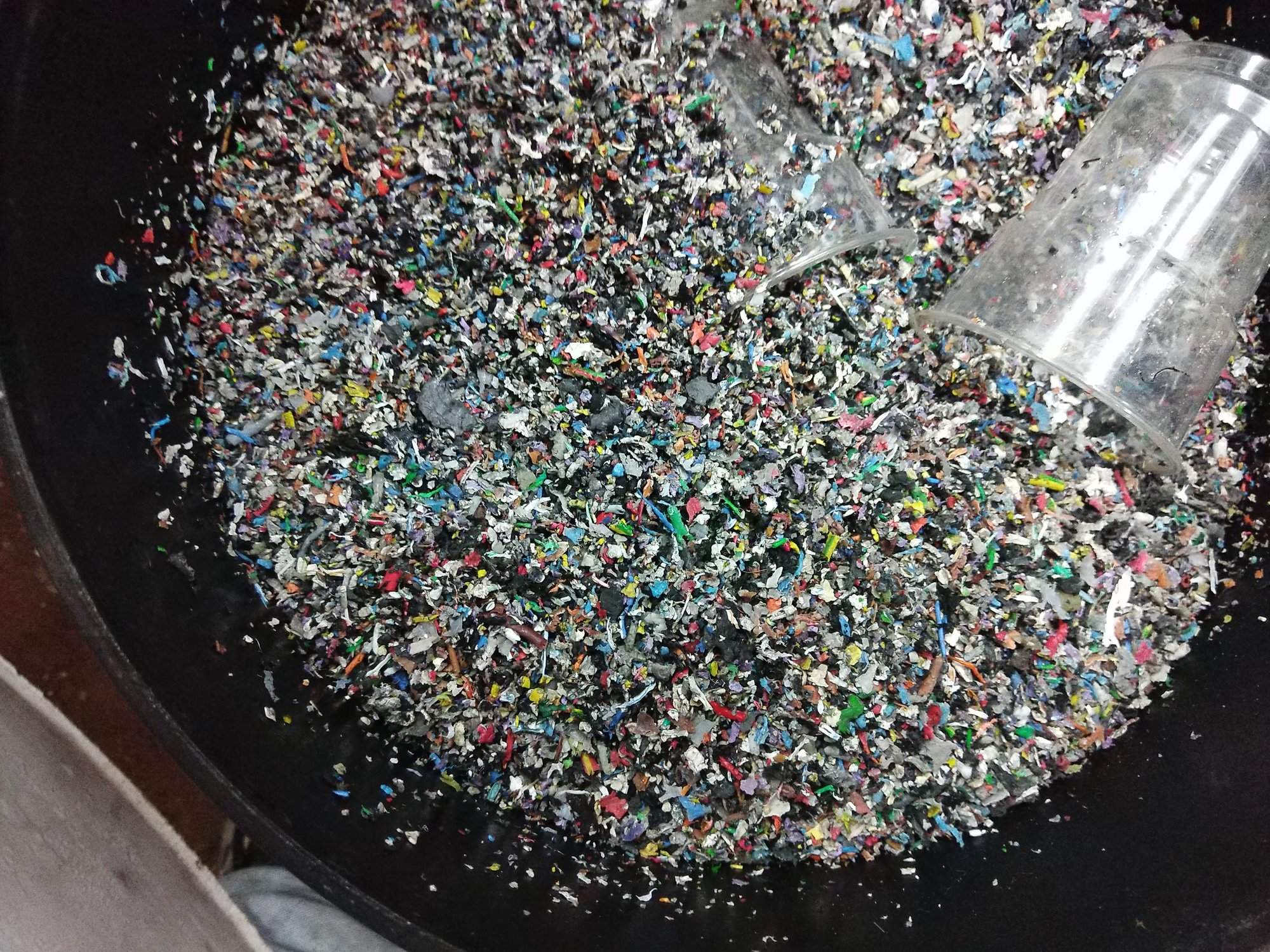

I have been given 25l of shredded cable insulation - apparently used as a floor covering for horse arenas? - with the option for a further 50
jumbo bags of it if i want it.
So i thought i'd see how it works as a decorative filler in cheap (milky/opaque), and clear, polyester resins.
Plus i had an open bag of cement - so i made a batch of concrete with it

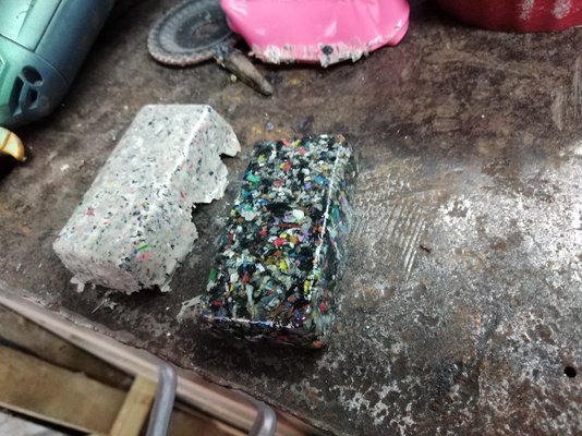

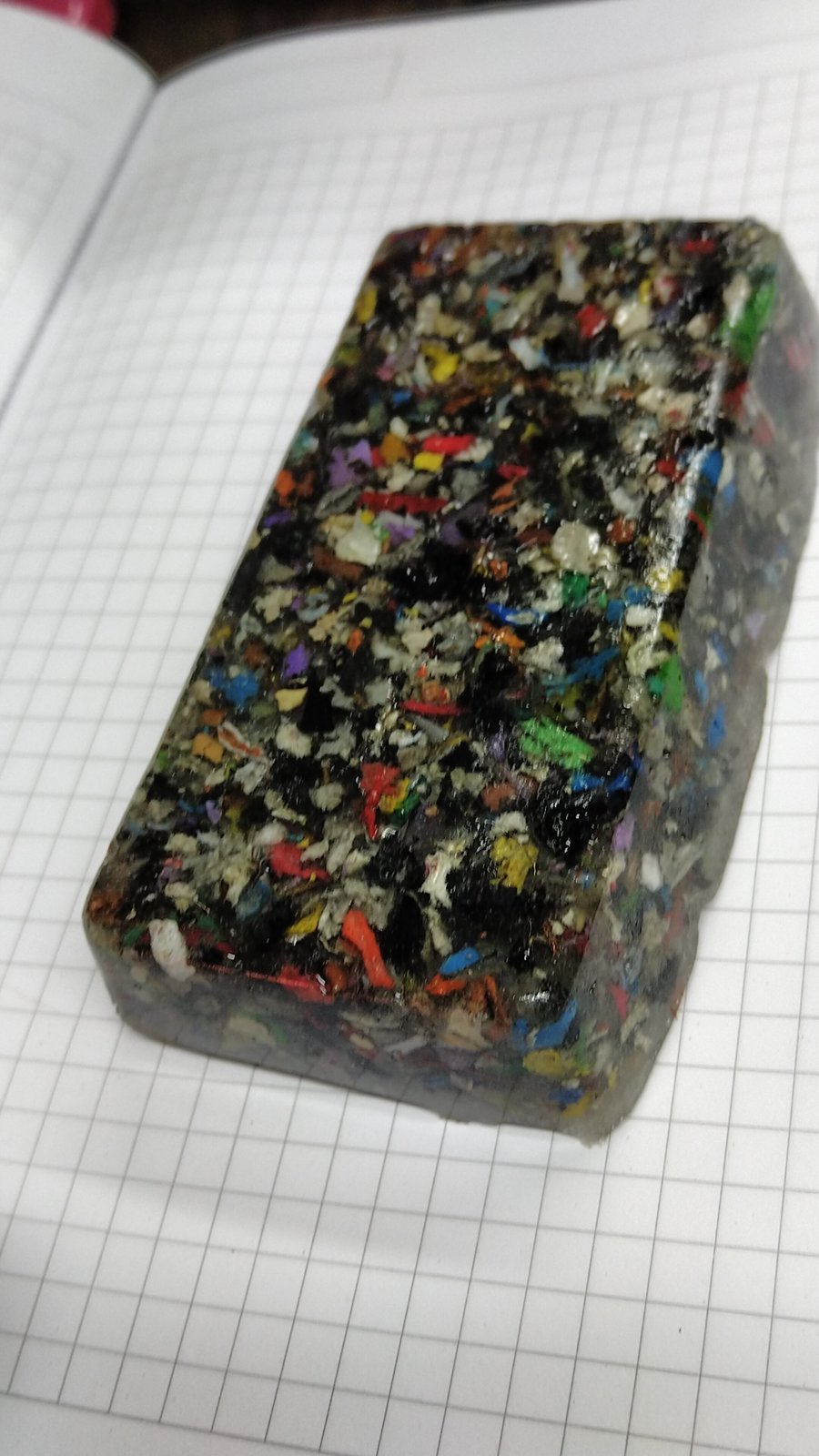

The clear is mixed 2pts resin:1 part "shreddies".
Opaque is 50/50.

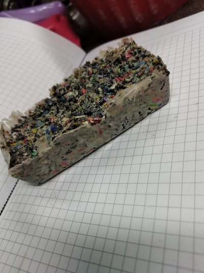

Concrete is 1 portland:1 soft sand:4 "shreddies"
I've not degassed or otherwise removed air bubbles
