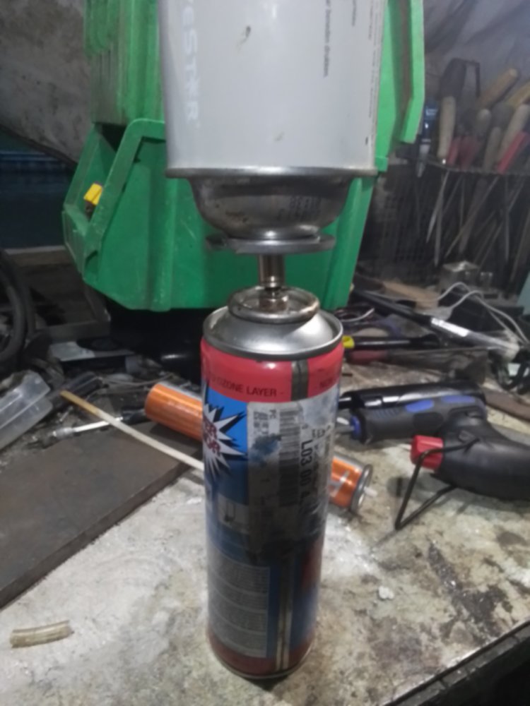

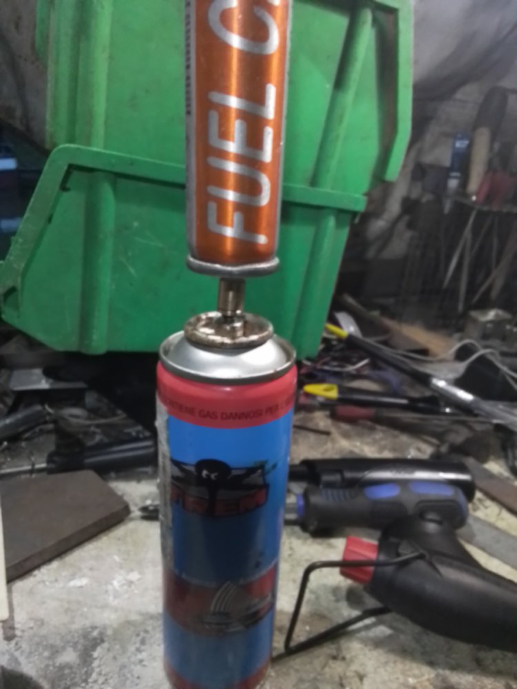

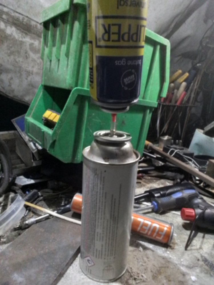

How to use up any gas refills you have or find in a skip by transferring to your can.

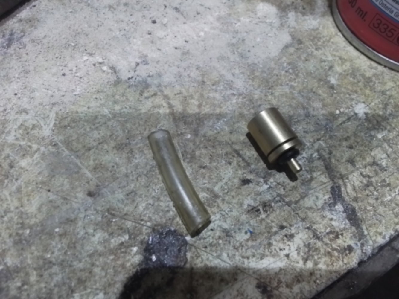

male fuel cell to screw on gas transfer with 3 mm bore plastic tube ( liquid gas goes down )
cheap £1 gas refill into male screw on can using adaptor.
Lighter gas into clip on refill
Transfer tube is just 3mm bore tube and adaptor from ebay https://www.ebay.co.uk/itm/35440411...31EbyPMS6i&var=&widget_ver=artemis&media=COPY

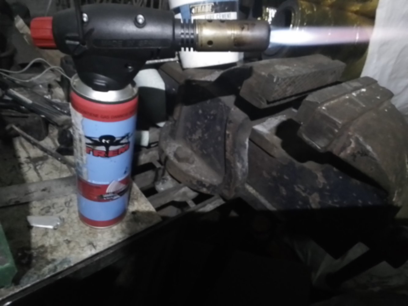

This Air horn refill is actually Butane from the factory and is running this torch .Lots of aerosols use butane as the gas .
