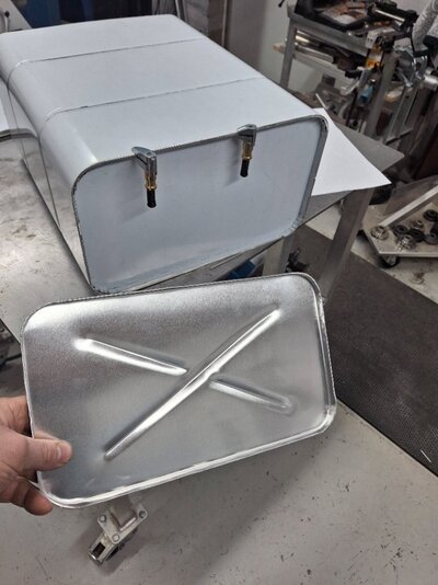

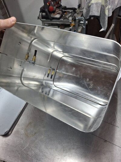

Whats the consensus on Fuel tank ends like these i made a buck and formed the ends over it, I've been thinking of making some like this, ill need better hammers etc, seems really strong and ridgid, what's the pros and cons

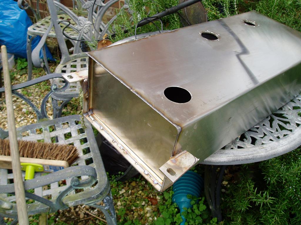

It's baffled John, also has a built-in swirl pot.You putting baffles in ? You too Paul ?
Bead roller is a little iffy for getting the exact same form, for me anyway, with a former and the edges beat over i get the same result each time, as for the stiffner cross in the middle of the end tank i may go a different road for them, the former ideally needs a bit of steel plate same size fixed to the wood, this is a self learning process, I think I'll get myself some panel beating/plannishing hammersI thought you had a bead roller ,,, thats the way to go , if its heavy enough to handle the thickness your using
Question is even though a lot of old tanks where made this way, I've been told by a friend he fixed a few of tanks made this way in his old place of work, personally it looks to be a superior way of making them with added stiffnessI'm not sure if there's a question in the OP post, it looks great to me, normal way to do it. Here's my effort in stainless.
Any photos of the internal swirl pot/catchment area, ive looked at a few designs on the internet but I've never done one myself except with expensive one way valvesIt's baffled John, also has a built-in swirl pot.
try an air hammer and flow form them ,,, as for planishing hammers , just polish the end of a 1 lb ball pein , it will probably do what you want to start with ,,, Ive a few hammers and seem to only ever use about four of themBead roller is a little iffy for getting the exact same form, for me anyway, with a former and the edges beat over i get the same result each time, as for the stiffner cross in the middle of the end tank i may go a different road for them, the former ideally needs a bit of steel plate same size fixed to the wood, this is a self learning process, I think I'll get myself some panel beating/plannishing hammers
Unfortunately not. It was made from part of a stainless steel flask I found in a charity shop. It forms a small sump lower than the floor of the tank and houses a pump from CBS, apparently a jaguar part. The return from the fuel rail goes into the lowest part of the swirl pot and sits in a venturi tube.Any photos of the internal swirl pot/catchment area, ive looked at a few designs on the internet but I've never done one myself except with expensive one way valves
Thats what I used, an air hammer is on the things to purchase listtry an air hammer and flow form them ,,, as for planishing hammers , just polish the end of a 1 lb ball pein , it will probably do what you want to start with ,,, Ive a few hammers and seem to only ever use about four of them
you will need two ,, a brutal hard hitter ,,, and a nice handy finisher ,,, its just how they seem to be ,,Thats what I used, an air hammer is on the things to purchase list
Thats how I done them, wood is too soft so im going to cut some steel to screw onto the bottom former 4-6mm should do, i plan to cut an x in the steel and form it with an air hammer,It this in aluminium?

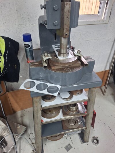

I use this method on smaller tanks but these are quite large and would struggle in my fly press, the end plan is to have some cut at different sizes, them its only the length of tank that changes, I've gathering a few different tanks from older cars to copy, smaller tanks I use the method above on pressing tank ends@Cheesie are they always the same or are you adapting the size / shape for each one?

I use this method on smaller tanks but these are quite large and would struggle in my fly press, the end plan is to have some cut at different sizes, them its only the length of tank that changes, I've gathering a few different tanks from older cars to copy, smaller tanks I use the method above on pressing tank@Cheesie are they always the same or are you adapting the size / shape for each one?
