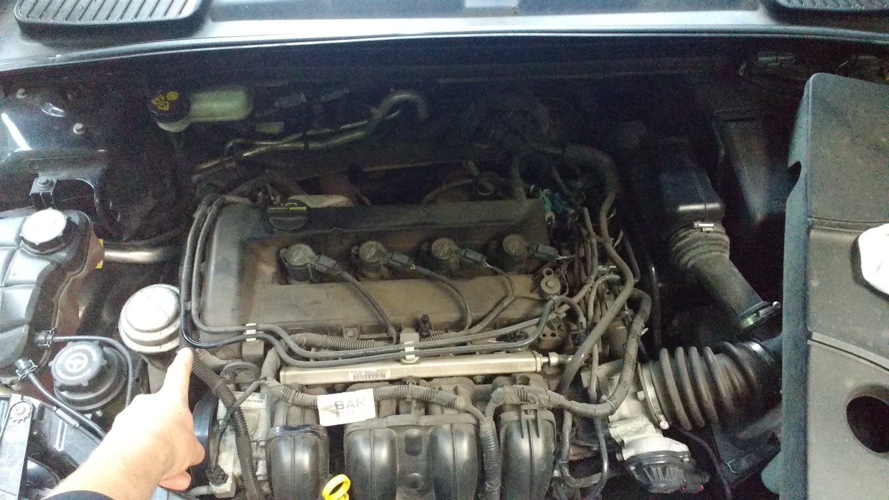

The end to a perfect day. Smelt petrol on the way home from the FiLs funeral! 2011 Mondeo MK4 Duratec 2.0

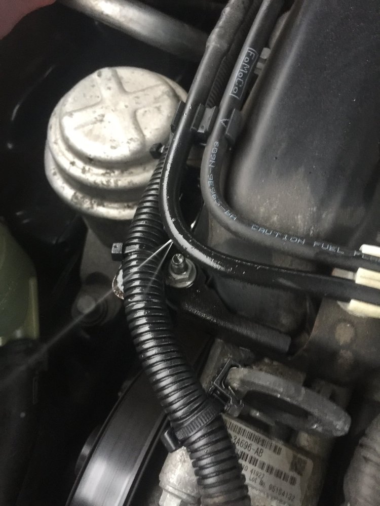

Sure enough. Leak right on this elbow where it's wet:

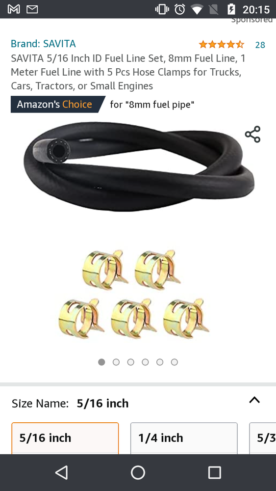

Can I quick fix this? I've ordered some 5/16" repair tube and clips from Amazon.

From some sleuthing the complete pipe from Ford is part no 1523195 6G91-9J280-BG. I'll ring them but likely an arm/leg job! Maybe my motor factors will have something.
Seems you need fuel line disconnect tools too...little bits of plastic. Got laddo printing a selection of 5/16" tools I found on Thingiverse.
