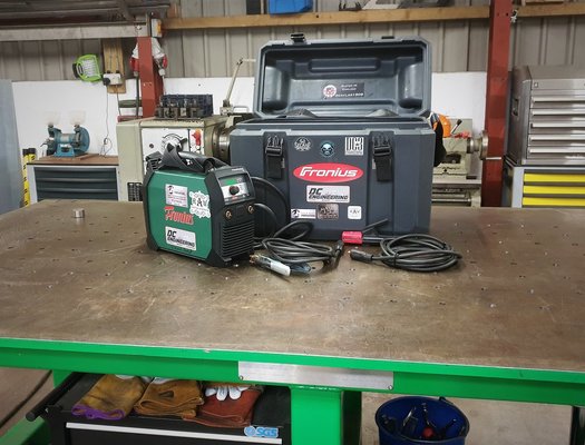

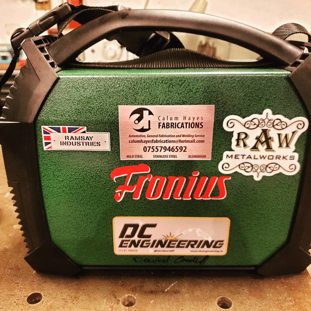

Anyway, we're at the end of the journey now... I've quite enjoyed following this on Instagram, and following the 11 other people who had the machine for a week.

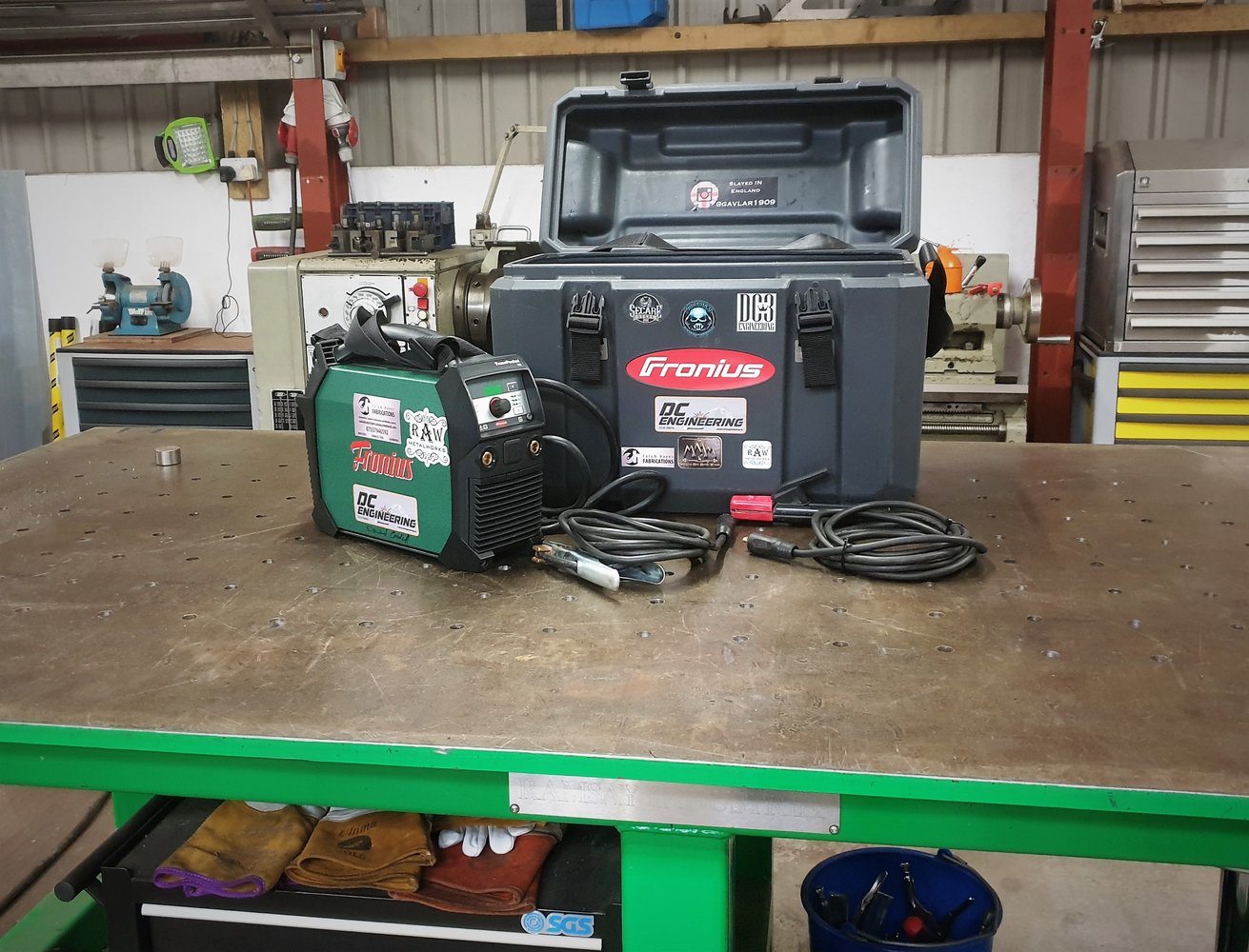

Now it comes to me, last (and probably least

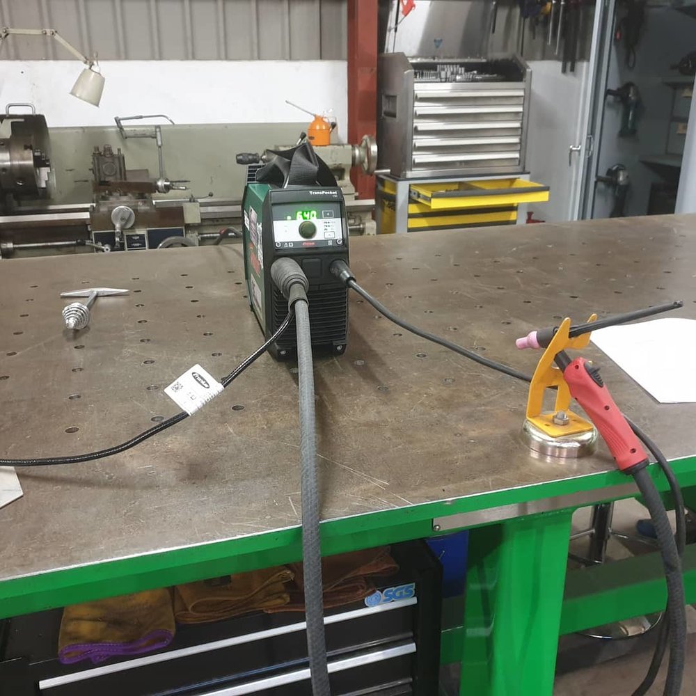

) covered in stickers, and in the diagnostics, it had already clocked up 6:40 hours of arc-on time... I thought that was quite a lot, considering it's not being used every day!

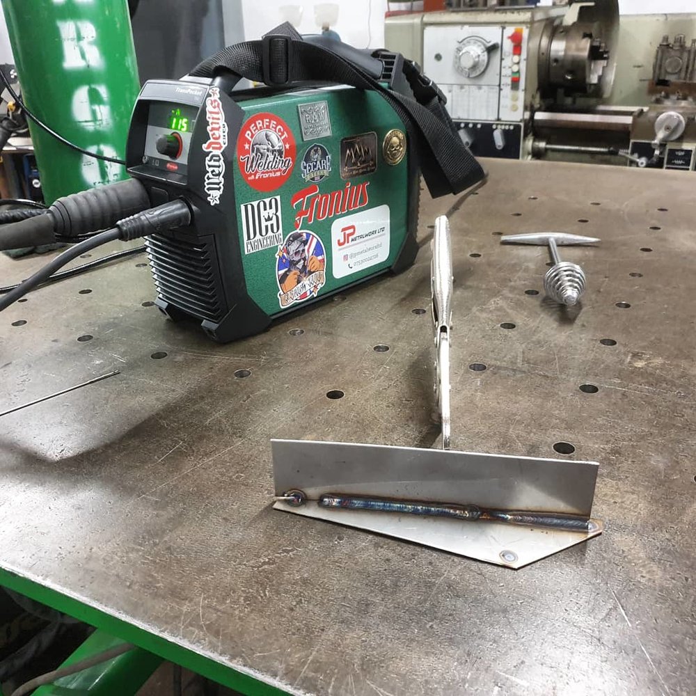

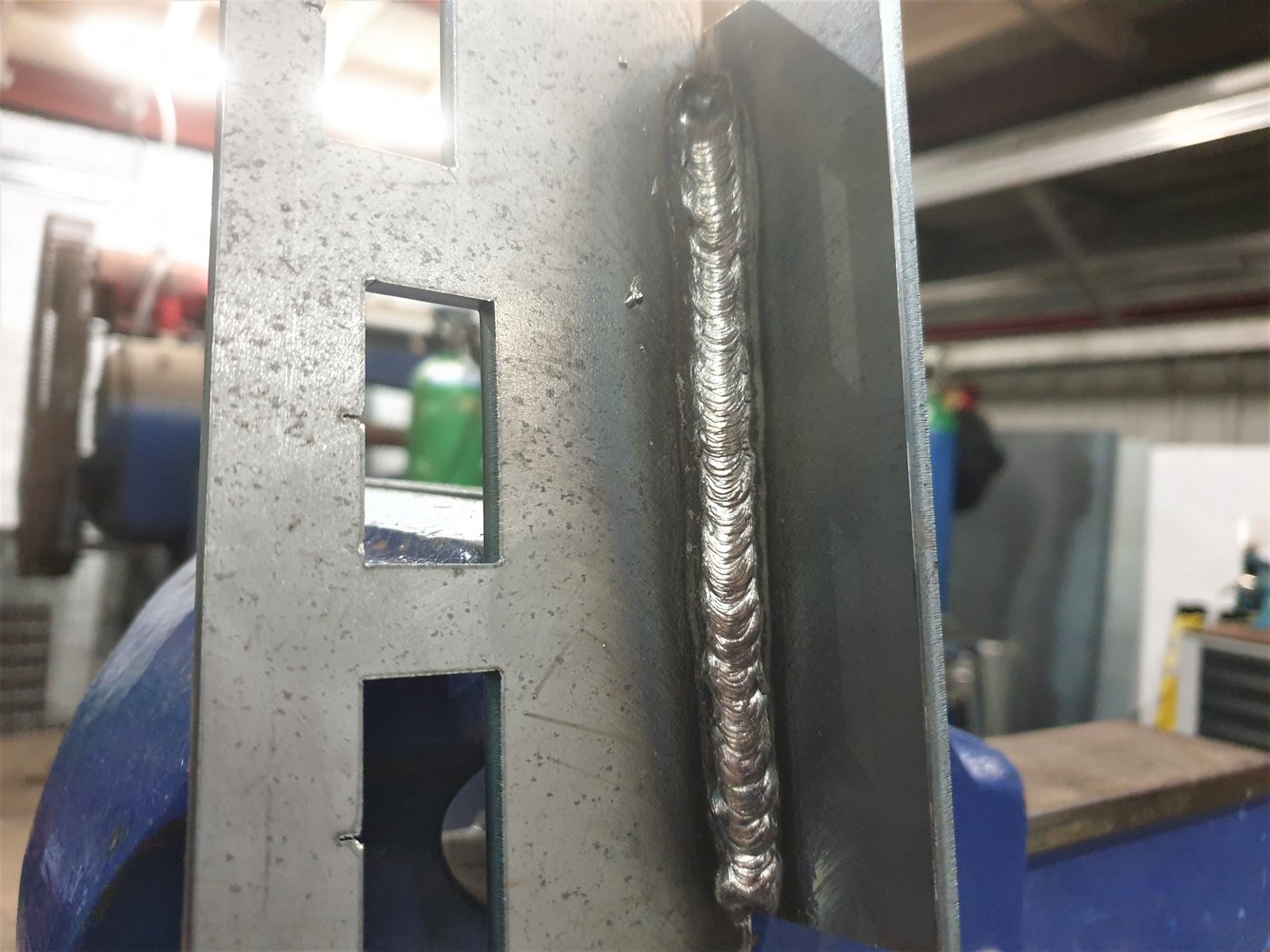

So i had a few hours with it last night. Now I predominantly TIG weld stainless, and even though it isn't a "proper" TIG set with HF start and gas control, I was interested in the TIG features.

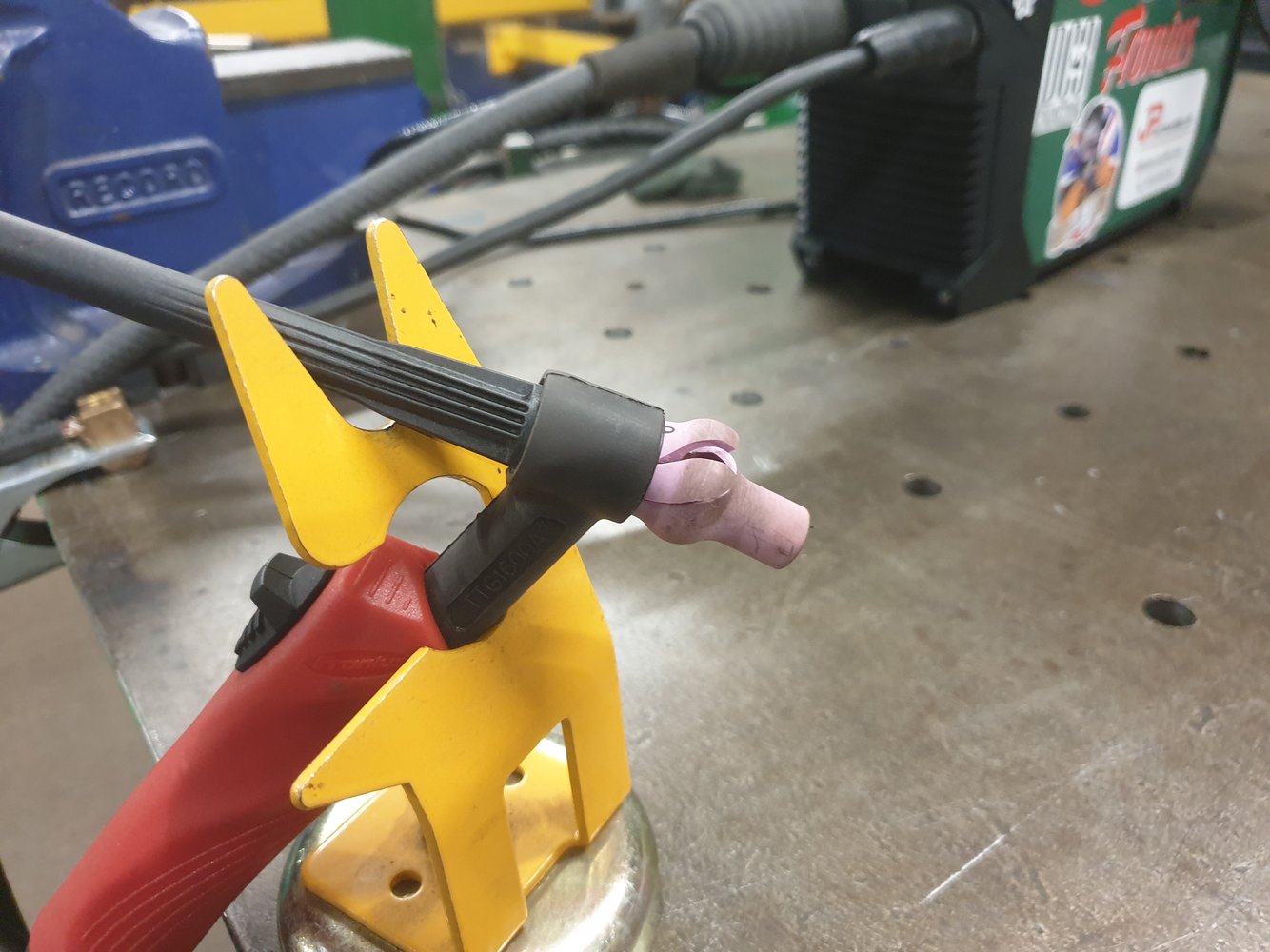

The supplied Fronius valved torch is actually great. It's ergonomic, stays cool, and the slide gas valve is way better than the turny-knob type. If it had conventional Binzel/CK style consumables, it would be perfect, but the Fronius style ones work well enough.

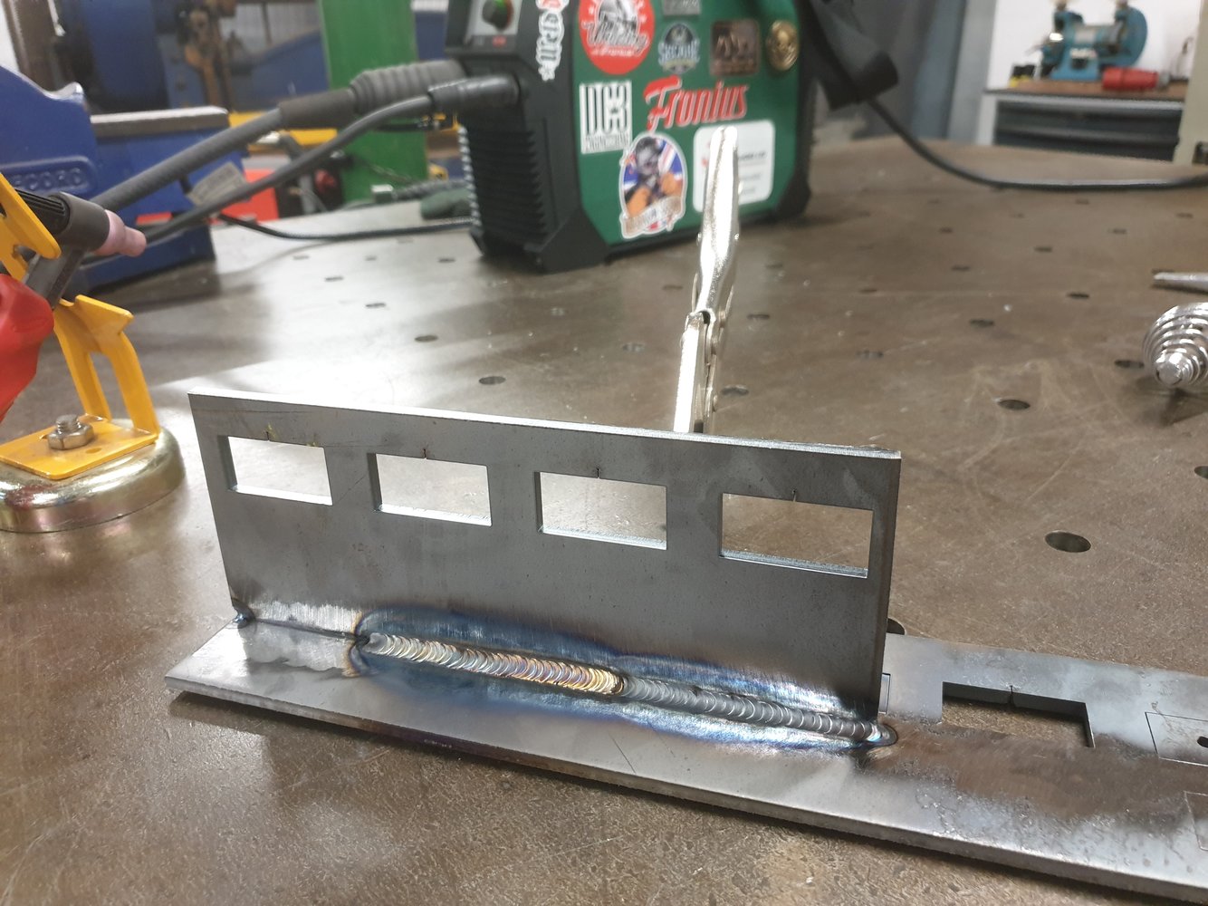

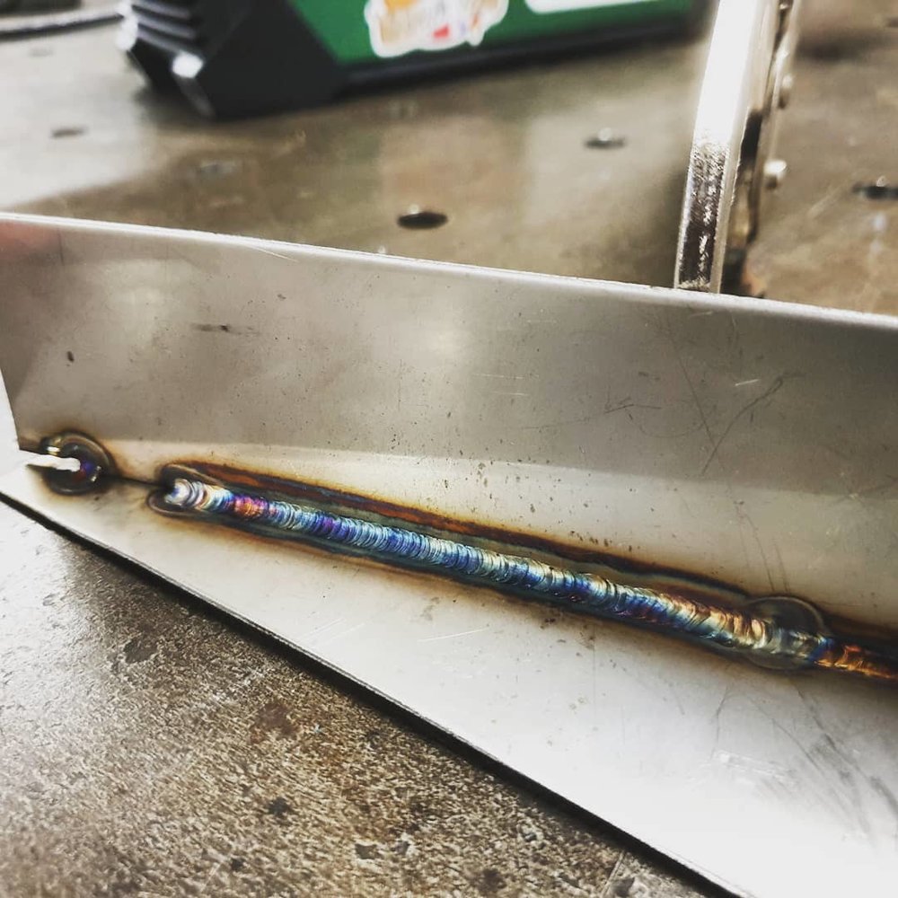

1.6mm stainless butt weld with a pulse - started at 2hz slow pulse, and then ramped it up to its max of 100hz for the rest of the seam. Seemed to give good results!

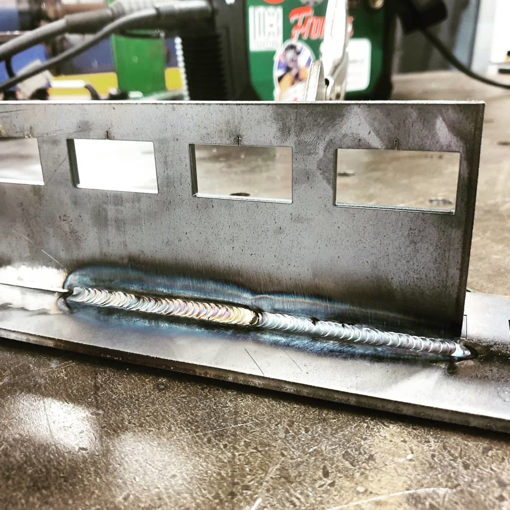

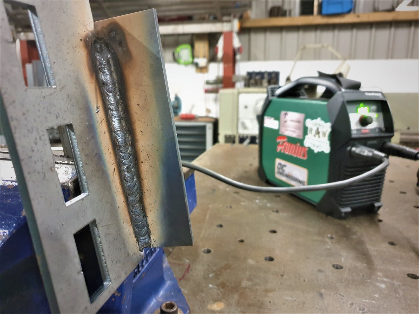

Got some 6mm offcuts and ran some straight DC at max 150 amps, some straight steel filler and also some inconel filler I had, just to play with it. It doesn't quite have the amps to do this properly, but was still fun.
The fan didn't even come on until I was nearly finished this.
I did a second run over the top, again just having a play around, unfortunately, the fancy Fronius style ceramic shattered on me mid weld! i don't have a spare, so that's the end of the TIG play time.

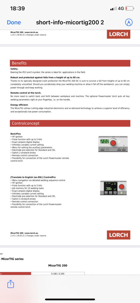

I like this machine. I'm biased towards Lorch, just because I know and love their machines, but I think Fronius, Lorch and EWM are probably top of the pile in the welding world today.
There's been some serious thought put into the design of this thing. It has the TAC feature, where you can set a pulse for a set time period at the start of arcing up, just to tack things. Something that I personally would use. It has a nice usable range of basic TIG pulsing, suitable for thin metals. It has adjustable soft-start, with a ramp-up.
It has the Comfort stop feature, where you're supposed to be able to long-arc, close it up, and the machine will slope down and end the arc for you. Unfortunately I couldn't get it to work at all, even with adjusting its sensitivity.
Instead, it has the next best thing: adjustable Break Voltage cut-off. Basically, you can long-arc and the machine will end the arc for you at a preset arc length.
This is way better than most of these type of sets, where you usually have a huge flare-up and arc strikes as you pull away to end the arc. As you can see from the stainless - no oxides at the end of the weld. A slope down would be better (if the Comfort Stop worked), but it IS still just a stick welder, after all.
Lots of stuff is adjustable in the menu structure, though. Enough stuff that I had to check all the values were as factory-set. The manual doesn't actually describe them all, it doesn't mention the TAC or pulse feature at all. But it's all more or less self explanatory.... and the ones that aren't, I leave alone!

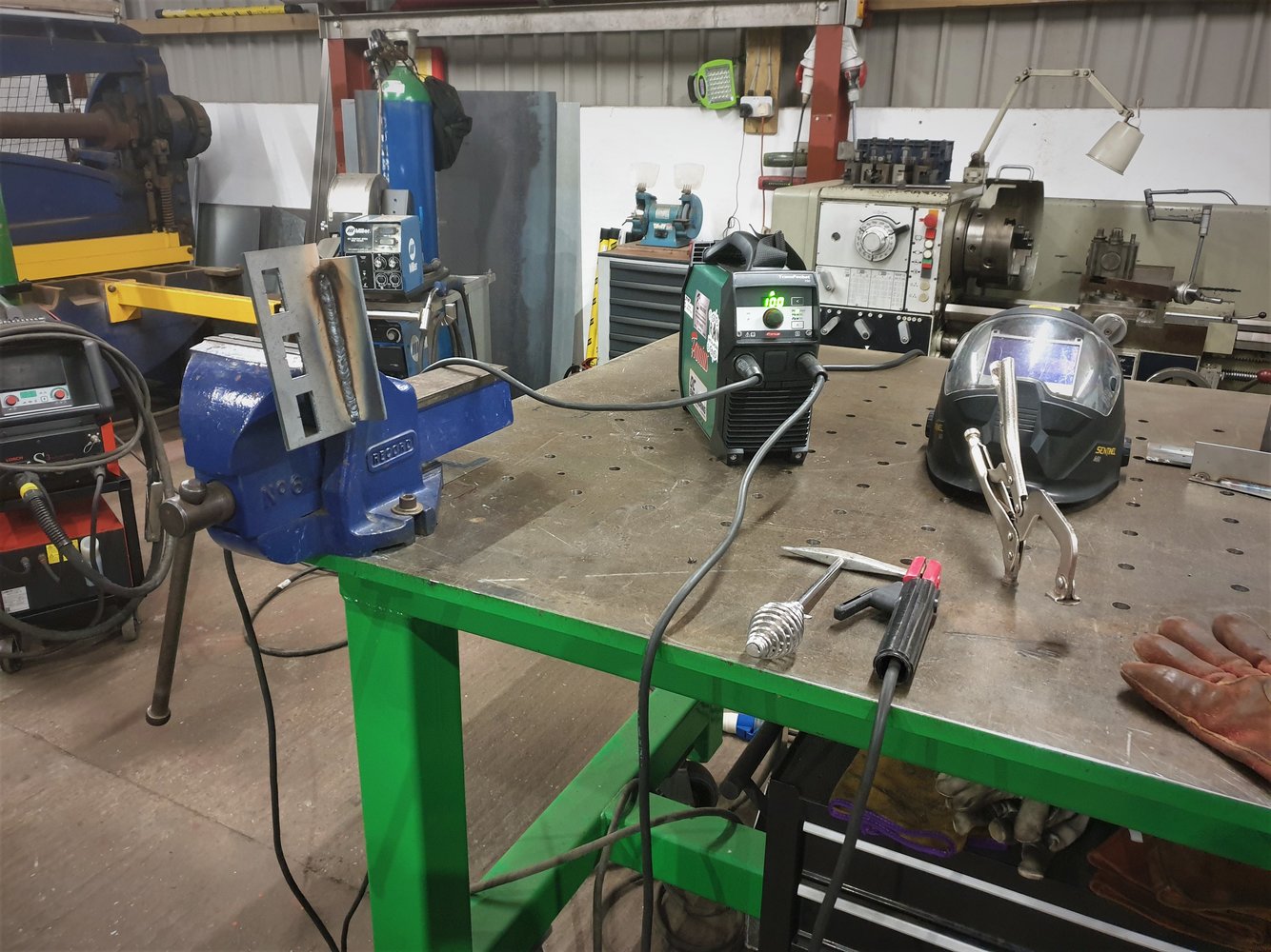

I could actually use this thing for site work and not hate it - unlike the other lift-arc setups I've tried. I've hated them all.
Yes i would like to win this, it's £700+ of highly desirable welding machine.
I'll do some actual stick welding later in the week...
