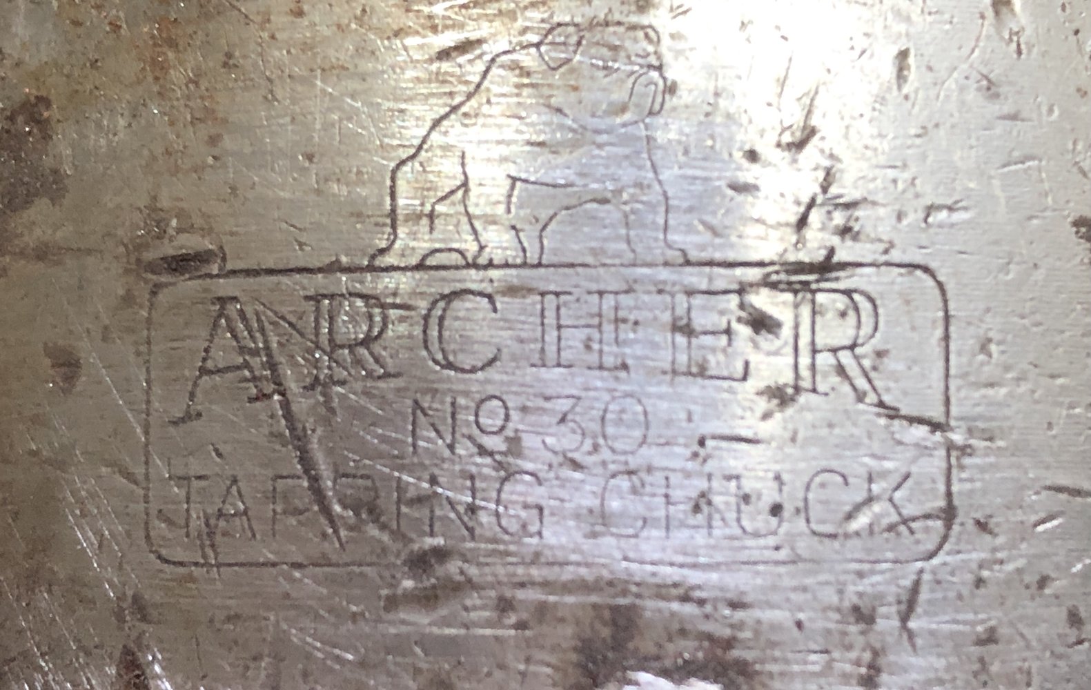

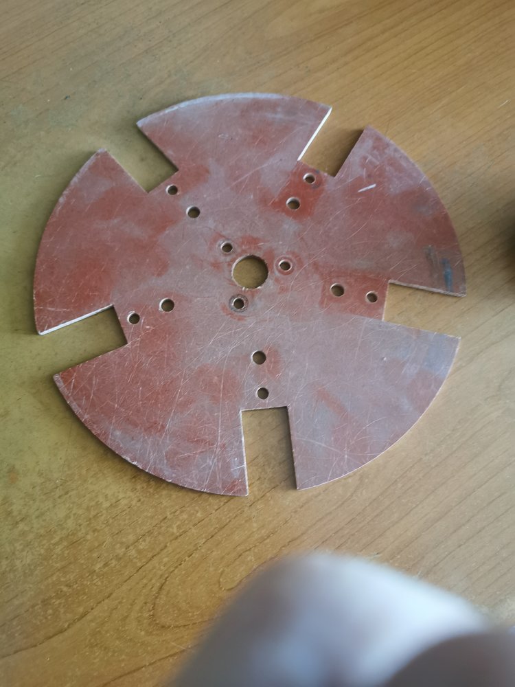

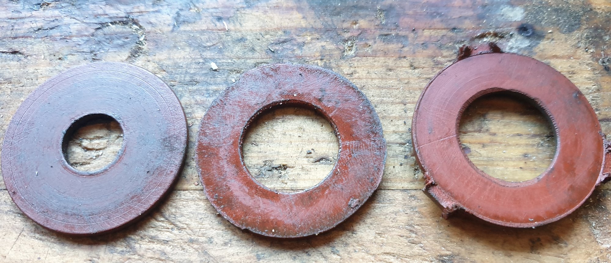

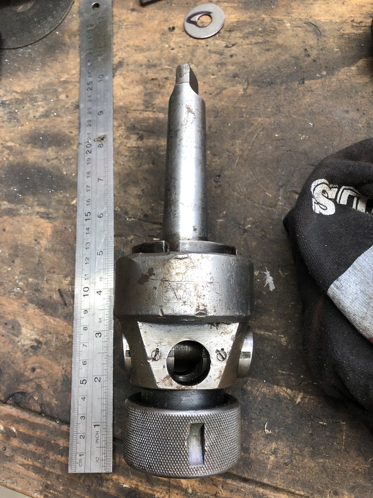

I need some friction material to make three discs for an Archer tapping head. I need 1.9" o.d. and 0.1" thickness, although a shade thicker wouldn't be a problem.
Does anyone have anything suitable or know of somewhere I can source some cheap offcuts?
The middle disc should have ears, too. They're also badly contaminated with grease. I had to use a 3" cheater on the C spanner when I came to undo the clutch.
There should be two C spanners I believe.
