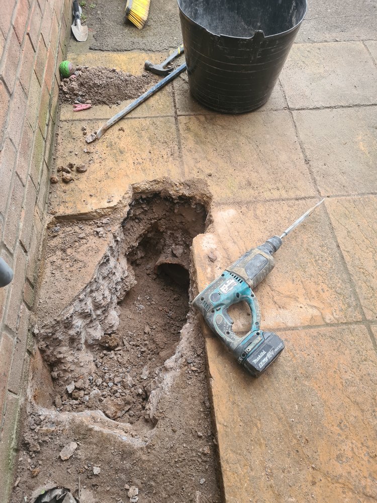

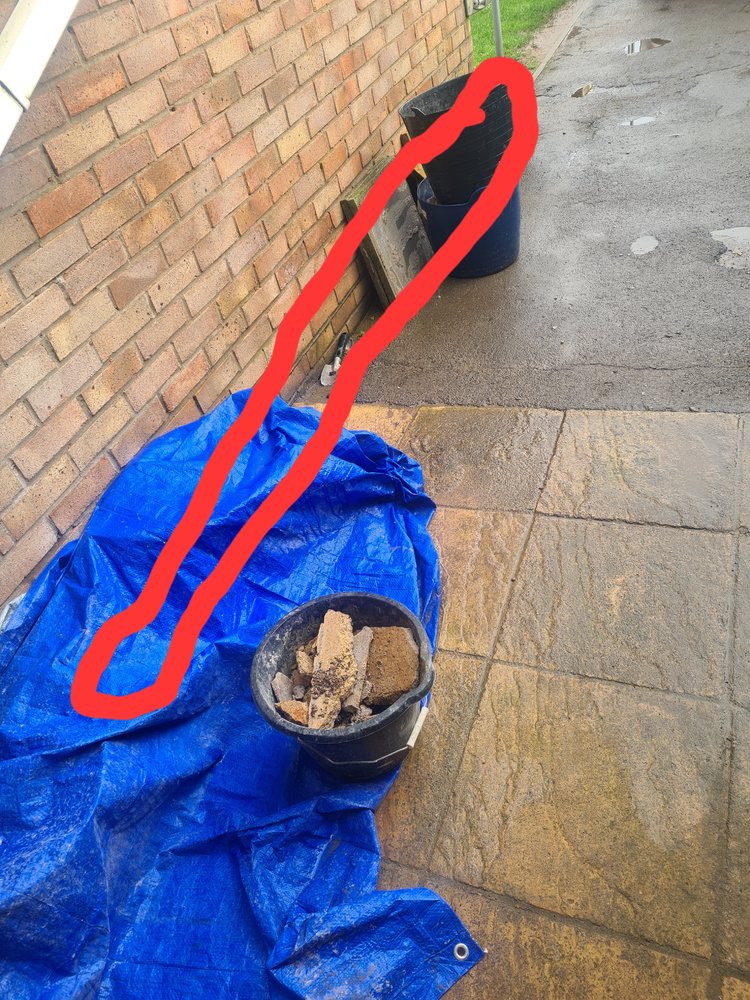

Ok so looking at my drain that was going to the soakaway it was regularly over flowing when heavy rain falls I found the drain was filled with a cement type substance very hard so assuming when someone had layed the patio stones they mostly filled the drain hole
I'm thinking of putting in a access hole so when the drive is done I can install some drive way drainage thr plan is block paving I expect

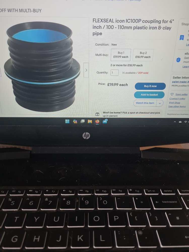

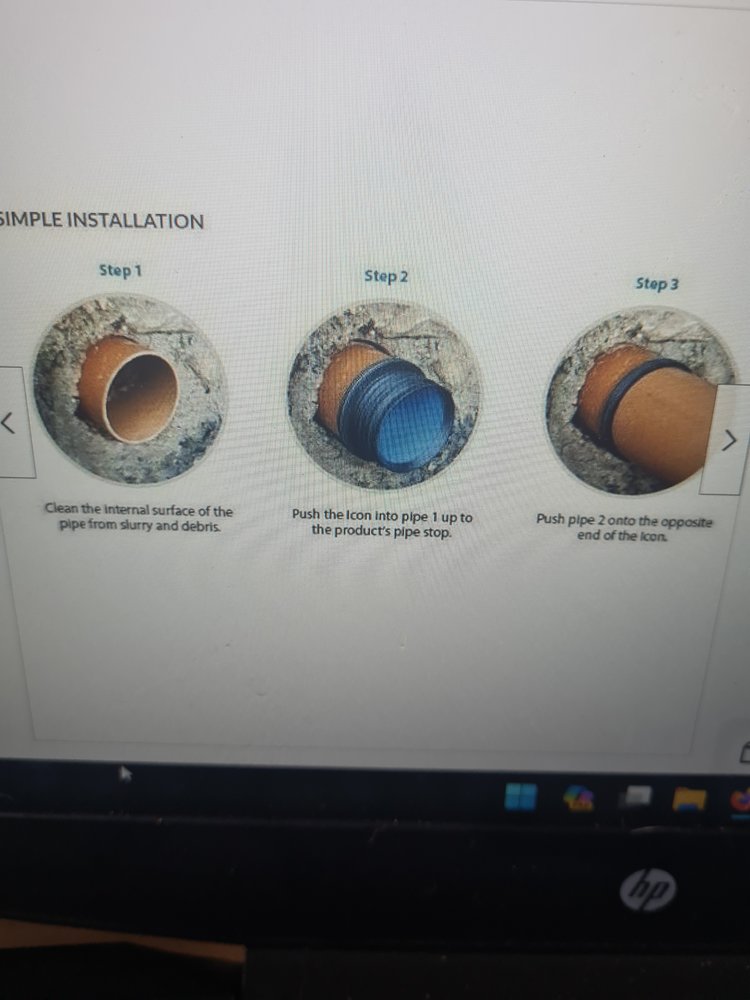

I'm thinking to use this
unless the cement starts getting very easy to break at the momnet getting a good end to attach a rubber seal version is very hit and miss when I get any where near a good point the pipe chips and I have to dig deeper and keep going
