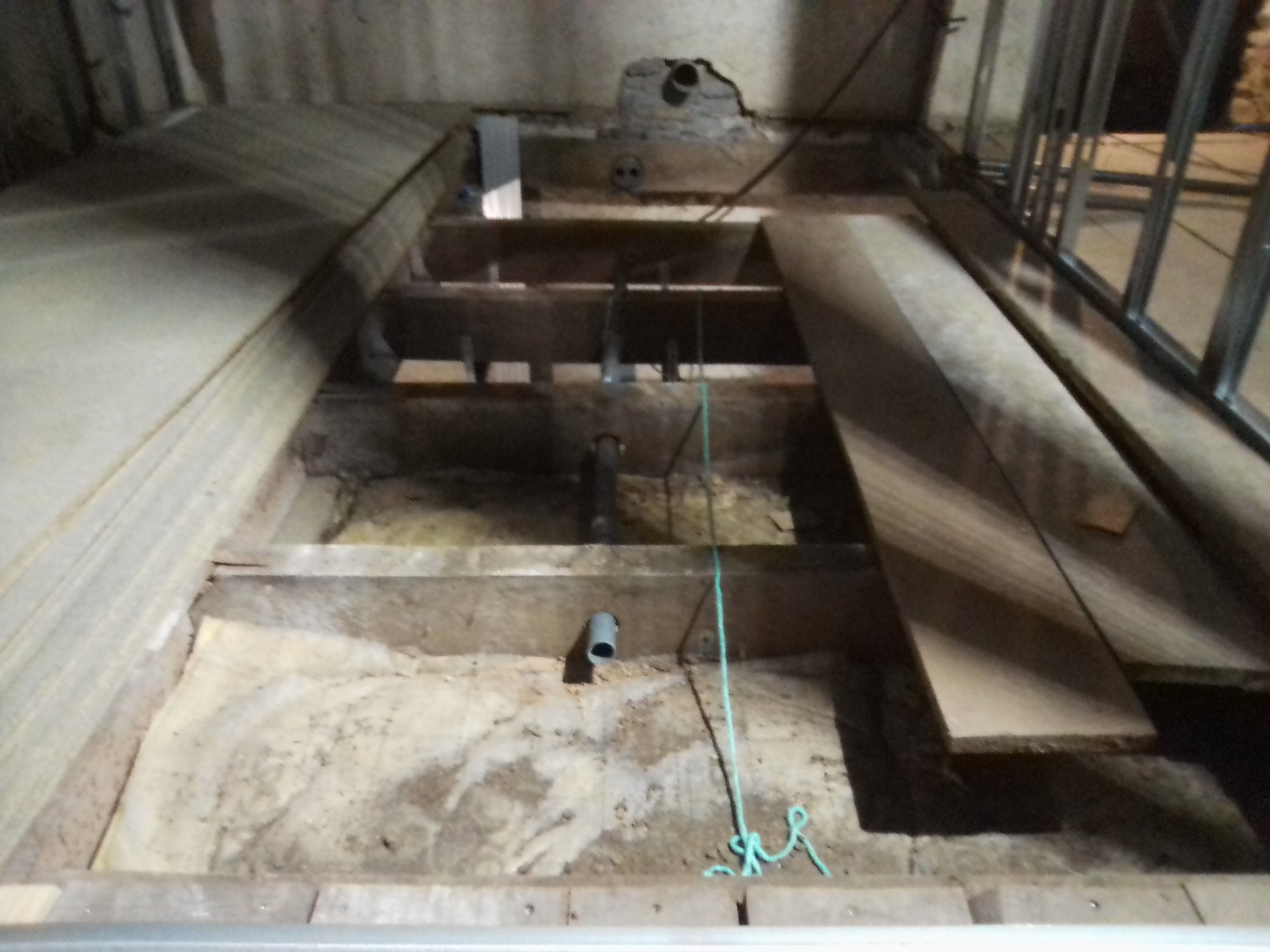

I would go the Polyester/GRP route for the bathroom, with an extra coat of epoxy( or flowcoat?) to ensure water proofing. Like you, I do some boat work and am comfortable with it. Substrate of water proof chipboard or ply. The fun is getting the falls right and better to a centre drain, as any failure is likely to be round the edges

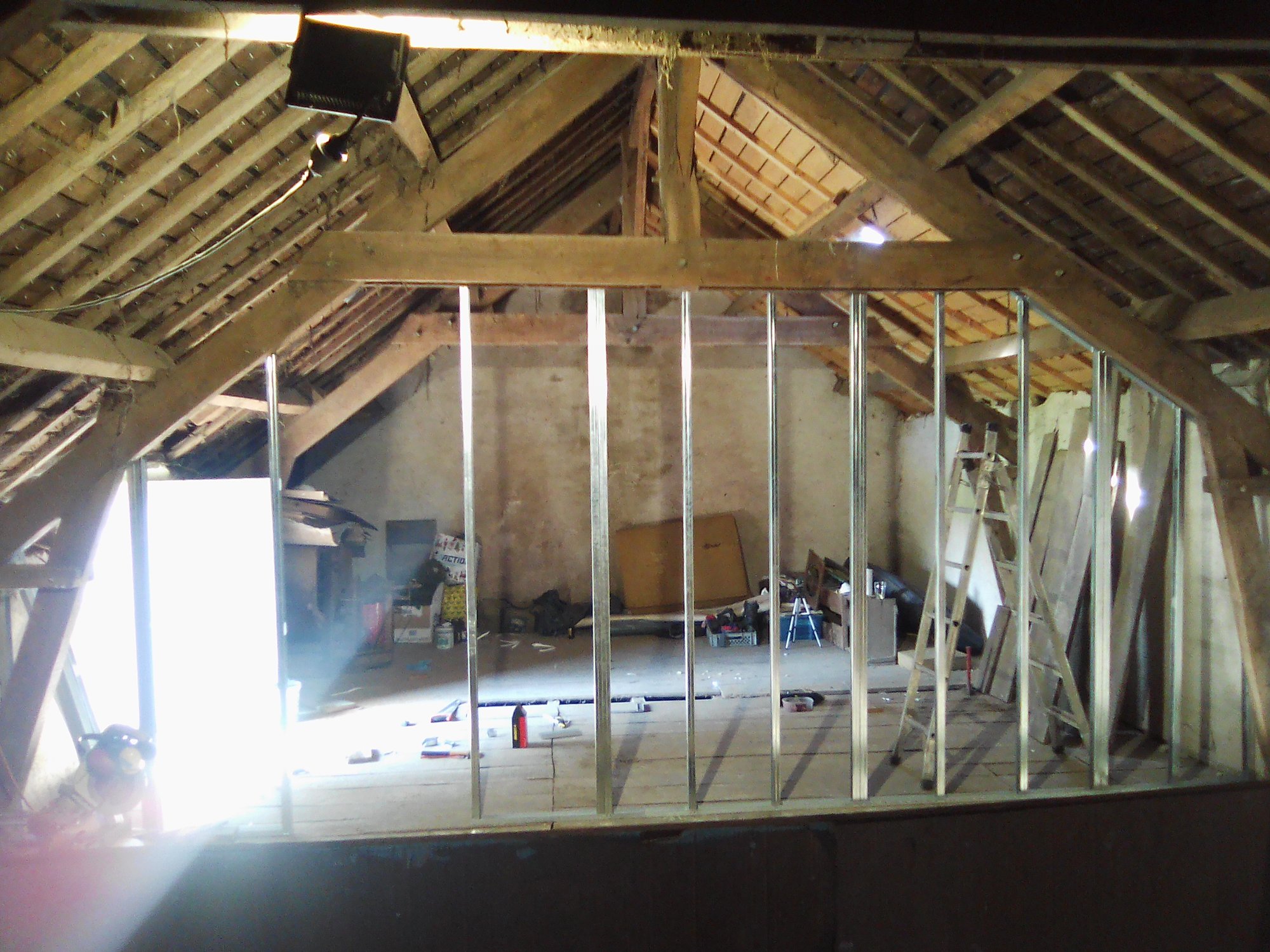

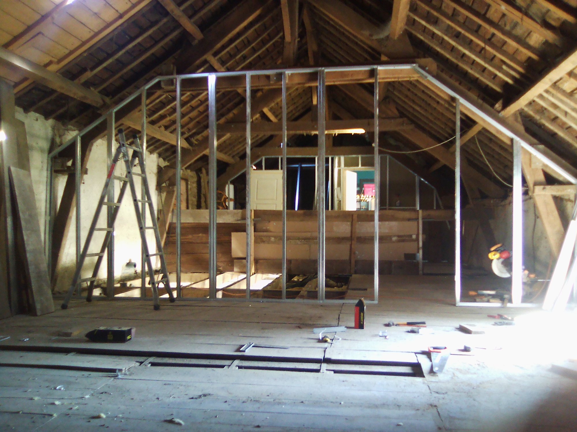

Since then, converted the loft for bedrooms and knocked out partions below for a decent dining room and study. Converted the small barn into a gîte, which is rented out. Some of the internal walls were thin brick, that with plaster and paper, were only 50mm thick. Compared to the outside and the main inside walls of 60cm stone.
New drainage system was quite a project as they considered it three dwellings, so big tanks and a 50sq mt drainage field. Did all the work myself, except for the big digging. Our ground is quite rocky, so a rented mini digger was not going to do it for near 100 cu mts of holes.

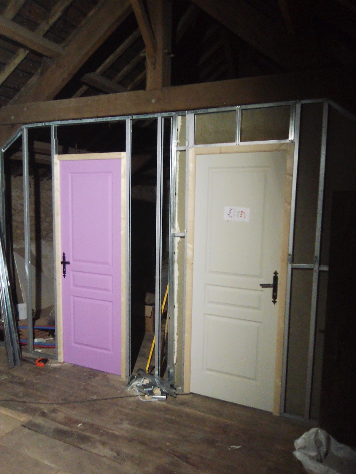

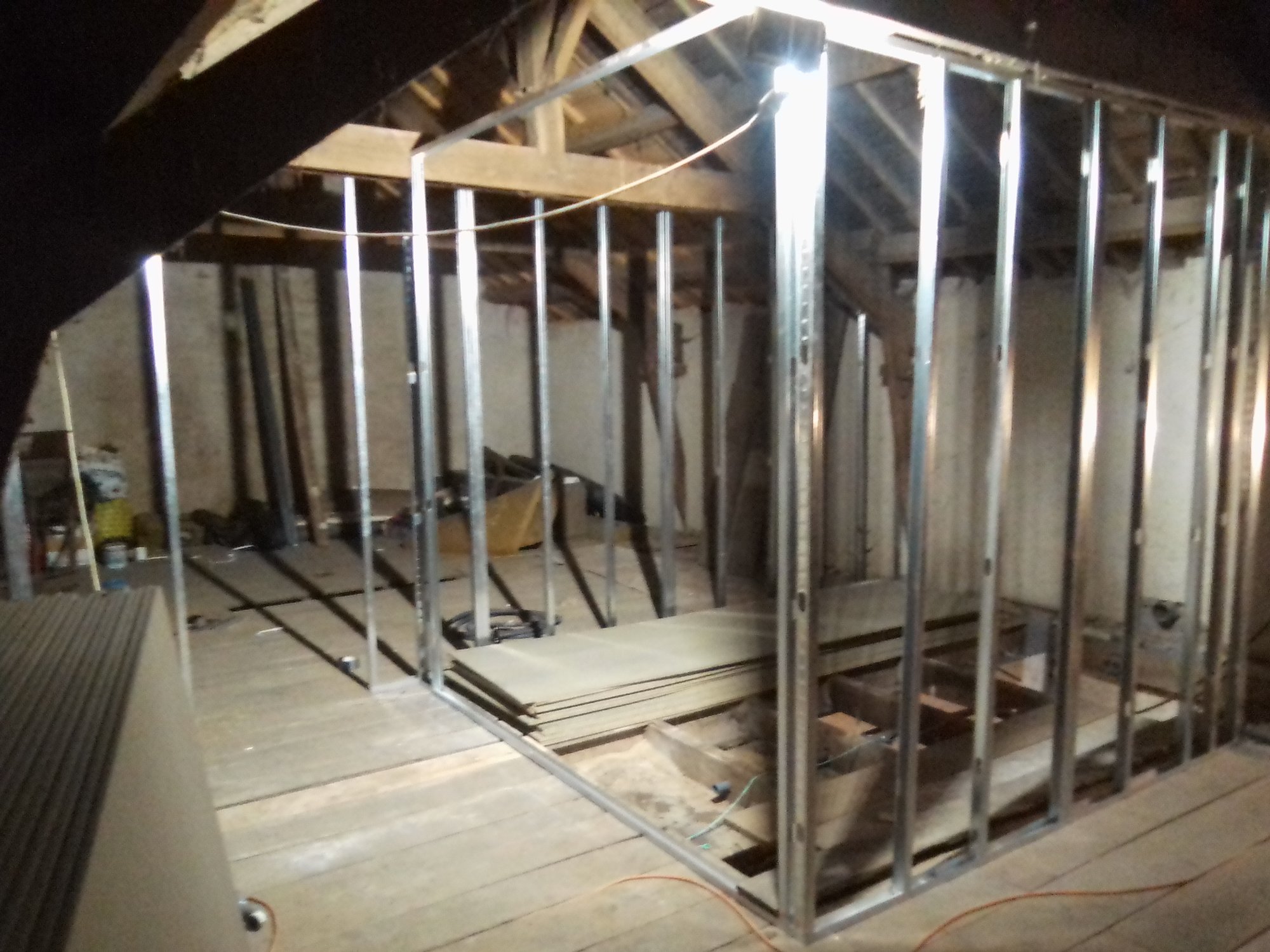

Still plugging on with the loft at the far end, two more bedrooms and another shower-room/WC, which makes four in the main house. Never ends
