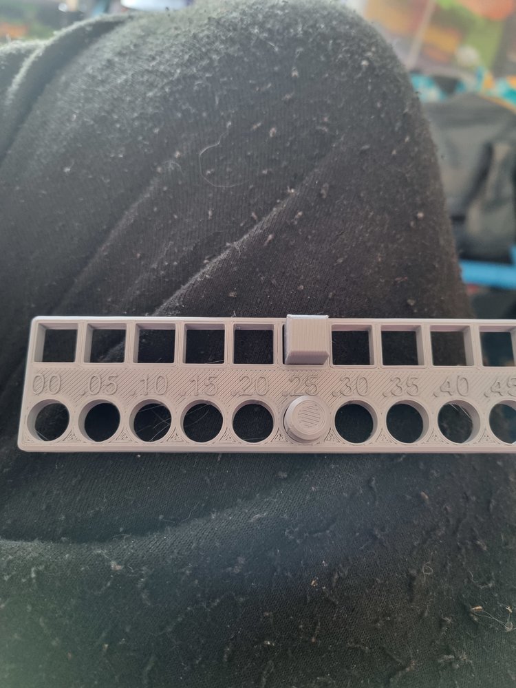

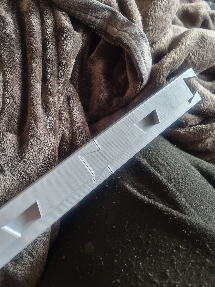

Ok cool. I have printed the small tolerance test you linked to. So that might help. There are a couple of things to make it perfect.

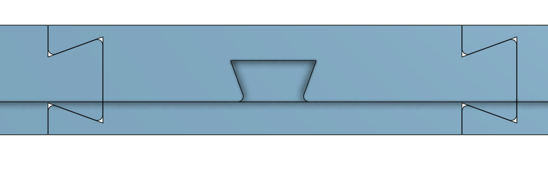

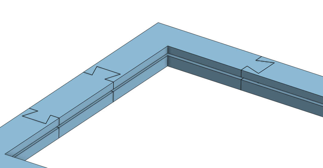

Most important one is to reduce the inside dovetail as currently after printing they don't fit together.

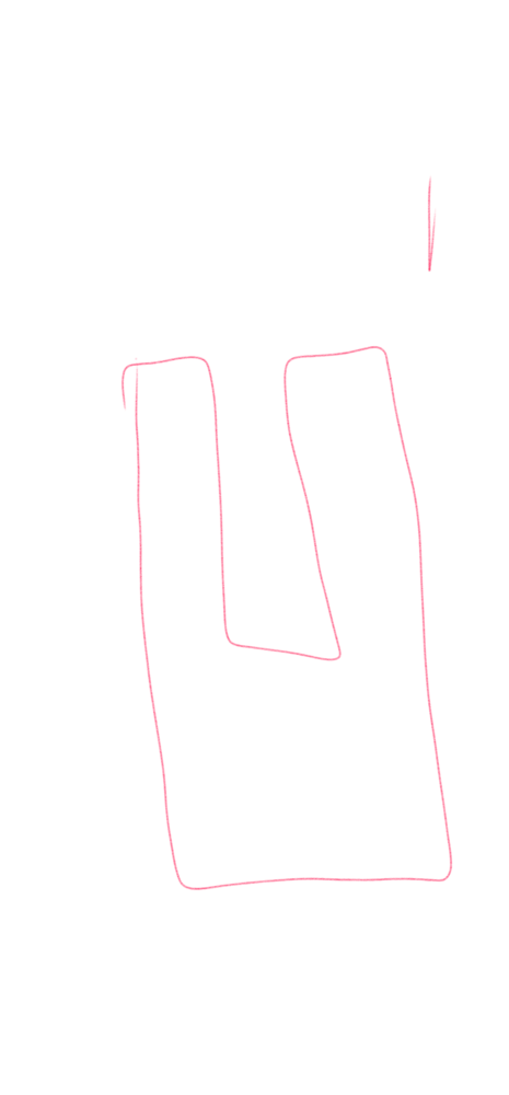

The other one is where there is a ledge internally it would be nice if that were a slot to fit the honeycomb steel mesh. 3mm wide same depth as the ledge.
I will try and draw what I mean soon.
