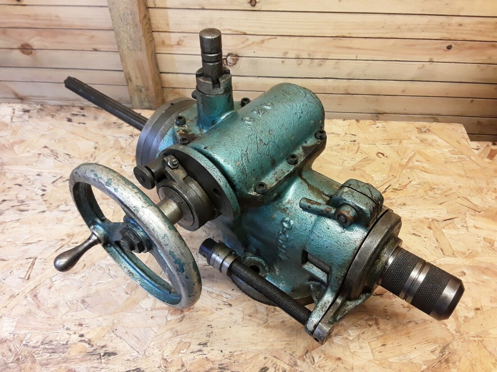

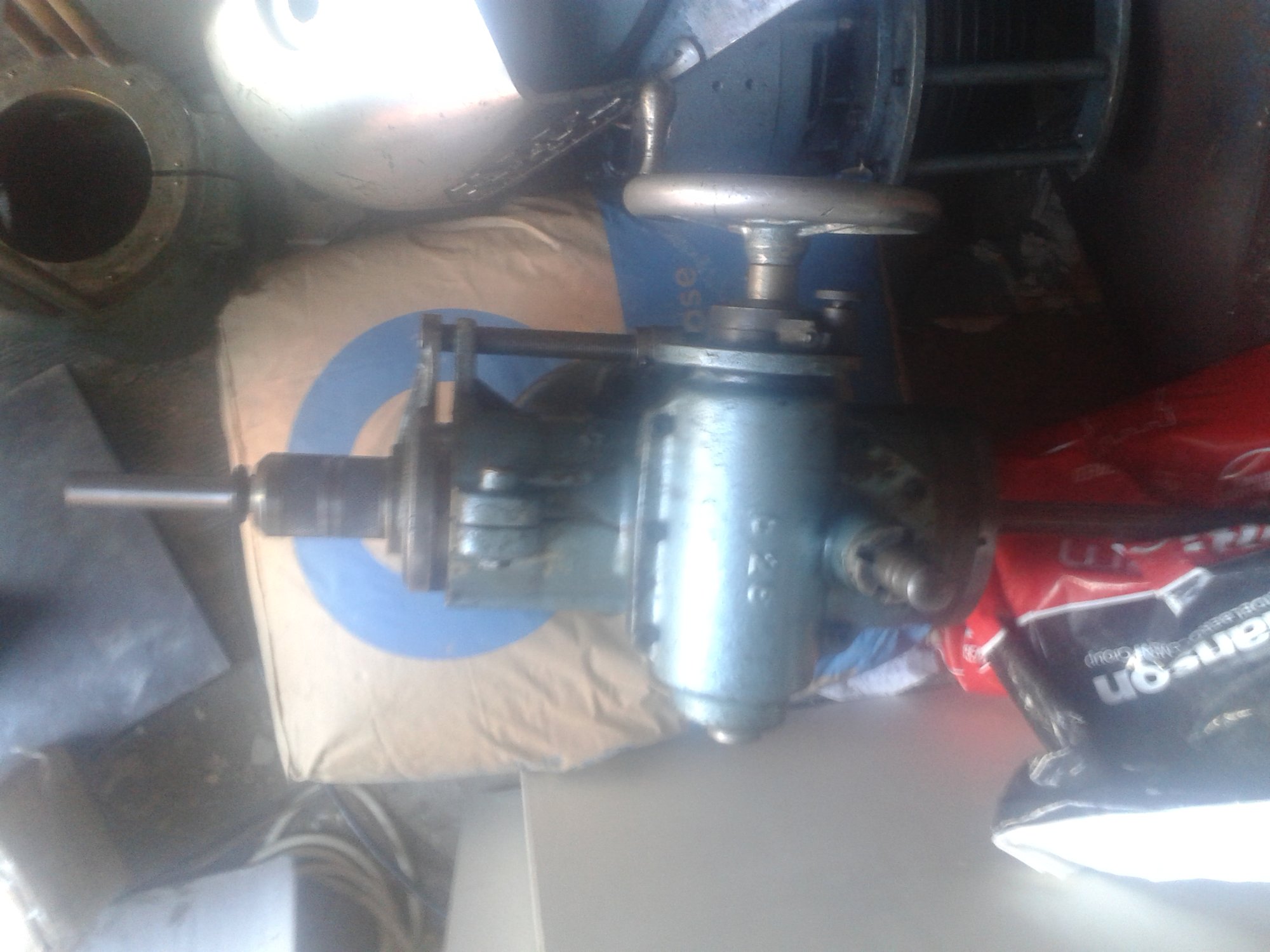

I bought this
I believe it to be a 2mt taper as i have them and have tried to fit them into it

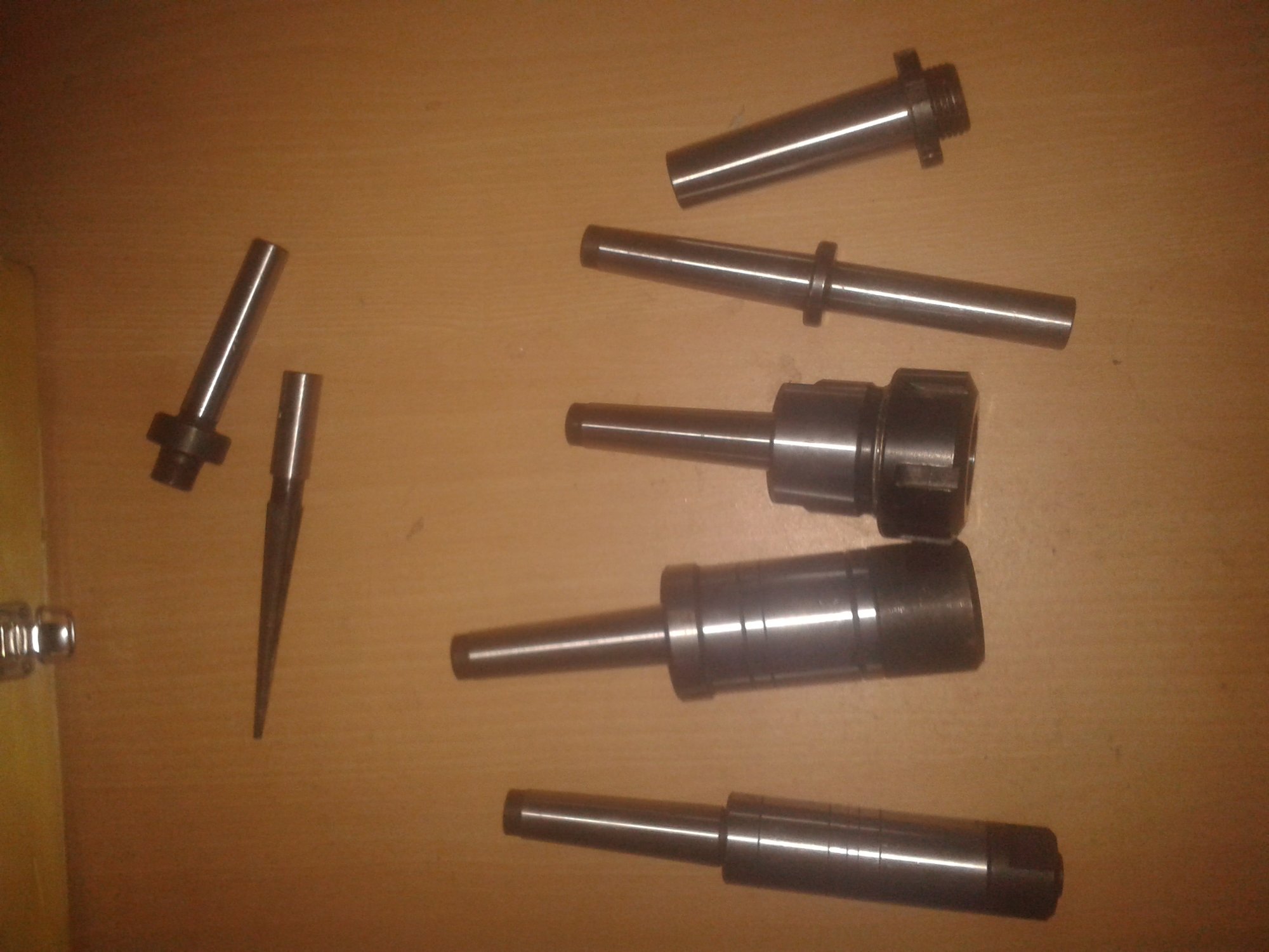

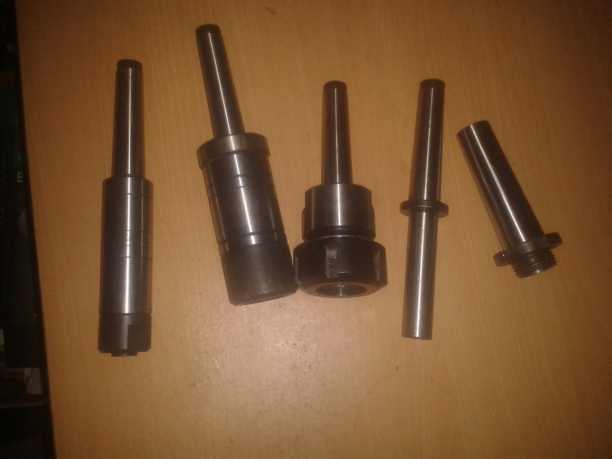

i bought these a while ago as i was undecided on which type i was after they are 2mt
the right end one appears to be a 3mt to a 2mt adapter

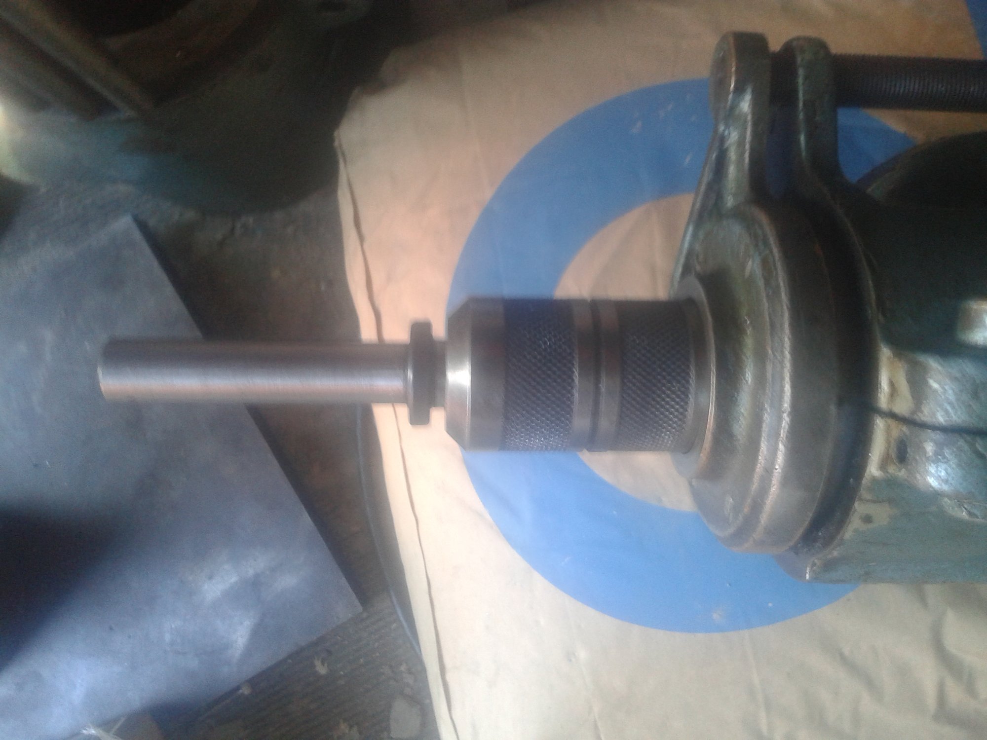

a straight shank test 2mt it fits nice and snug no wobble on it from the rear feels nice and solid

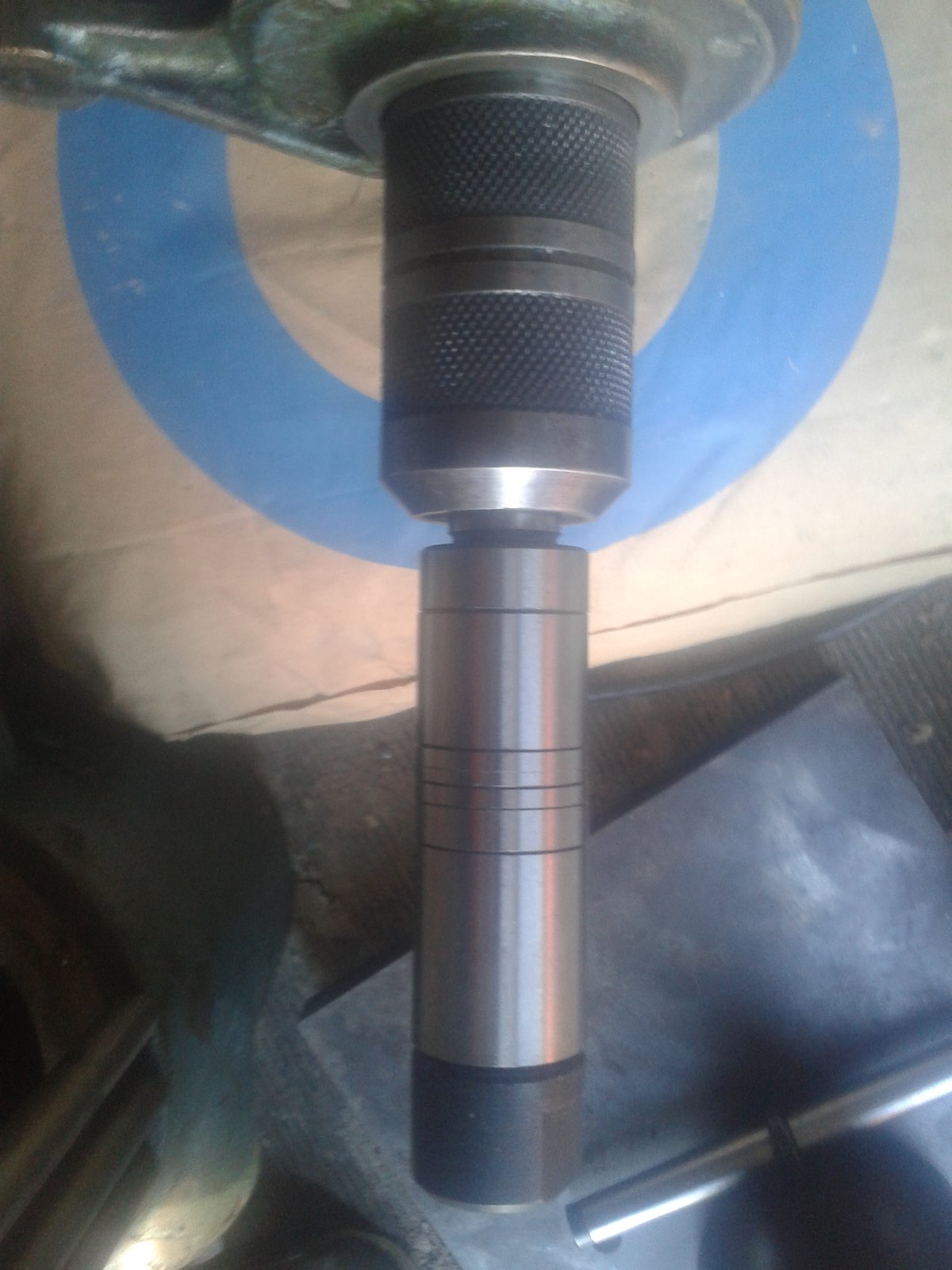

2mt milling cutter arbor
does it look like i have the 2mt model of the frays milling machine id expect the other type b&s no 7 to make the 2mt stick out further than whats with the pics
http://vintagemachinery.org/pubs/2216/24082.pdf
