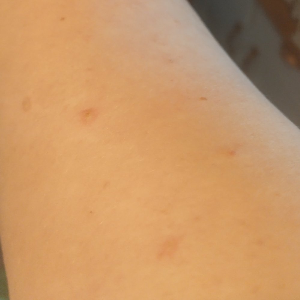

I do however have multiple little blisters on my arms from the intense heat of the metal transfering through the fabric, so they're not magic...
Nasty looking but painless... and a hell of a lot better than digging blobs of metal out of my skin with tweezers and iodine.
With a cotton shirt underneath I would likely have come out unharmed, with the overalls non the worse for wear... Impressive!
