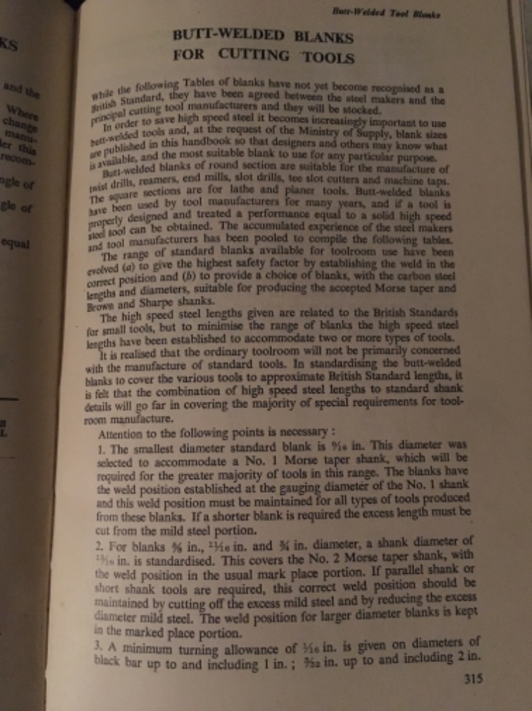

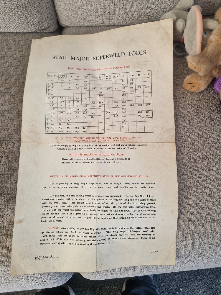

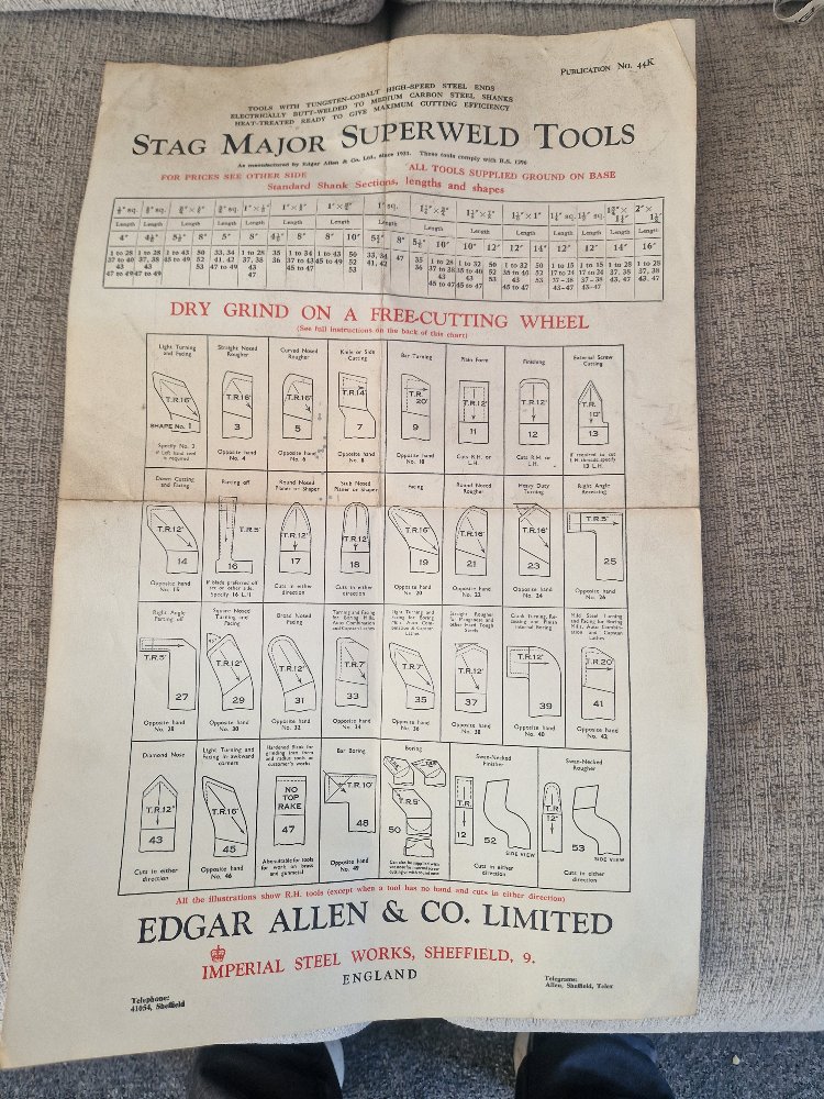

thought the forum may appreciate...tool prices from an undetermined year

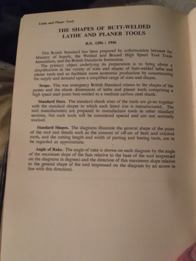

Interesting. I have never seen lathe tools that are flash butt welded HSS onto plain shanks before.
Seeing how drill shanks are made that way, it is a natural progression, why they never caught
on around here is a mystery.
Tool steel has moved on quite a bit with time, especially when we transitioned from T to M grades.You should keep that and wave it around when people insist it is OK to grind HSS and then plunge into water to cool. If they persist, send them a framed copy.
