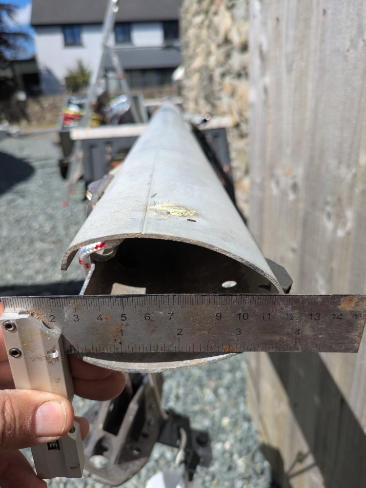

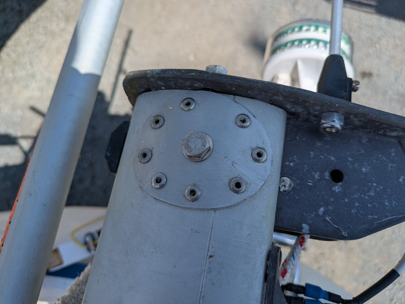

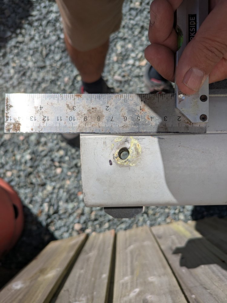

Hi, I have an aluminium boat mast with a bolt hole that has some cracks coming from it. I would like to rivet a doubler plate around the hole to strengthen it. I've attached a couple of pictures of the job to give an idea of what I'm trying to do.
My first question is what type of aluminium to use? The mast is 2mm thick. It's 40 years old and I don't know what flavour of aluminium alloy it is. The internet tells me that modern boat masts are commonly made of 6061 T6 sheet. However this type of sheet is tempered which makes it more difficult to cold form, which I think I will have to do to get it close to the curvature of the mast before riveting. Will I be able to form T6 sheet to the curve in the pic or am I better of going with a more malleable grade of aluminium and sacrificing some strength?
My second question is how best to form the sheet to the curvature of the mast. At the moment I'm thinking of creating the mast profile in wood, probably ply cut to shape and laminated, then forming the plate round it with a hammer.
