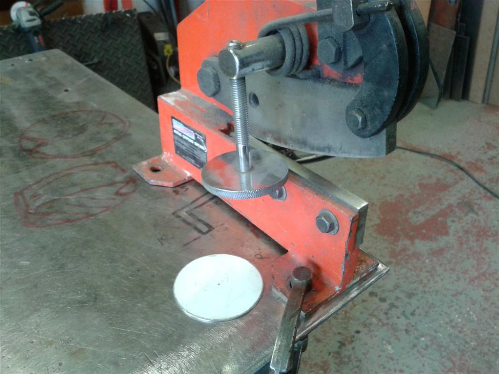

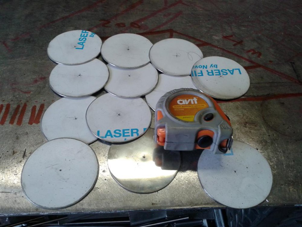

ahh so you never did it right thenHow coincidental is this then, had a call today could I make 12 off 3" x 1.5mm stainless discs to cap some barrier posts off, customer needed them straight away,
45 mins later had these on the bench, no lathes, laser cutters, plasma cutters, flycutters, or holesaws were involved,
Circular jig to hold blank whilst you nibble it round with the guillotine?With this, but for the 1mm ones mentioned in the original post it would be a 1 minute job even with hand snips.
No, thats the hold down foot to keep the material from kicking up as you use it, they were just marked out with dividers and cut to a line, the dot in the middle is deliberate, it will have a stud tacked on to string a chain between the posts, its for a barrier in a packaging factory.Circular jig to hold blank whilst you nibble it round with the guillotine?
