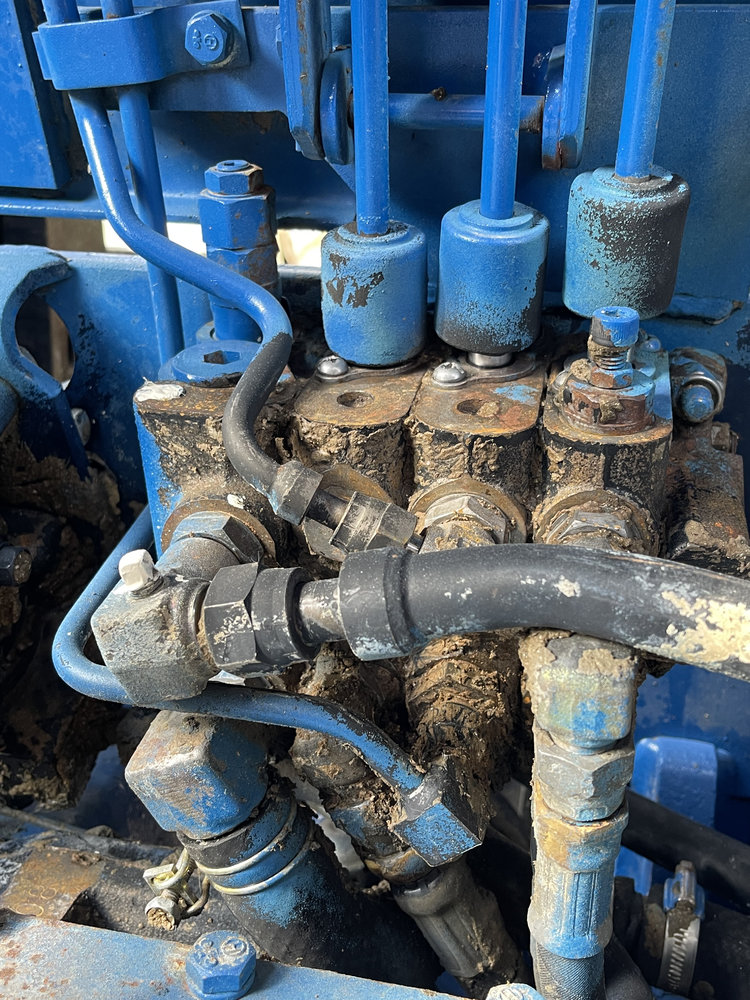

there are only 2 motions, lift and powered forward and backwards tilt to the mast which works almost from tickover even with a load.......the third one on the right is not connected.....
so my first guess was to blame the valve body.....I planed to switch pipes so that the lift motion would be where the tilt was but with metal pipes it aint gonna be easy.....

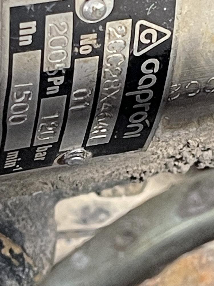

So now have details of the pump and as I understand it it delivers 120bar at 1500 rpm but I may be reading it wrong....?
I downloaded a PDF on the HYdraulics and nowhere does it give a working pressure....plus it says its a spur geared pump
I need a gauge as it's my next job after filling the tank again and with new filters .....when I buy the correct gauge...so am I correct at 120bar at 1500 rpm..should I get a 150bar gauge....?

the upper pipe/fitting on the left is the high press in and the lower pipe with a wire hose clip is the return to the tank.....
