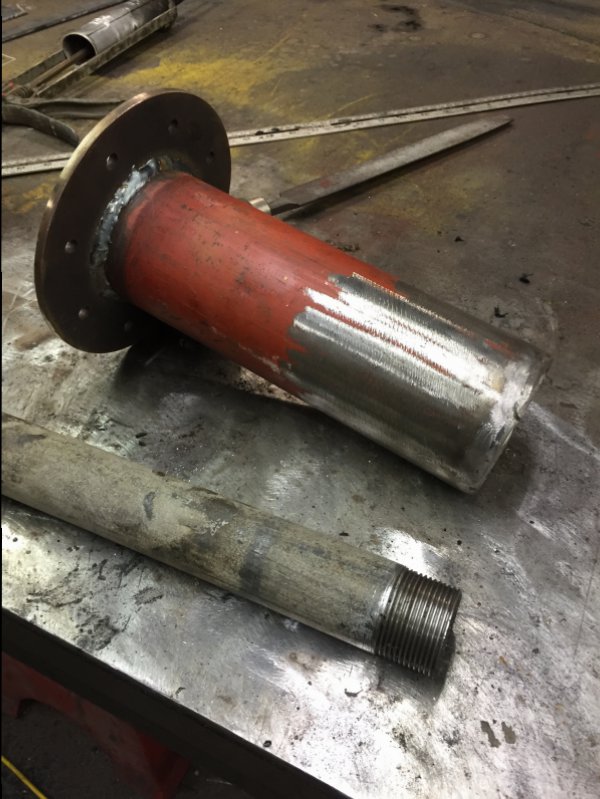

. Are you going to split the air pipe so some of the draft goes up the flue to encourage draw?
I think it helps to reduce smoke when the blowers not full on the tuyere for heating the work.

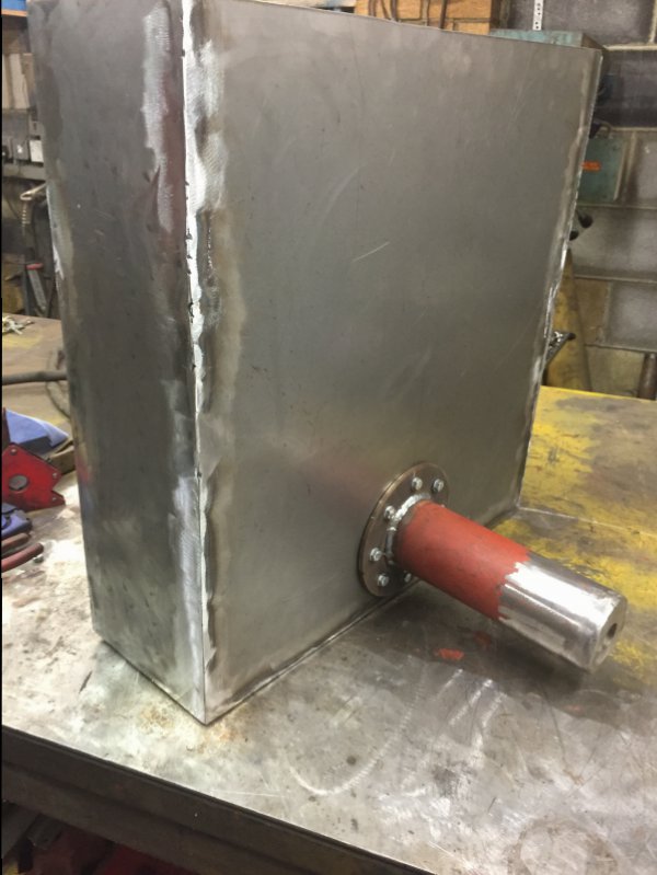

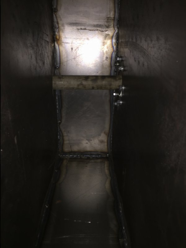

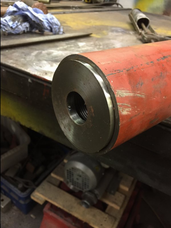

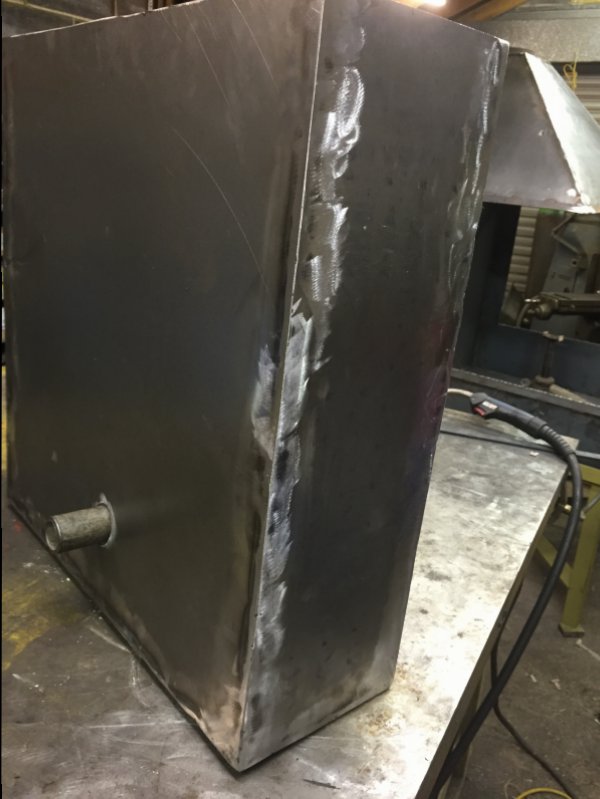

Sparkplug are you going to put a big bore sight glass in a protector case in the bosh tub ( water tank ) or use a copper ball cock float & painted rod through guide rings as a float indicator so you can always easily see how much water you have in the tank ?
Remember even though you have a water jacket , a good thick layer of fine ash over the to the fire pit stops the steel burning on the outside so makes it last much longer . Bring the fire a few inches forward of the tuyere nose also help keep the burning down.

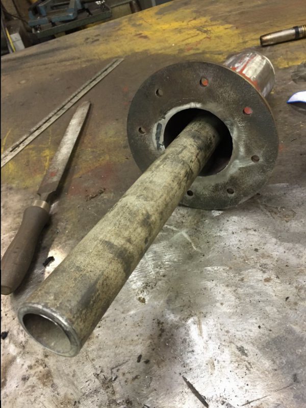

I do like that massive lump of metal you have for the nose ....lets hope the heat transfer to the water is good enough to stop it melting
