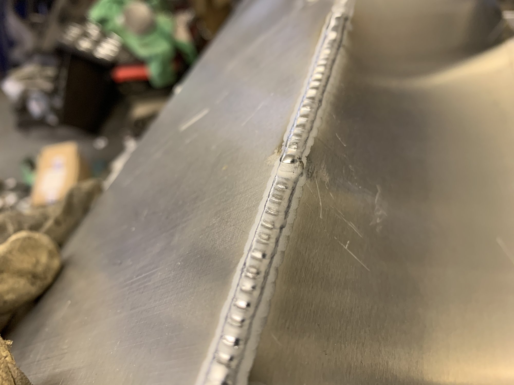

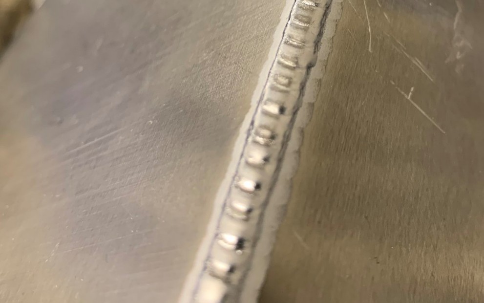

Looks like you may be a bit high on the balance, awful lot of cleaning action going on there.
With the balance set too high you get that crazing/crackled look to the aluminium and also the deposited metal. You should have a small amount of cleaning visible at the edge of the weld but the deposited metal itself should be shiny. I will look back and see if I still have a pic to show what I mean.
Regarding the integrity of the weld, it probably won't do much harm.
It is normal to have the band of cleaning down either side of the weld but as you can see in your picture the whole weld bead is actually covered in it as well. Unless it is some sort of illusion of the camera.

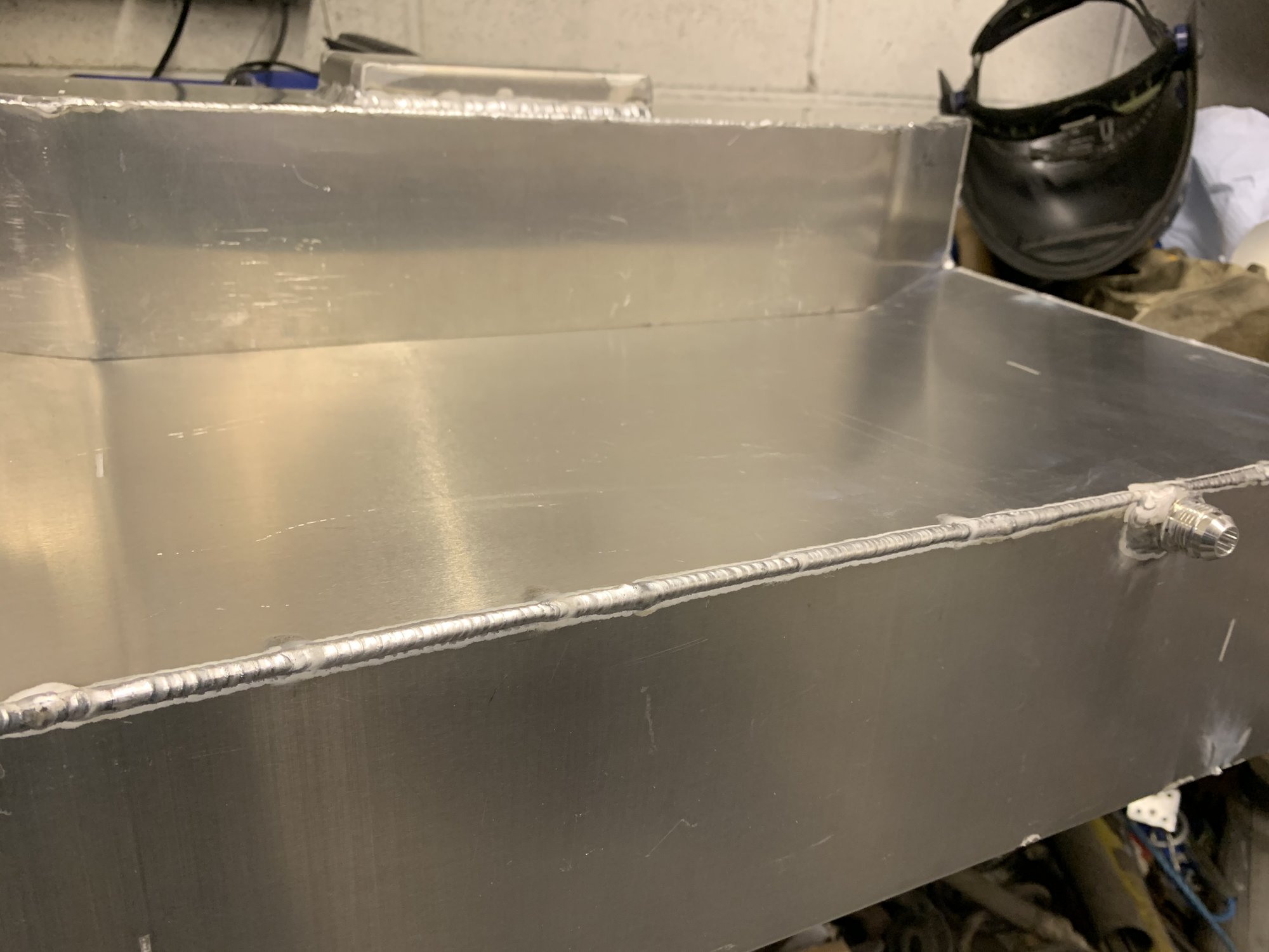

Coming along nicely, the laser cut tabs was a good shout. Not something I can do as I only have plasma and that is not really accurate enough for such things.
