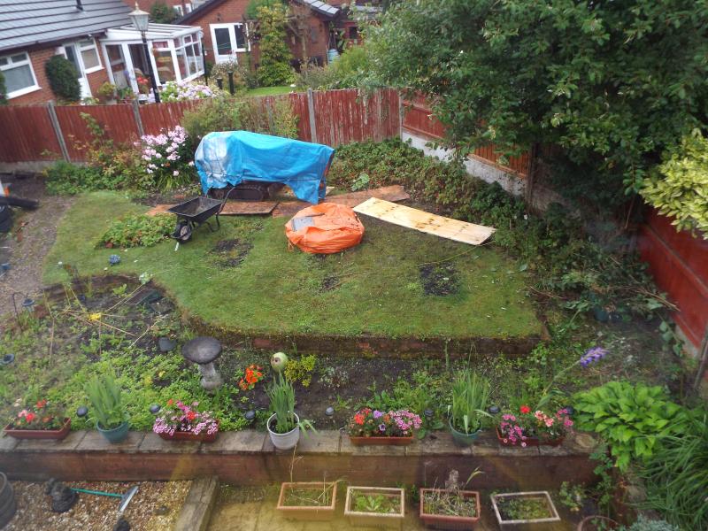

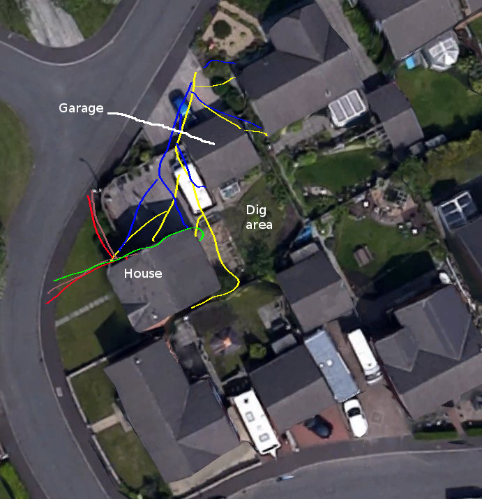

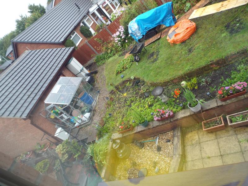

I have a fault on a buried cable i am tracing now cant find it with testing but its pulling a load after heavy rain.
