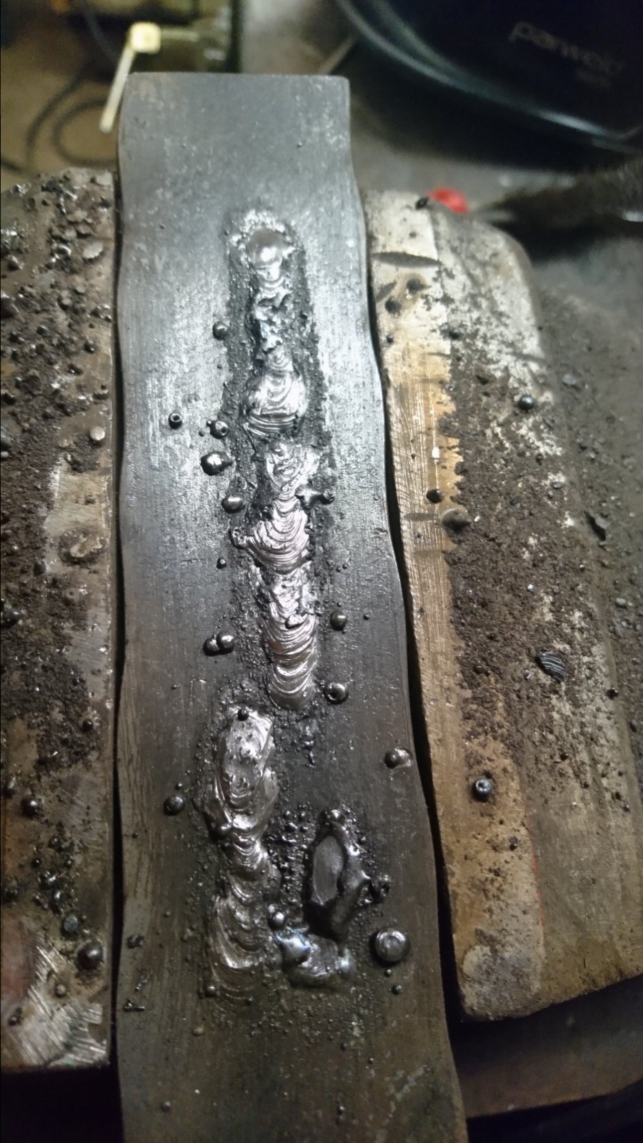

I've seen worse on paid workWell I tried to get one with surface Porosity visible. Spayed the black bar with oil got an old damp 6013, raised the power as high as 160 amps. Arc length was massive and had to keep up and downing it just to maintain it, coiled long leads up. Just can't re create it but it sure looks nasty View attachment 98852
