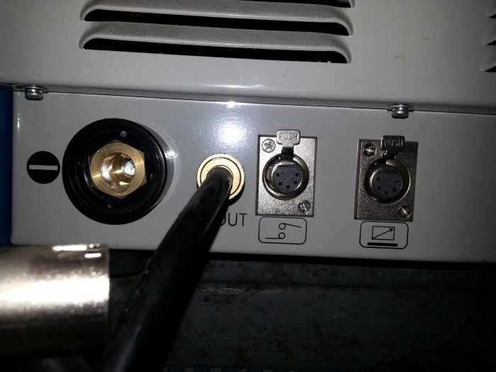

I am looking for a foot pedal for my tecarc 206i . It has 2 x 5 pin plugs one of which has the gun trigger in it at the moment . Not sure what I need at all .
Thanks in advance.
i have the same welder with the pedal yes it's a lot of money but it is well built.
It is possible to make your own or alter another pedal if the resistances are correct. As justmental said previously the TecArc pedal is expensive but well built, very smooth in operation. Weldequip stocks them here.
