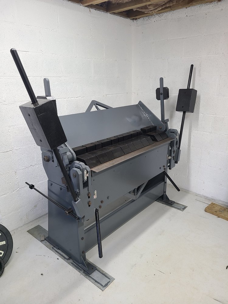

That looks hefty. I see there are 2 different styles of fingers. Mine are made of 16mm plate and are quite long. Your type are short and fat! I assume those fingers are heavier duty but more limited in what you can bend? Anyone know the different capabilities of the 2 different types?I folded around 7-800mm on my besco box and pan it was more of a deadlift, felt equivalent to around a 120-130kg lift plus it put a lot of strain on the fingers, I'd say 3mm 1050 grade would be doable over 4ft depending on how strong you are, View attachment 459809
