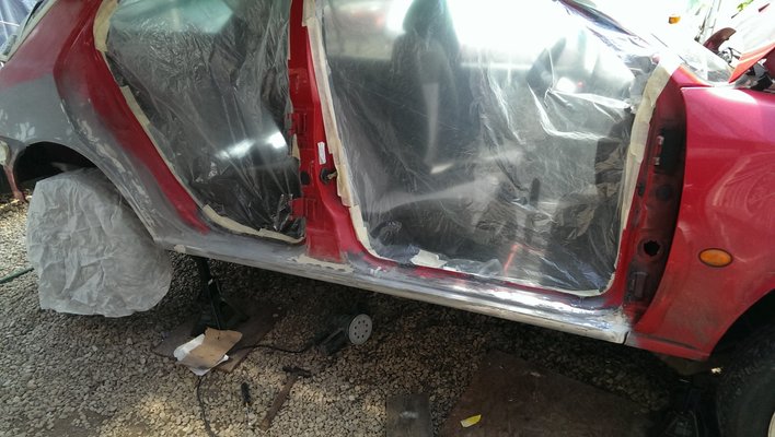

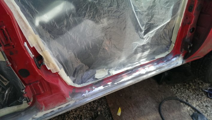

  20. visor_down
    visor_down Member
    Messages:
    324
    South East
    Good job you have done on that no small task once you get cutting!
    Have you lifted the door seal at the bottom of the door shuts ? They often rust there at the spot welds (although you may be lucky)
    I did exact same on my old fiesta had full sill but decided to cut it down and do full seam weld and leave the upper part alone, I just sanded it down and treated the rust....in hindsight I would fit the whole panel and spot/plug it along the top, like I say it rusts there and as you know it doesn't stop and soon eats into your nice new panel and hard work! Depends how far you want to go of course and how long you plan to keep it, looks like you have done a pretty comprehensive job so far though, so might be worth considering fitting the whole sill, although as you have found it would entail further repairs to inner sill and possibly floorpan to give you something decent to spot to.
