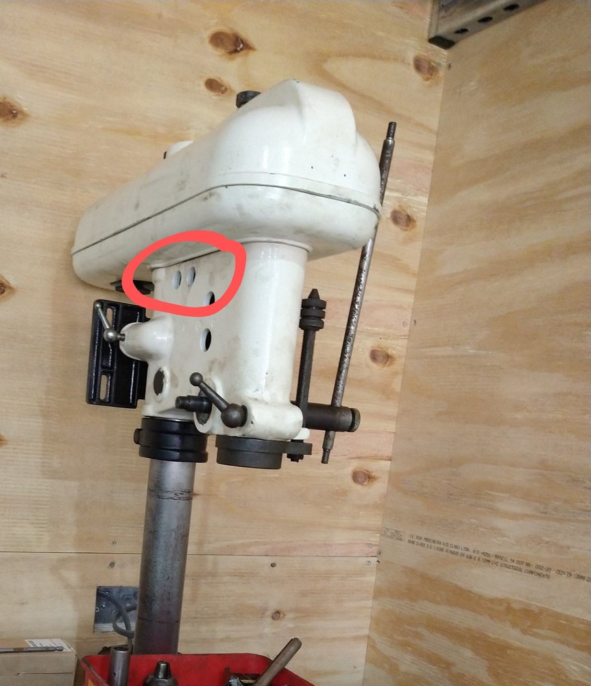

Thanks for the reply Pg11 is too smallIt may be a PG11 gland?

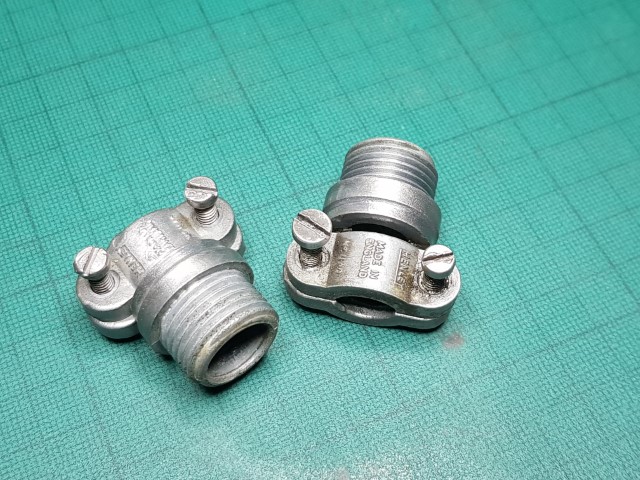

That would be great thank youI might have a couple of old die cast ones that will fit. I will have a look at home after work, remind me if I forget.

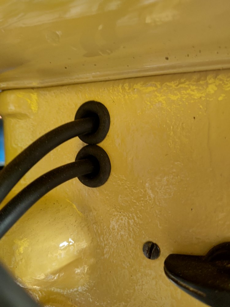

I think that mine is similar to this so hopefully not unique. Image from the lathes website. http://www.lathes.co.uk/fobco/img11.jpgIm not sure about the Universal but on the Stars it was just a rubber grommet.
That's interesting thank you et 3/4 looks like it might be the answerThey will be Imperial Conduit Thread considering the age and origin of the drill.

Thank you for the suggestionYou can no longer buy imperial glands. Either a s/h one as kindly offered above or use an adptor and a metric one.
Lewden PD1452A 3/4
Buy cheapest online Steel Galvanised Conduit Adaptor 3/42 imperal Male External Thread to 20mm Female metric Internal ECT (electric conduit thread)www.edwardes.co.uk
Another option is to make a 3/4-16 male (3/4 UNF would suffice) to M16 x 1.5 female adaptor but it will have very thin walls.
Thank you for the offer my holes are bigger unfortunately.The hole layout is different.
The diameter on my Fobco Star's (4 off) is 14mm with no thread.

yep just open the hole out and fit a 20mm if u mustOld 3/4 .. 19mm
more than likely 3/4 conduit thread being imperialThank you for the offer my holes are bigger unfortunately.
I agree you are right it is imperial 3/4 and I am thinking about if I can/want to change it to 20mm.yep just open the hole out and fit a 20mm if u must

Hello Pete,I might have a couple of old die cast ones that will fit. I will have a look at home after work, remind me if I forget.
