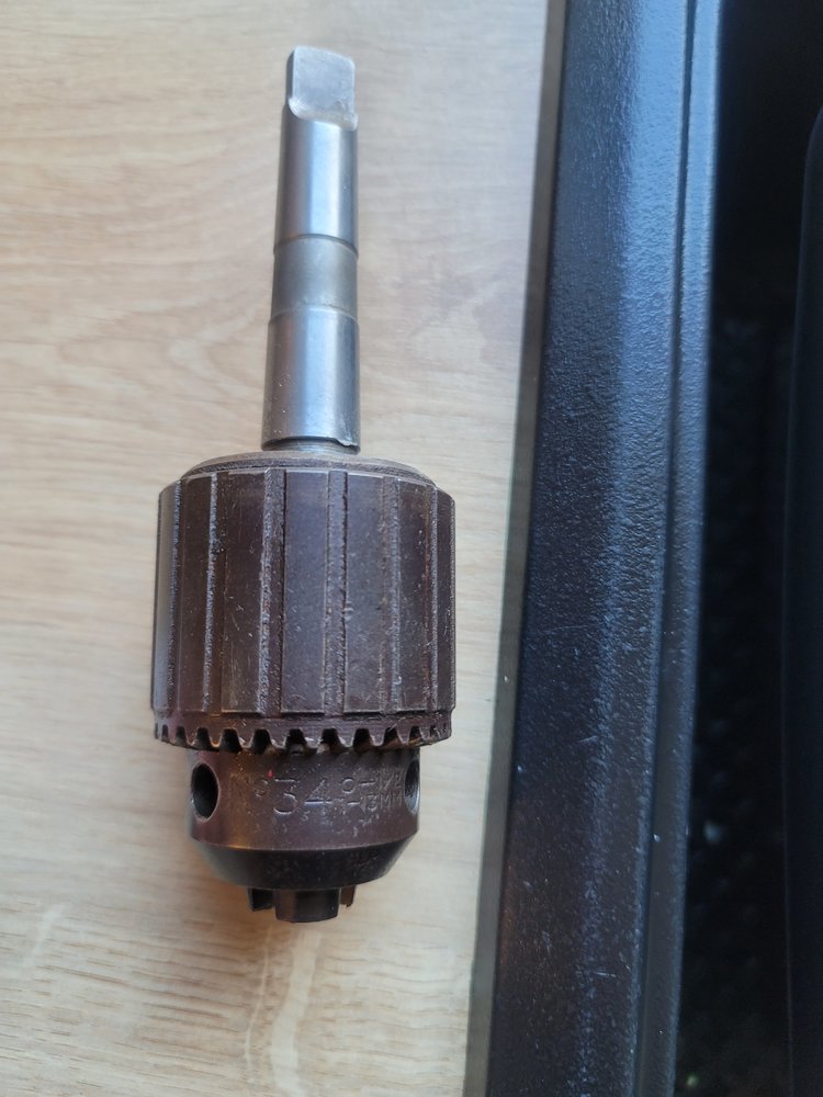

Hi folks, can anyone point me in the right direction?
I have a Fobco 7/8 pillar drill which I'm pretty sure is a 2MT. Yestereday the little flat tang bit at the end of the taper somehow snapped & the taper fell out, so I want to get a replacement.

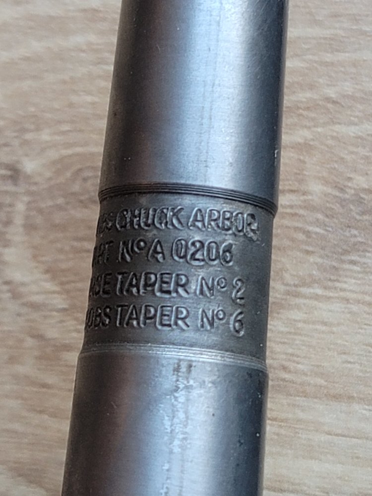

On the other end of the arbor is a Jacobs No.34 1/2" (1-13mm) keyed chuck, but I don't know what size of taper goes into the back of it, can anyone tell me? I did a little bit of Googleing and there seems to be multiple combinations of tapers, in my ignorance I assumed there'd be just 1 standard size.
Do I need any special gadgetry for getting the chuck off the arbor? Should I just buy a new all in one 2MT and chuck? Or should I stick with the 2 part system? Thanks
