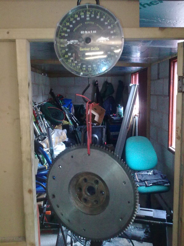

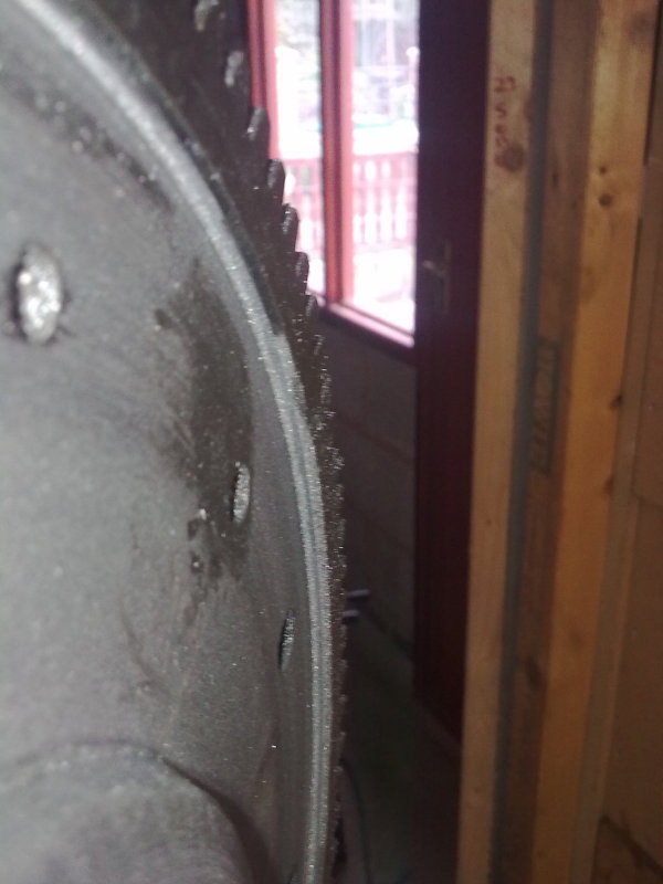

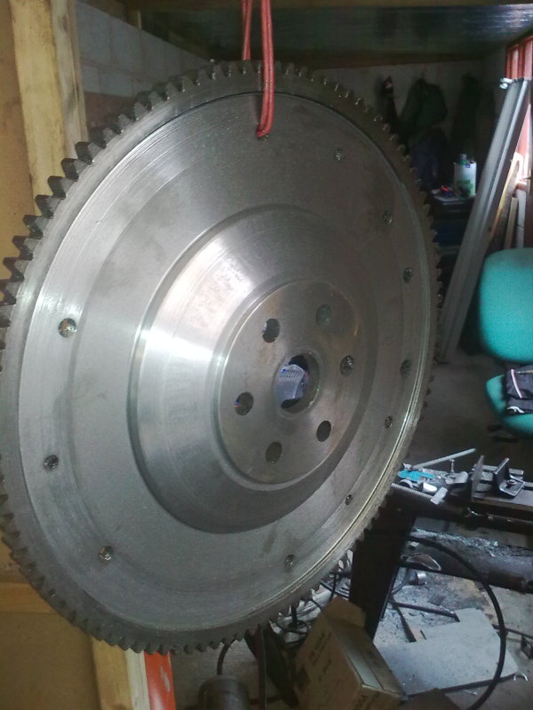

It's all steel EN24T - integral ring gear machined into the flywheel at fabrication stage
Designed to fit Lotus Carlton 3.6L Crank using an Audi S4 pressure plate and std Opel Monza friction disc - bit of a hybrid
PS when I can get them made for under £300 why bother to try and make them yourself
ah i got a bit mixed up i thought your flywheel was aluminium.
yes it is somewhat of a hybrid
