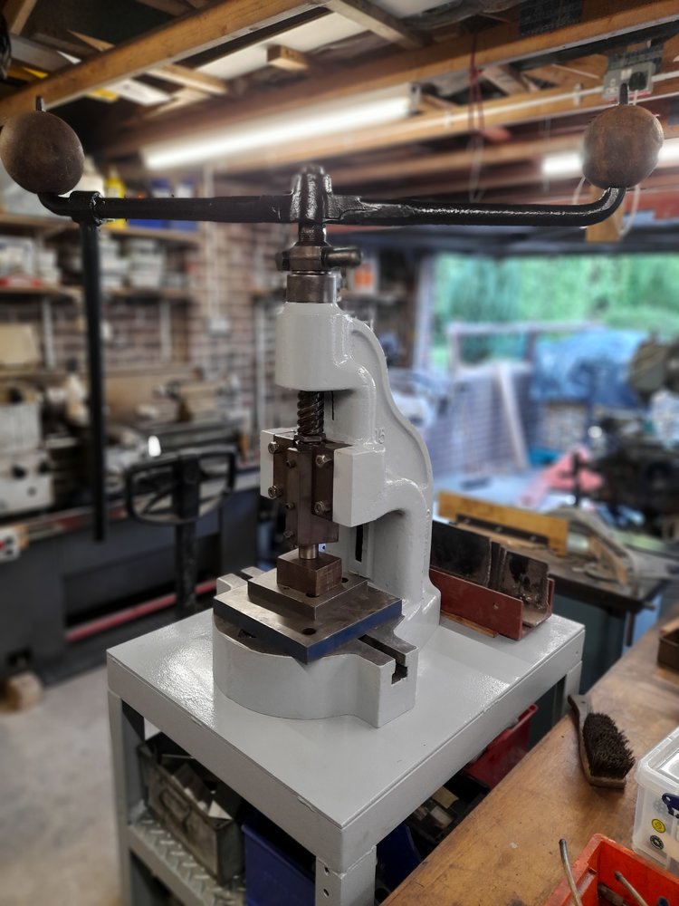

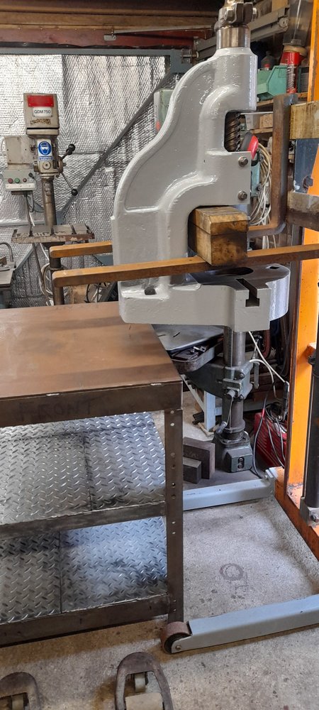

I'm upgrading from a tiny fly press to something larger (no. 5)

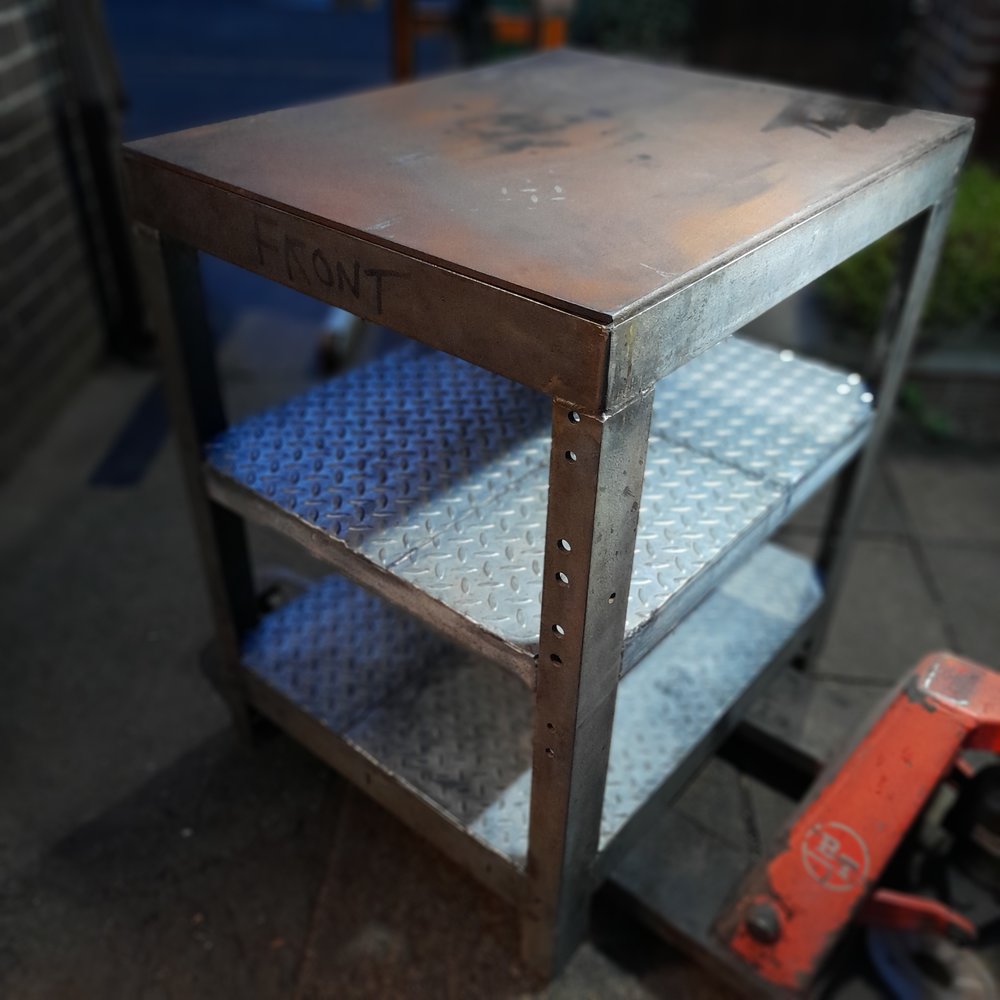

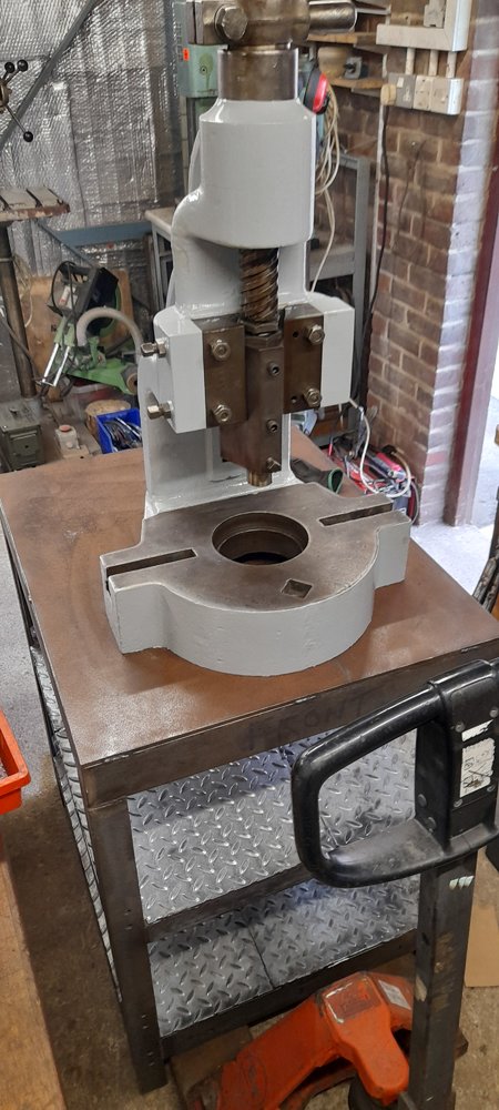

I've made the table from scrap and an old table I cut up. Total cost basically nothing apart from grinding discs and welding rods.
Before I tack the top down, can I just ask for opinions on whether it would be considered useful to include a hole below the fly press base. My smaller fly press is bolted to a wooden bench and I've never needed such a hole. It mostly gets used for folding sheet steel and assembly.
