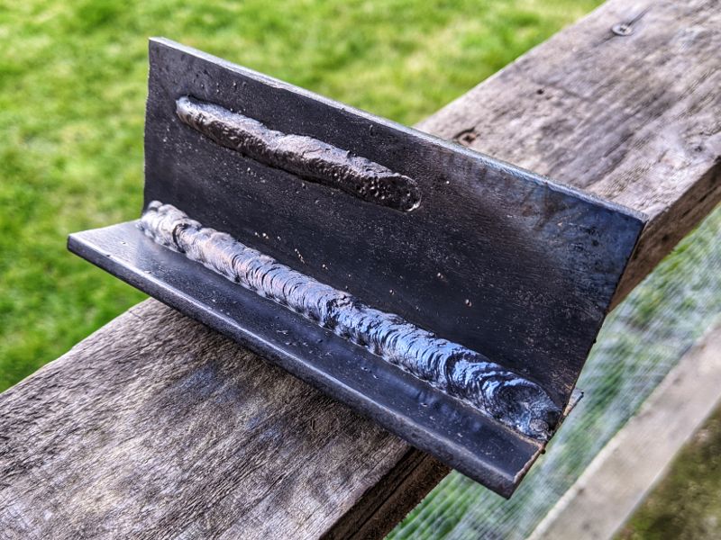

I've been playing around with the self-shield wire more at home recently, and the jobs I have in mind don't need to be aesthetically pleasing as they're more functional. Not that I could ever describe my welds as aesthetically pleasing, mind...

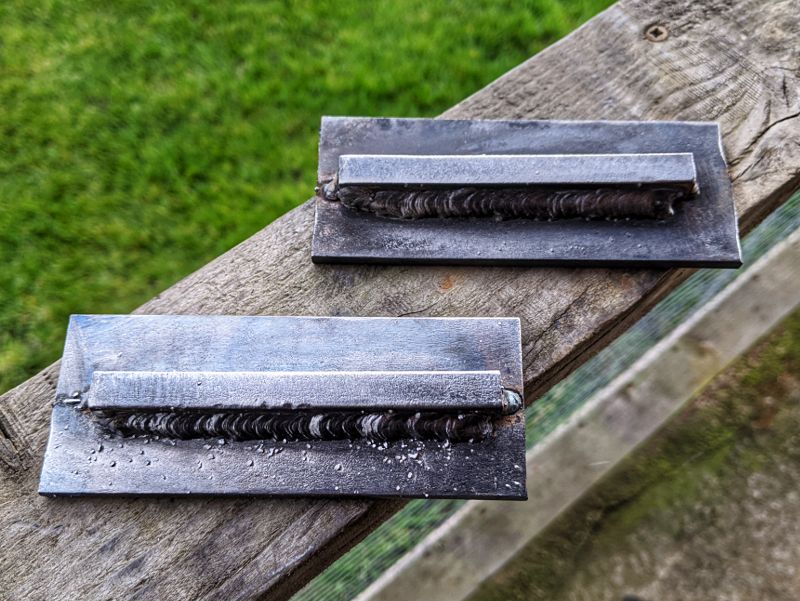

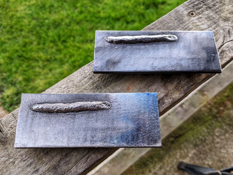

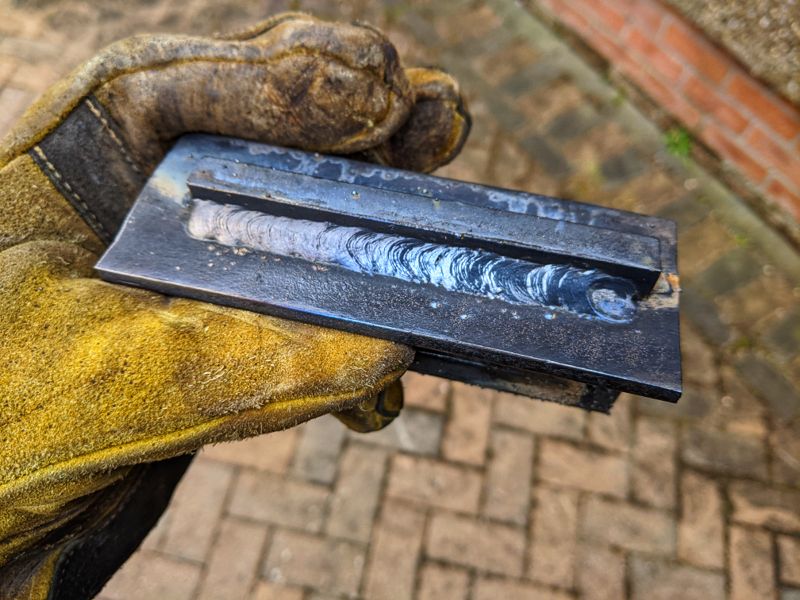

Thought I'd do a wee test to compare with and without the anti-spatter spray and the results pretty much speak for themselves, especially when it came to welding some 10mm square bar to some 5mm flat bar. Surfaces cleaned up with grinder, same settings on my Paton (18.5V, 6.5m/min) and wire is EWM FCW 71T. Surfaces cleaned up after with wire brush on angle grinder.
Would be delighted to get any feedback on my welding...
