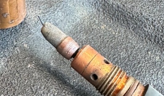

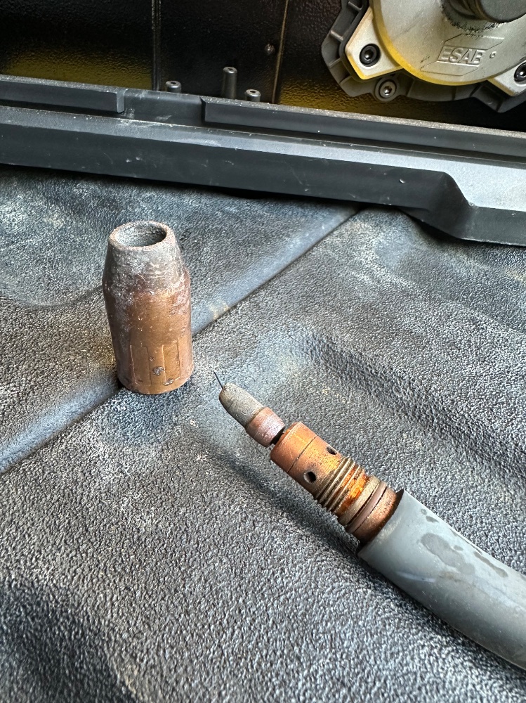

The pix looks like the contact tip is not aligned with the rest of the gun ?
Or loose from the socket.

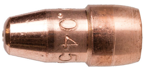

Perhaps I am just unimaginative - apparently so, here are the catalogue items.
