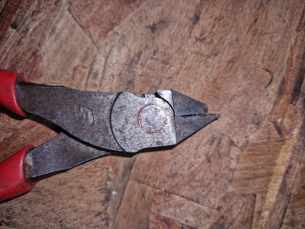

If you ding the blades, they're not particularly difficult to re sharpen.
Nip them closed and grind the back face on a fine stone on a bench grinder. Hold them up to the light and remove more material where they're touching until you get contact along the full length and you're back into clean material on the cutting edges.
You can do it on a linisher too but it's easier to manage the contact with the round face of a grinding stone and with it, the heat
